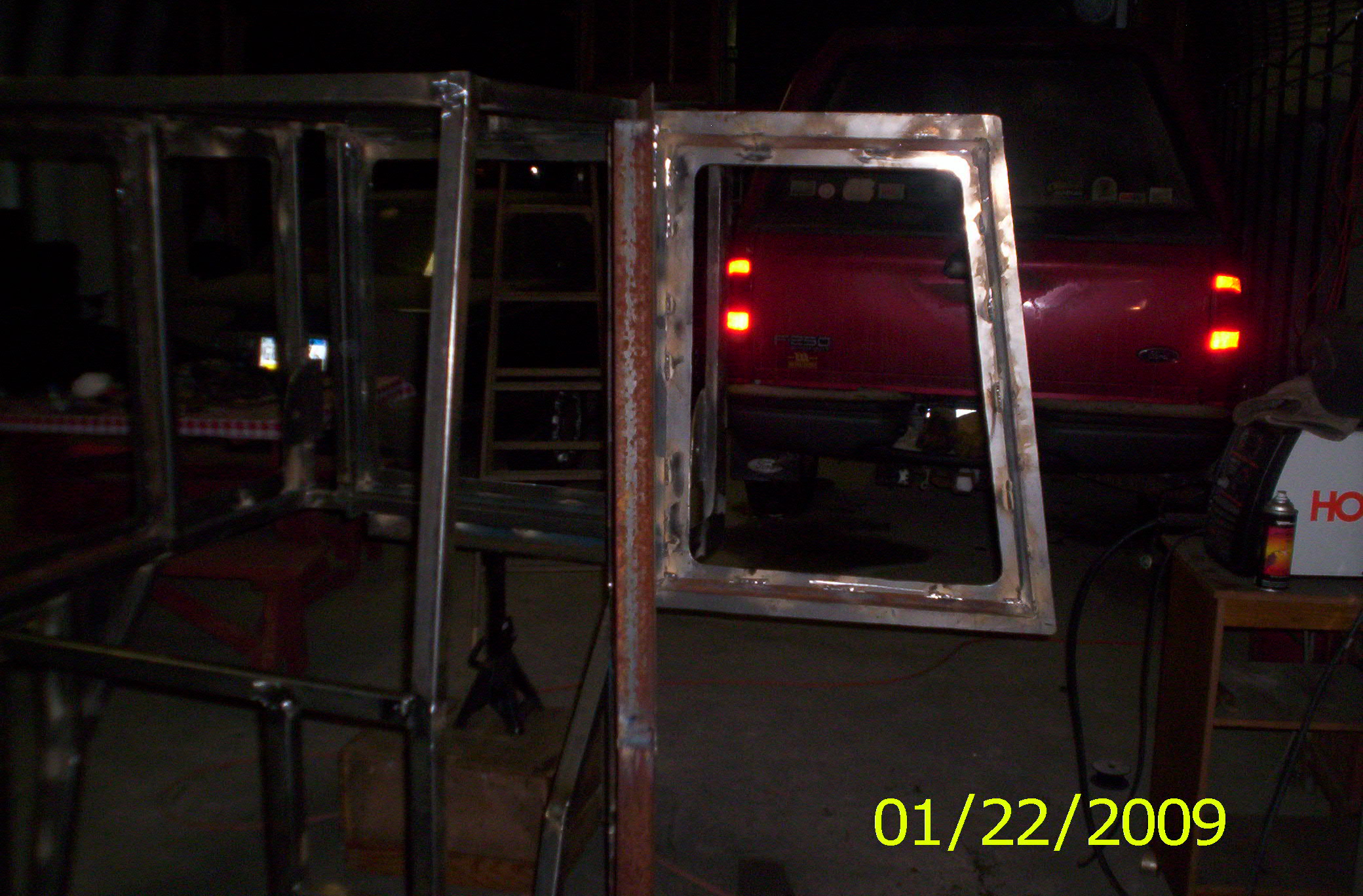

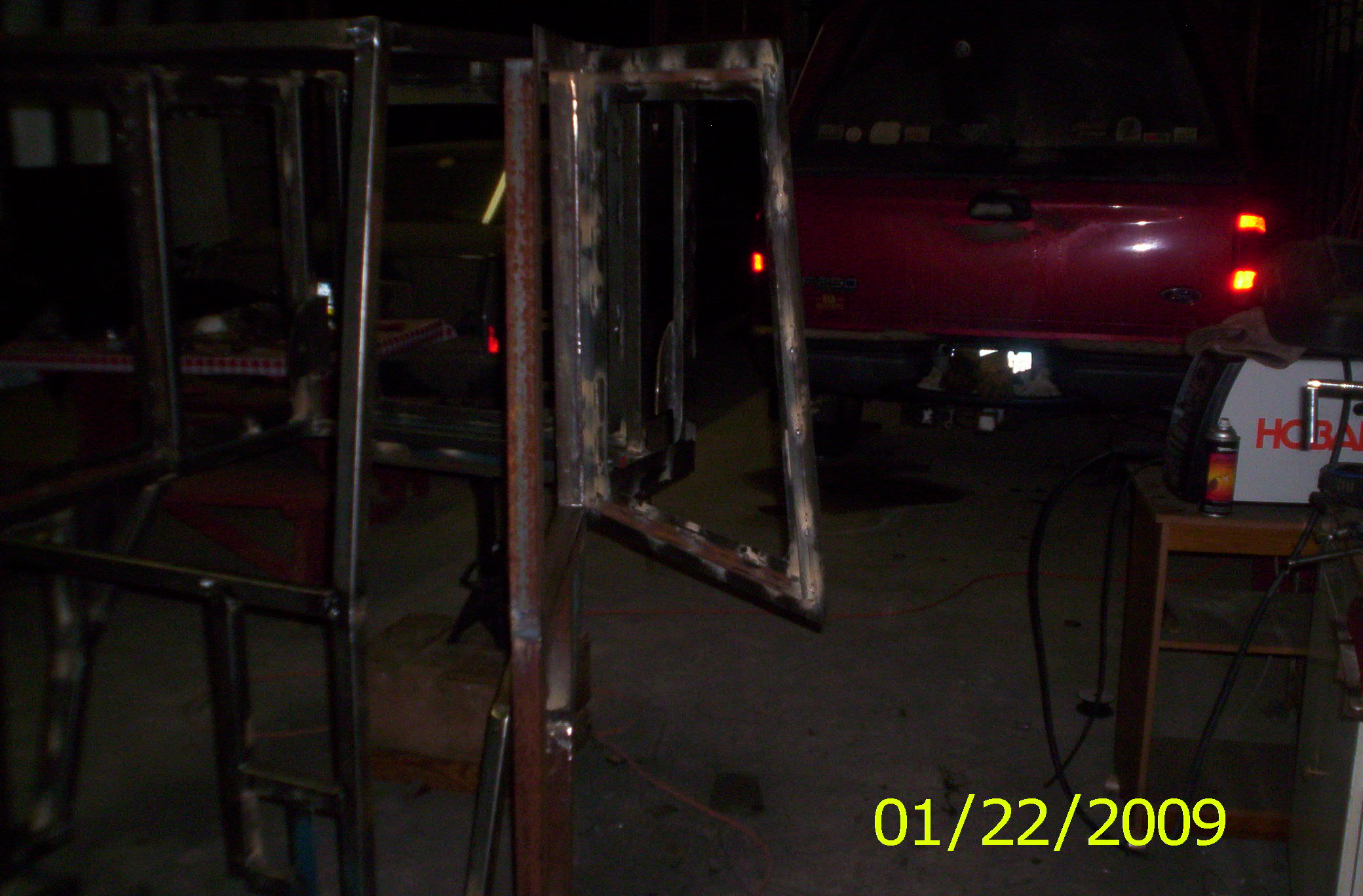

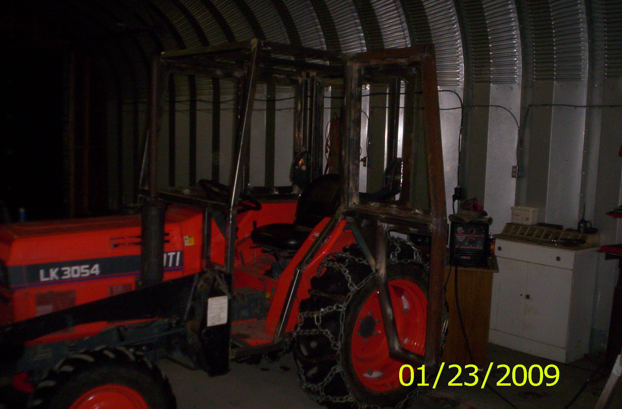

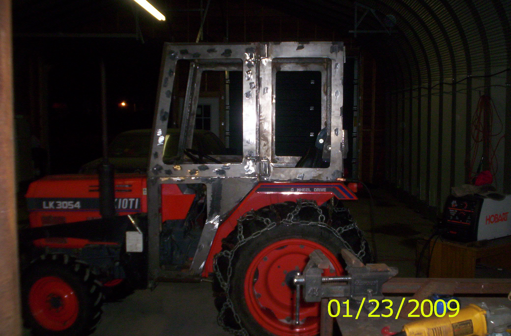

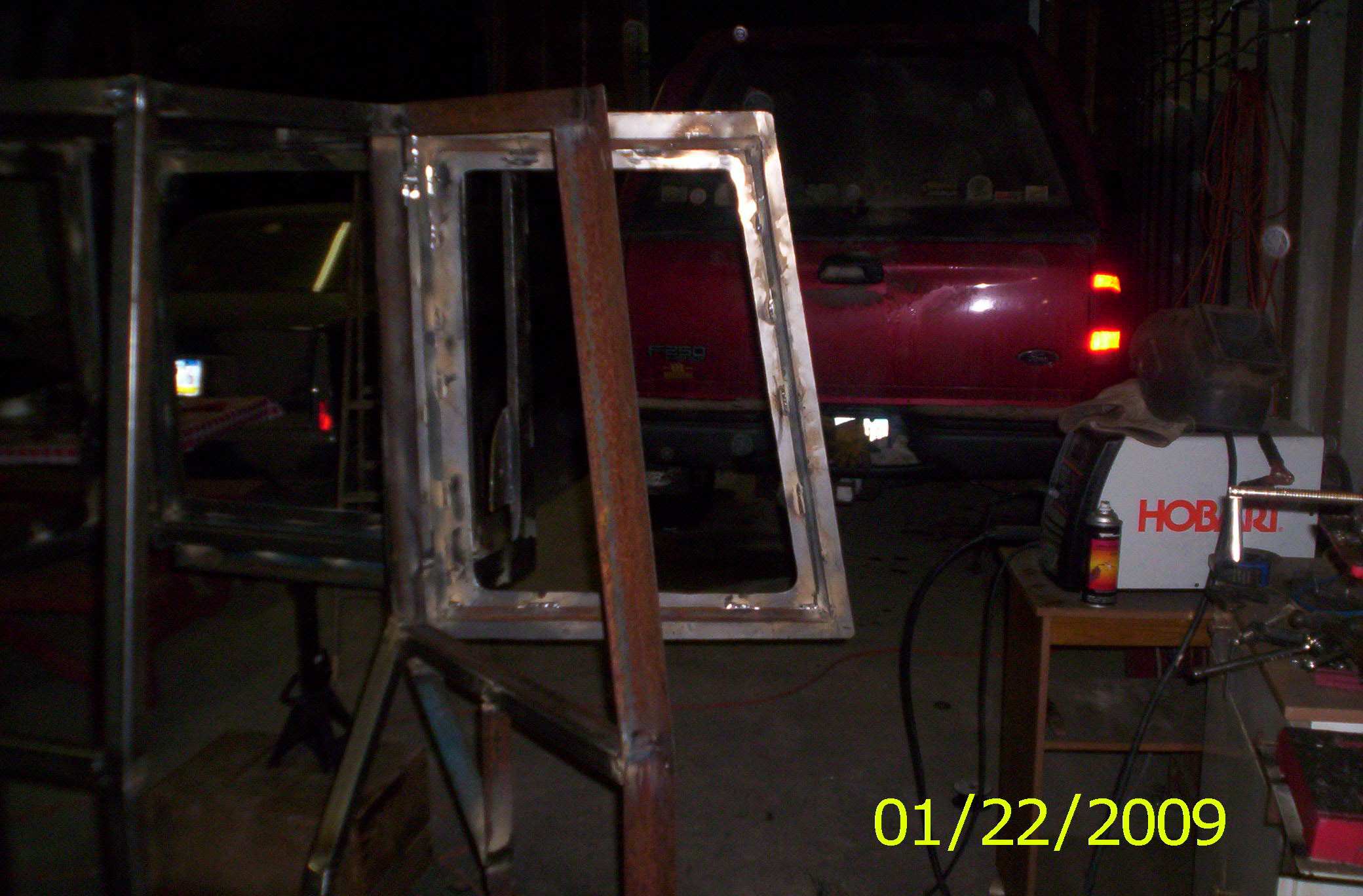

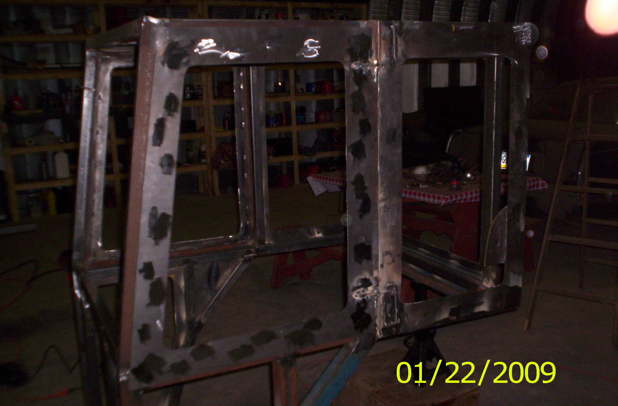

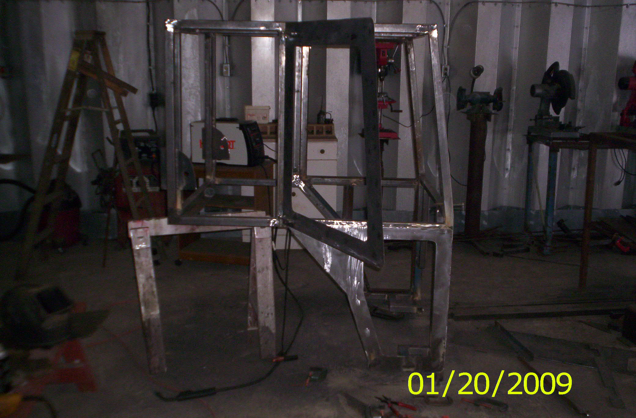

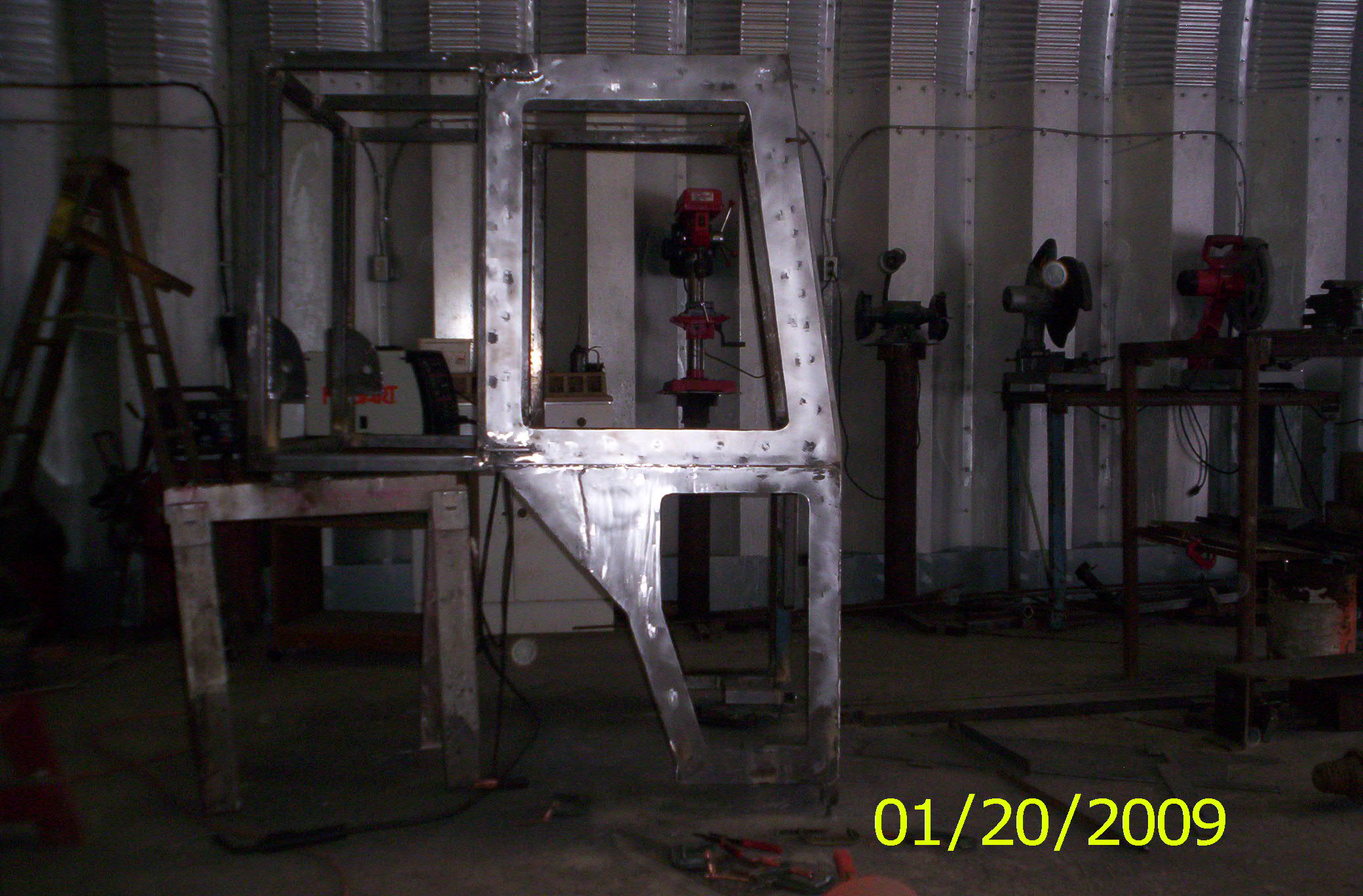

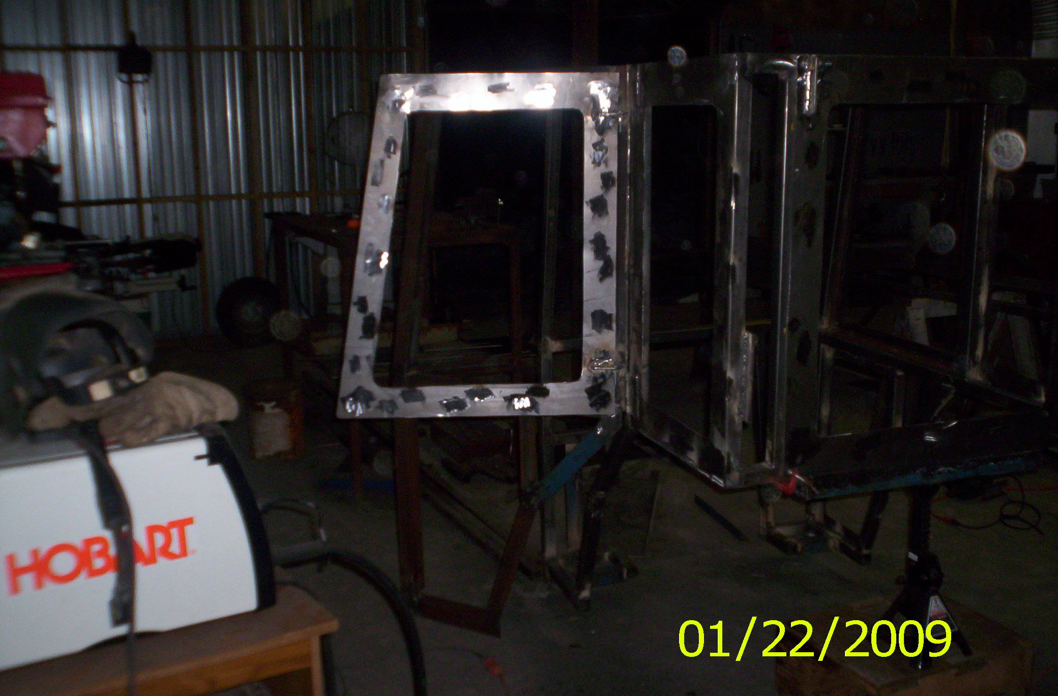

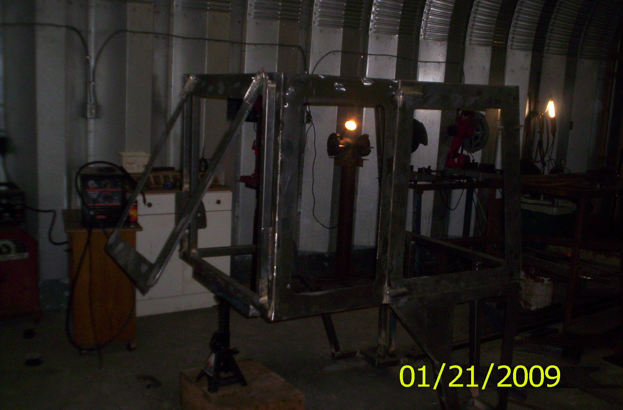

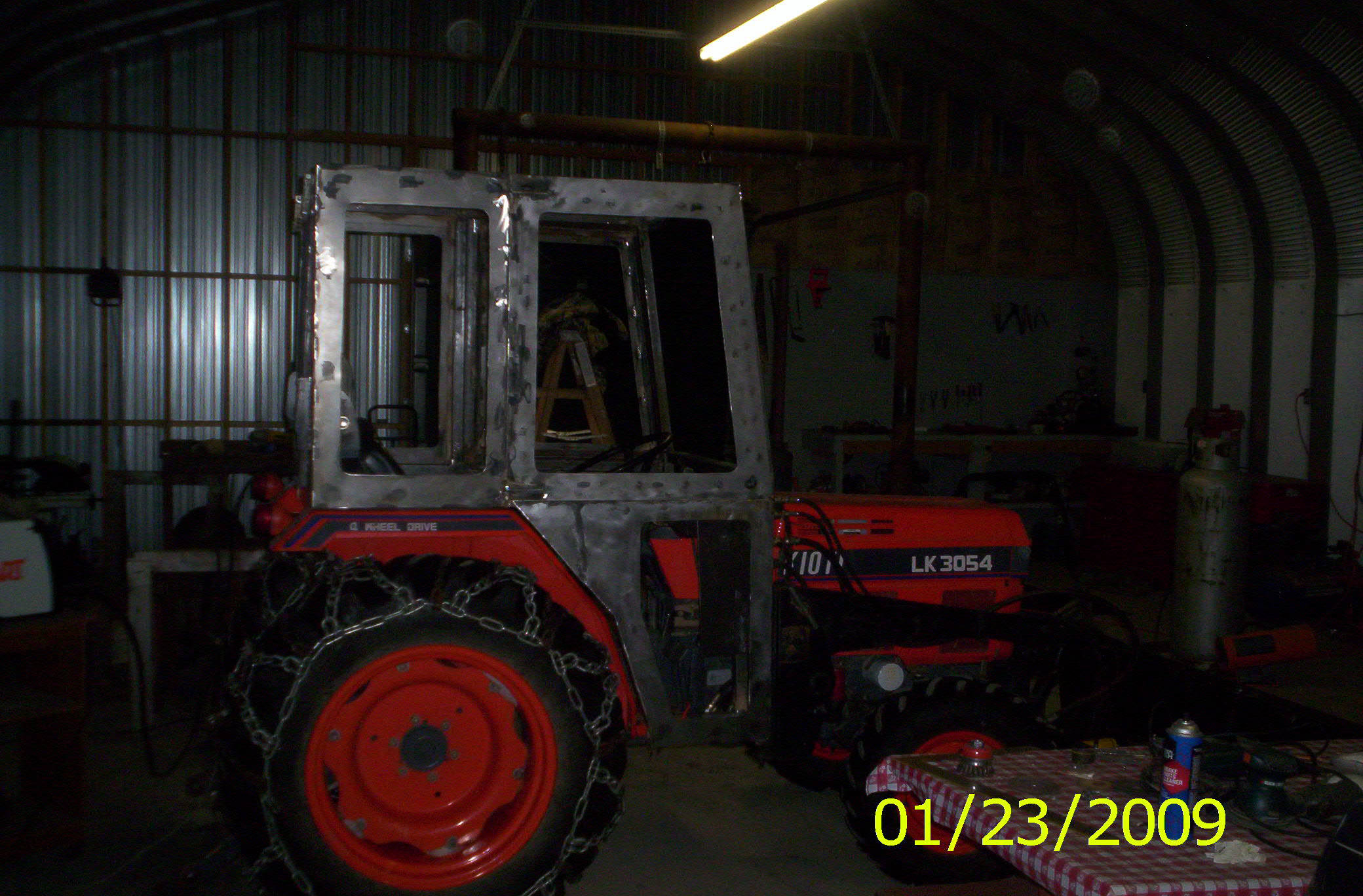

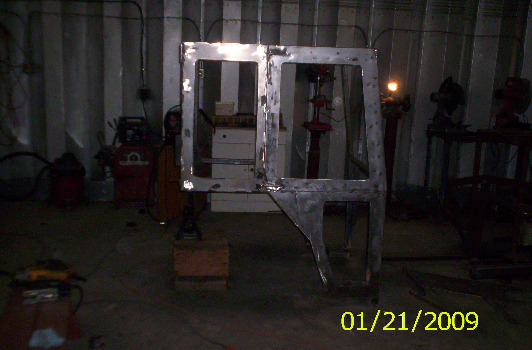

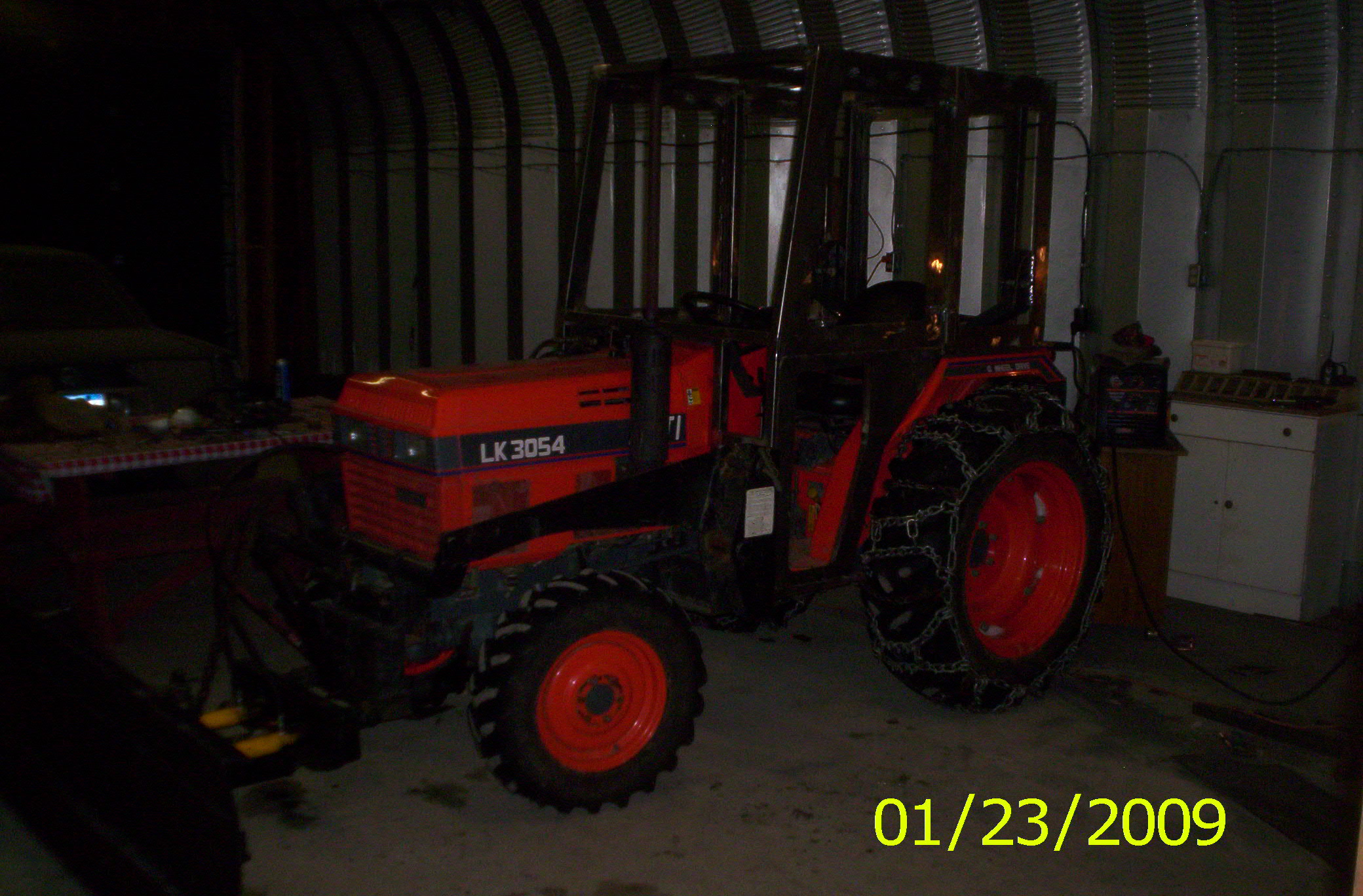

well here it is.
still needs glass,lights,wipers,headliner,heater

You did a great job!
Now once you get the rest done... Are you going to install AC for next summer. :D
Thanks for the update!... and it looks great!
Keep posting pics when you can.

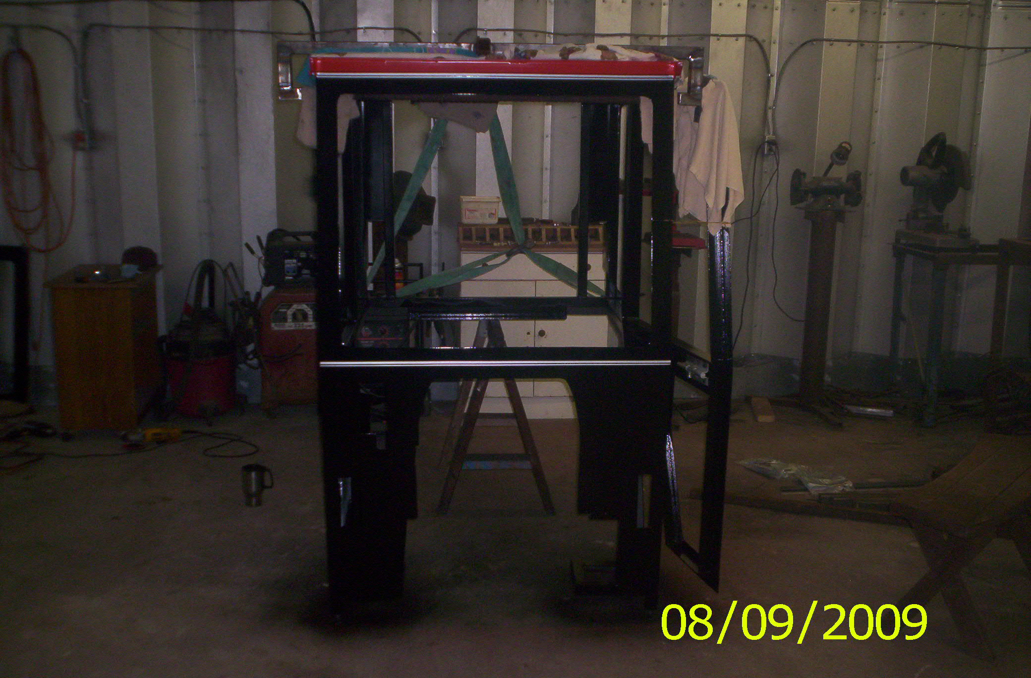

a little update note. took my tractor to the glass guy last night he wiil be installing the glass this week. total cost will be $647.00 - 1/4" tempered on all windows. safety glass in front window.glass will be set in rubber gaskets. will post pictures when i get it back.
/ cab project #86
The glass is pricey; but less than I expected. I was guessing the cost would be over a grand. Can't wait to see how it looks.
/ cab project
#87
yes i to thought it would be at least a grand. he came out took measurements called with the price,i was very happy. it comes out to $81.00 a window. he did tell me when i called the first time to get a price on 1/4 tempered glass that it is $8.25 a square foot. cant wait to get my tractor back.
/ cab project
#88

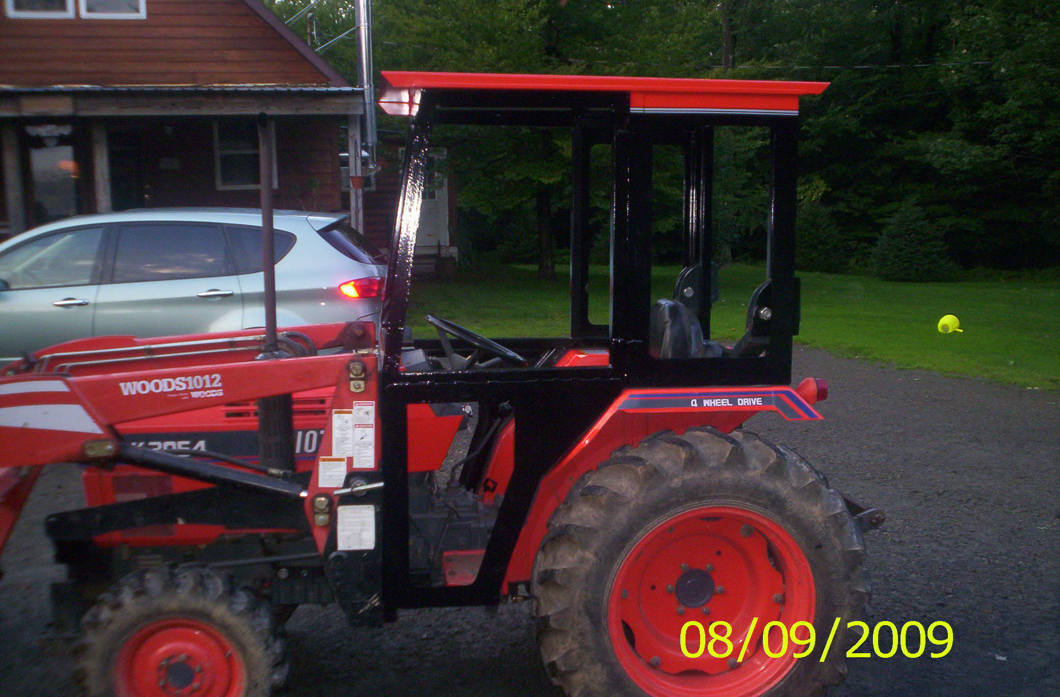

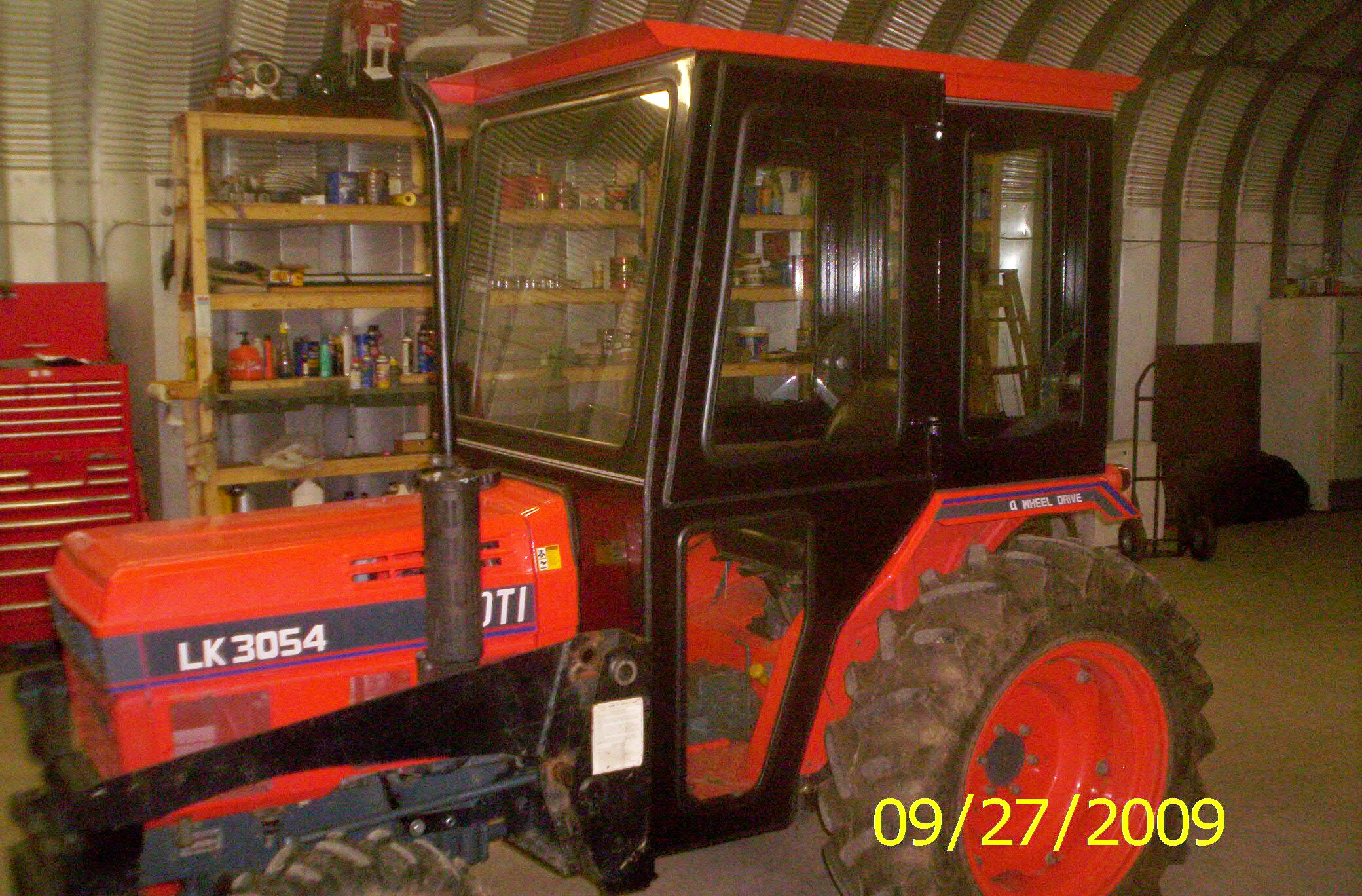

glass is in. a little advice when you make rounded corners cut no less than 3" radius corners. i had 2.5" corners it made it difficult to work the rubbers.

That looks great! Just in time for winter. I can't get your pictures to blow up very well but I like what I can see. Richard
/ cab project #91
WOW! super nice! looks factory too. I am sure you gonna enjoy it in the winter time!:D
/ cab project #92
Very nice job Dirtnut! It looks factory.I like how you did the roof with insulation,that is a must.Are you going to add a radio/heater and finish the inside or just leave it as is...Ive wanted to put a cab on the old 1910 for years now,with winter (my slow season)approaching,you got my wheels turning.;)

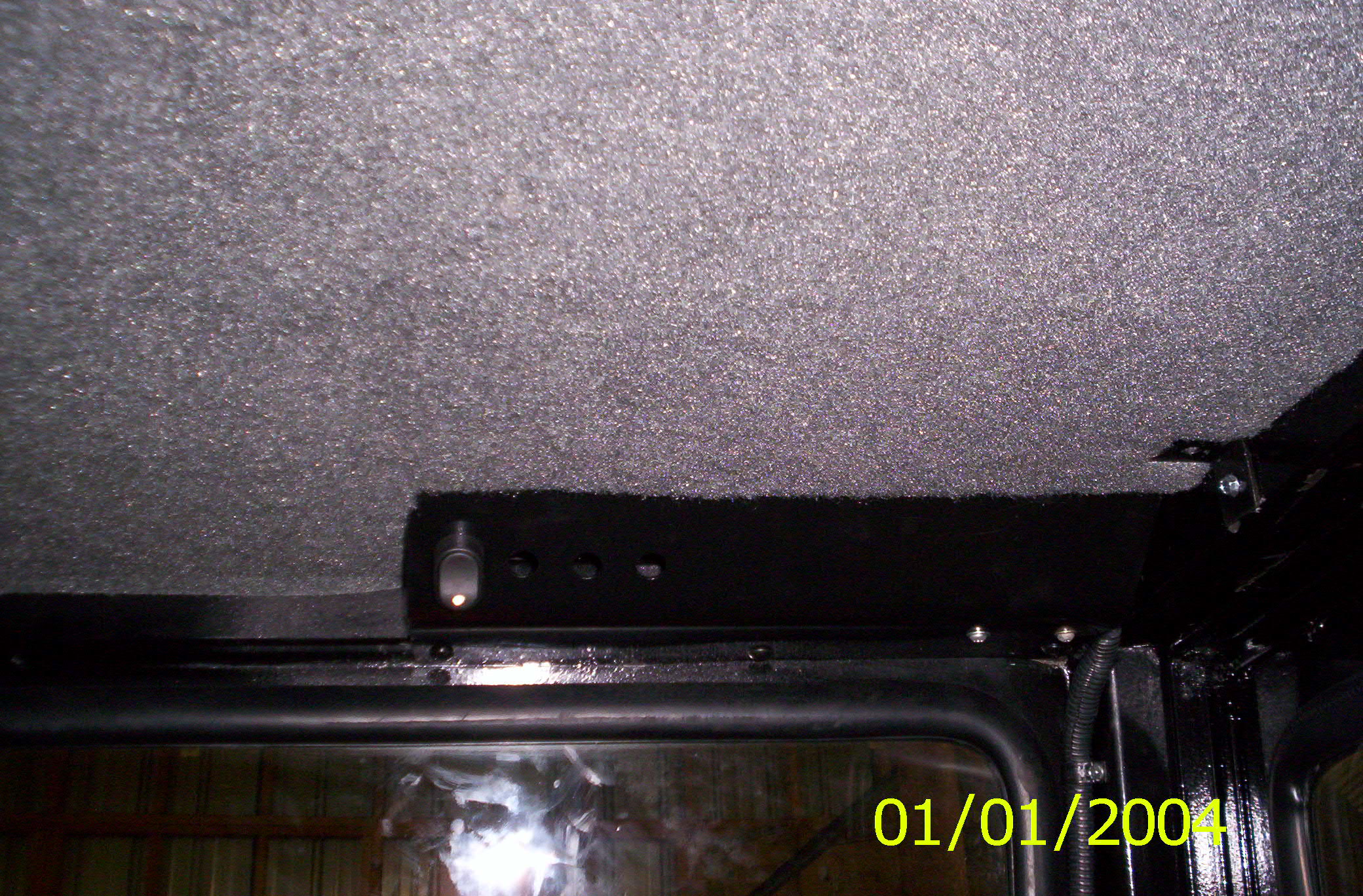

#97
more progress. - interior,lights,flashers,switches(still waiting on the rest of the switches)

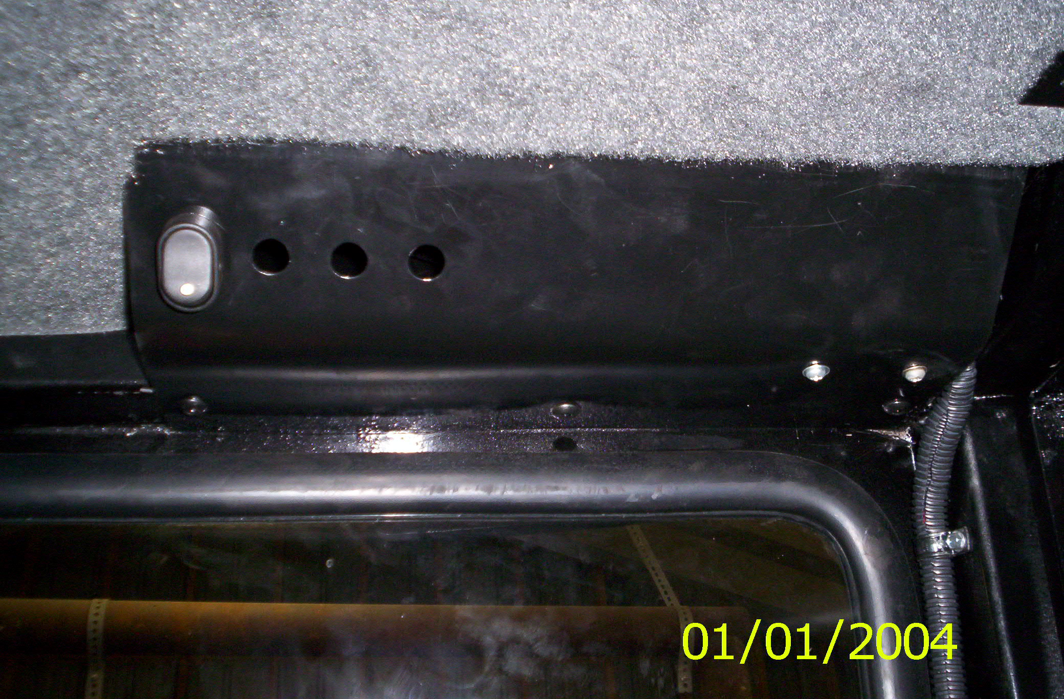

thanks for the kind words i am very happy how the cab turned out. i got a few more things done today. put the switches in for the lights and wipers still need to order the wiper motors. i did order the heater today(since it seems winter is here).also added a fan today. little by little i am finishing things up & thinking new things up. need to do window latches,window shocks & install heater when it gets here hopefully middle of next week.
