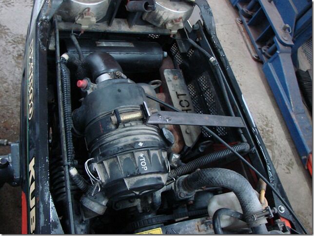

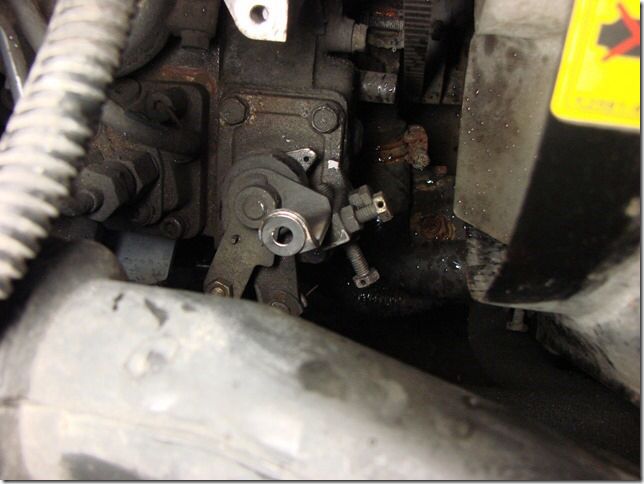

Well today my customer brought in the BX 1800 I converted to a nice resurfacer a few years ago. This BX has a little over 3000 hours on it. It had the usual air filter bracket cracked so I did a little mod on it and added an extra brace to it.

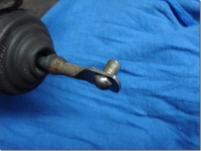

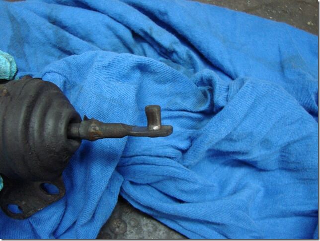

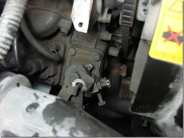

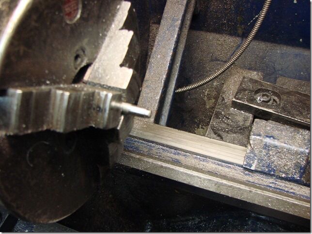

It also had a situation where it wouldn't shut off with the key. When I checked that out I found the solonide let go from the bracket on the injection pump. I did a fast repair on it buy machining a small stainless steel shaft to weld on the solonide. Then I silver soldered a washer on the bracket so that everything will fit good and not slip out.

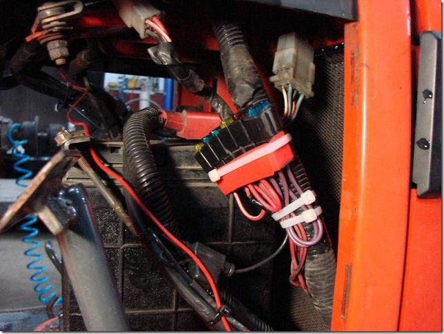

Had to make a wiring repair because the fuel pump was cutting out.
When he's done with it in the spring I'll get it back and do a more permanent repair to it.
Here's a few photos.

Yes the infamous BX air cleaner bracket...
First time I heard the rattle I thought the worst and was relieved to find it was only the bracket had let go...
