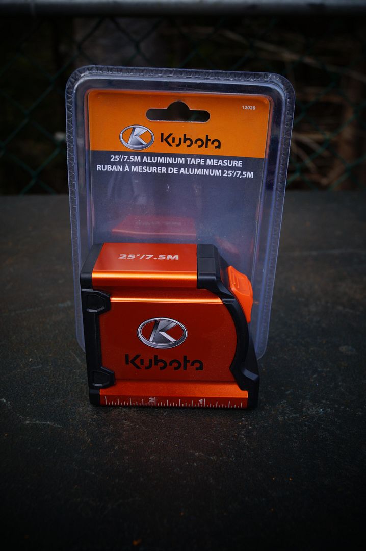

Hey, I like that ! Yikes..... I can just imagine what a replacement filter would cost at my local Kubota dealer.......:confused2:
Well the vac was $100. so you know a genuine Kubota filter will be $150. Lol. It's a great vacuum though.
I doubt Kubota actually made the vacuum. My guess would be that another company is the manufacturer and has made it to Kubota specs and authorized to use their name. There is likely filters that will fit it available from other places than a Kubota dealer. I might not be right in my thinking, and my wife often tries to convince me I am not always right, but sometimes I get a little deaf while she is speaking!

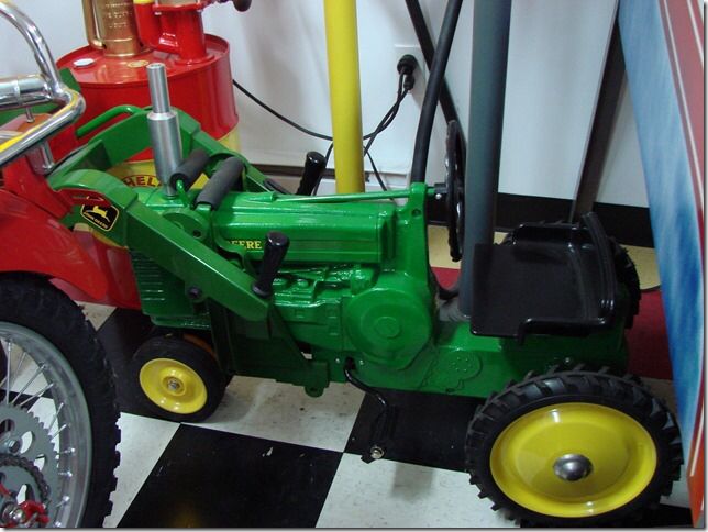

I never saw the vacuums on their web site. Are there other products made by/for Kubota? John Deere seems to be the most seen tractor name in the toy department, but you do occasionally see a few Kubota tractors. Maybe I just haven't found the proper place to shop for these things.
Kubota is getting their name out there much like Deere and Harley by selling this sort of stuff.
