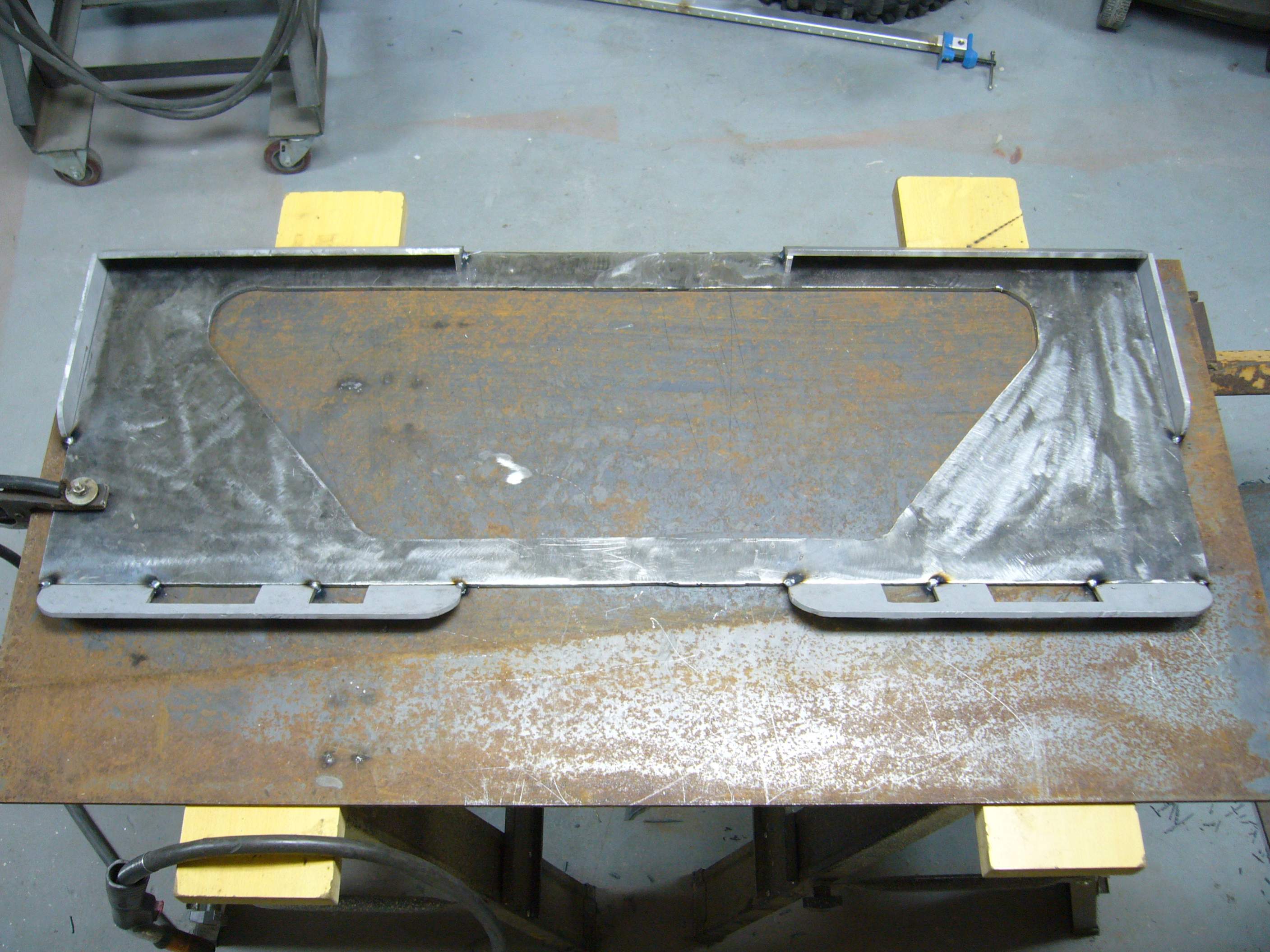

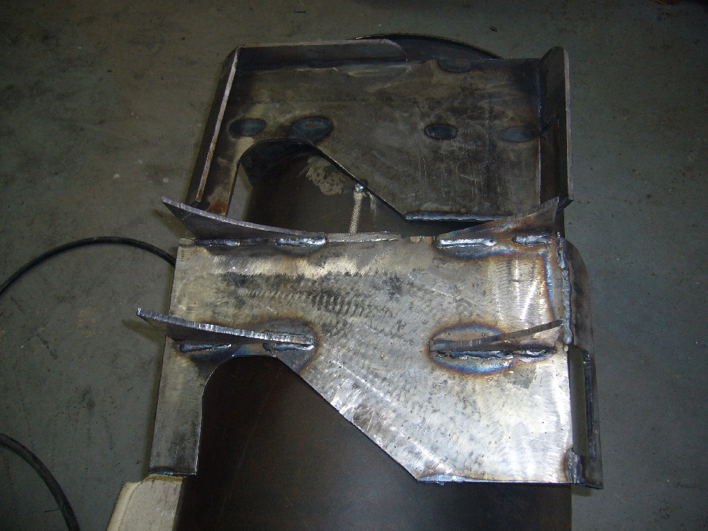

So I started out by first building the adapter plate that would go on the bucket. I figured this would help get my dimensions, alignment, etc. down when building the tractor side. It took some deciphering of the specifications, looking at lots of pictures and other builds here on TBN but this is what I ended up with:
All the parts cut out of 1/4 plate using my plasma with a straight edge and drag tip. Corners cut using a piece of pipe as a guide. I bought a bunch of it cheap off Craigslist and the original bucket brackets are made from 1/4 so that is what I used.
Here it is tacked up on my 'work bench', I had the bottom angle wrong but luckily I caught it before getting too far and was able to knock it off and weld on at the proper angle.
I thought it turned out pretty good... but it weighed in at 40 lbs, too heavy! But it would work to help me set up the tractor adapter.

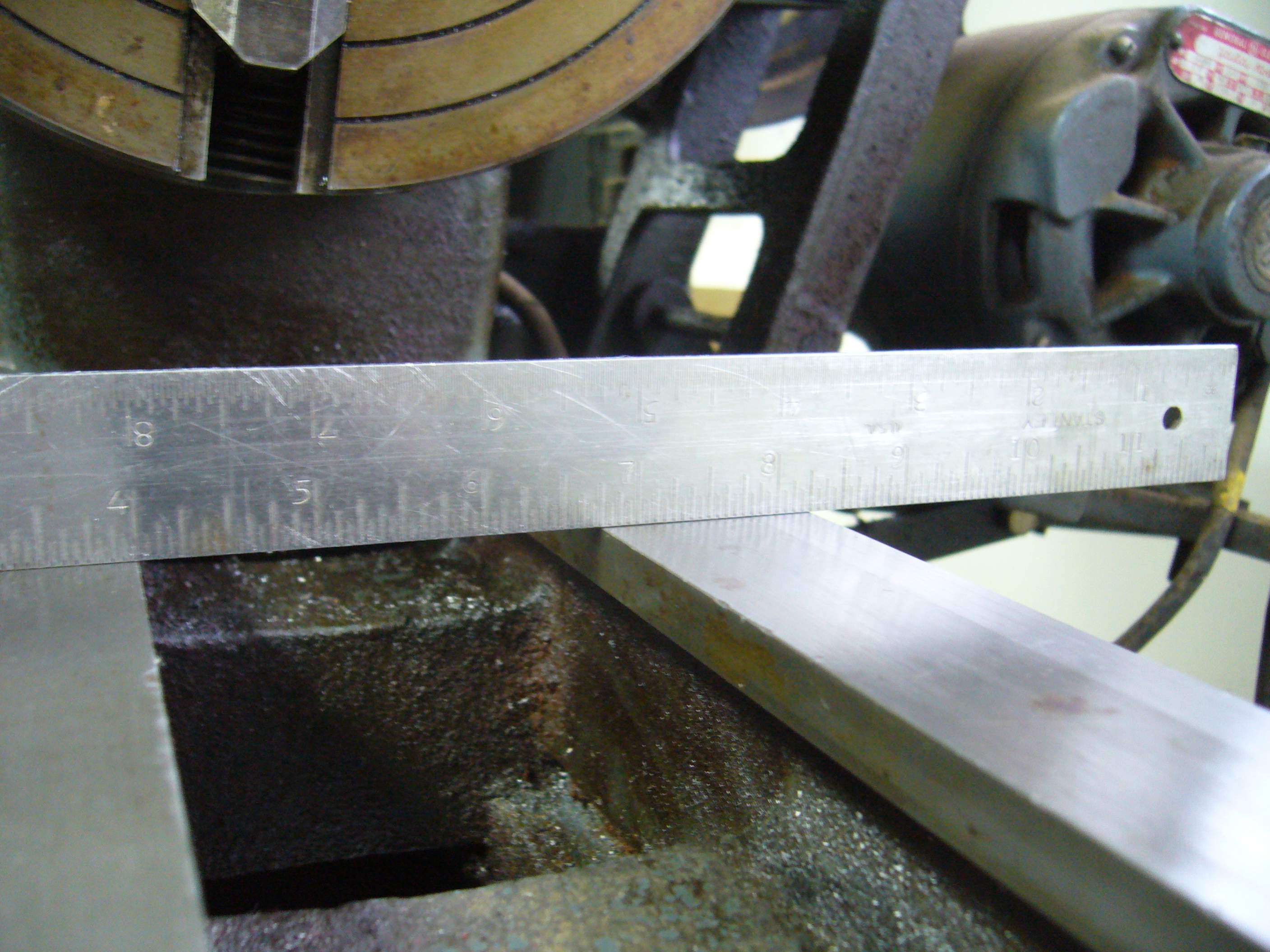

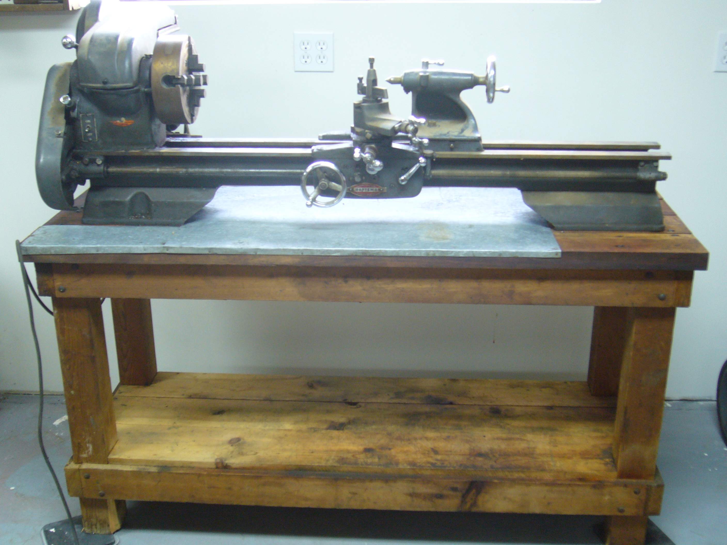

Then just before Thanksgiving an old Atlas/Craftsman 101.04703 12x36 lathe showed up on Craigslist about 2 hours north. Machine tools don't often show up in this part of the country much less inexpensive ones unless they are from HF. The guy was asking way too much ($1500) but I figured while everyone else was laughing I could be negotiating so I sent him an email and we started a conversation. I did some research found out better pricing, explained it all to him and we agreed on a price of $425 for the lathe with almost no tooling. This is still a little high compared to other parts of the country for this lathe but I was willing to pay it, depending on condition, as it might be years before another inexpensive lathe showed up.
Naturally it snowed all the night before and all day on the day I was scheduled to pick it up. Made for a long drive up and back on nasty roads but at least there wasn't much traffic :)
My research had showed this was a 'hobby' level lathe but using a lathe is something I always wanted to learn and this was a cheap way to get some experience. It would also work perfect to make a few parts here and there for 'tractor builds'. Turning pins, making weld-on threaded studs etc etc. This guys Uncle had bought it when new and used it in his shop. The guy I got it from had if for about 20 years, the last 10 of which it just sat and collected dust.
Here is the lathe in its new home in my shop:
The ways were pretty much perfect even though the whole thing was very dirty. When this lathe was used a lot of that time was turning wood.

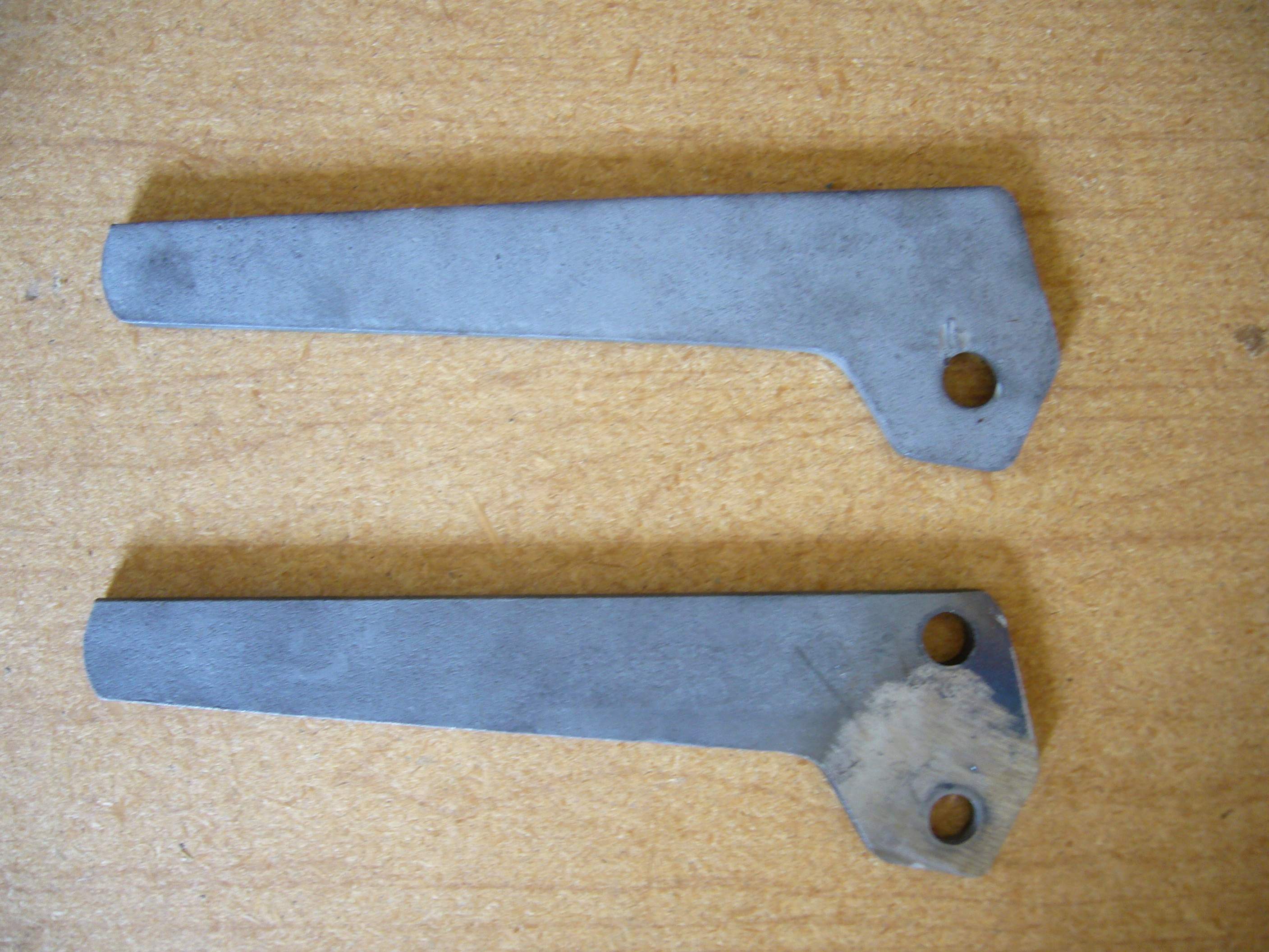

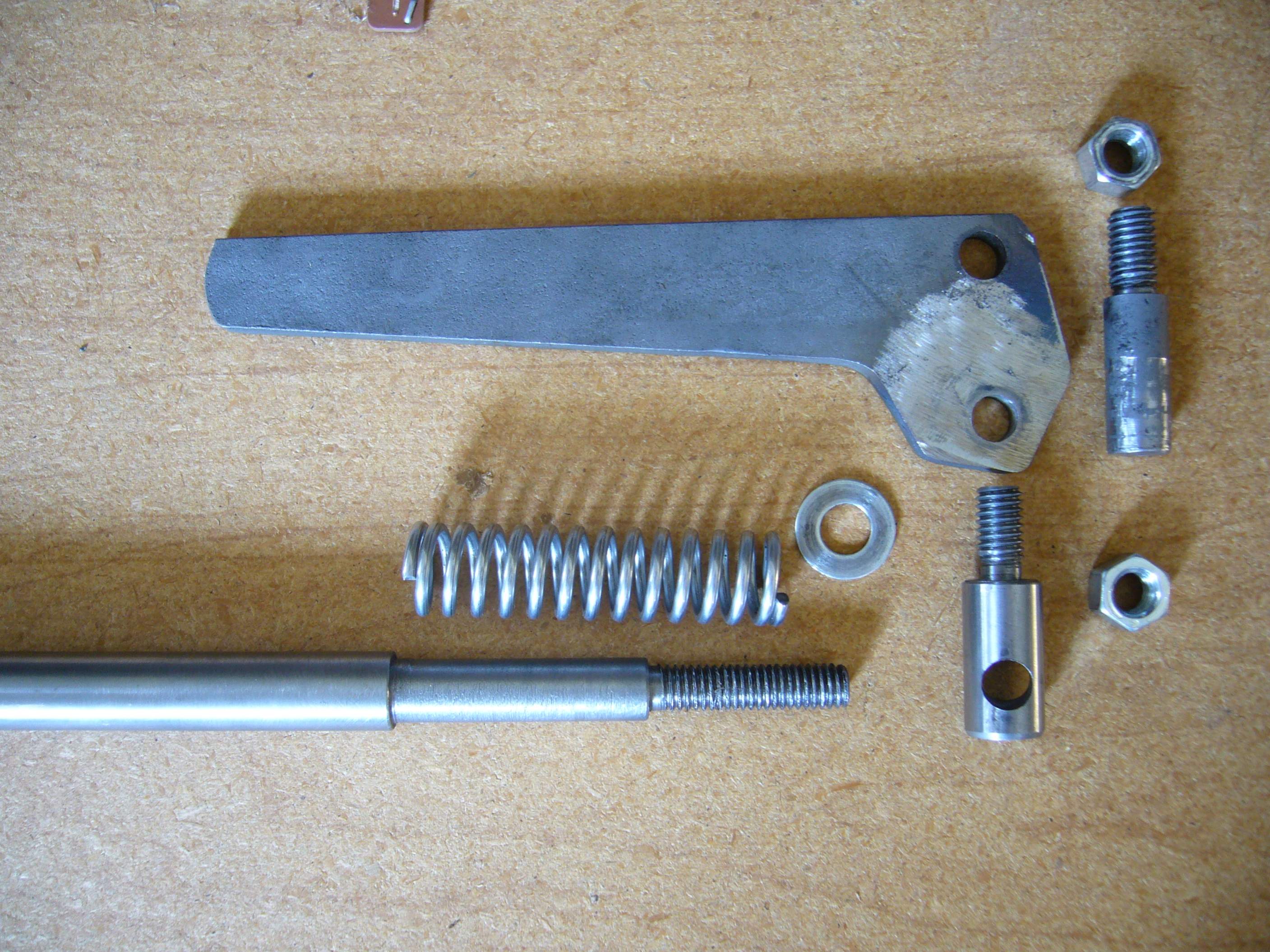

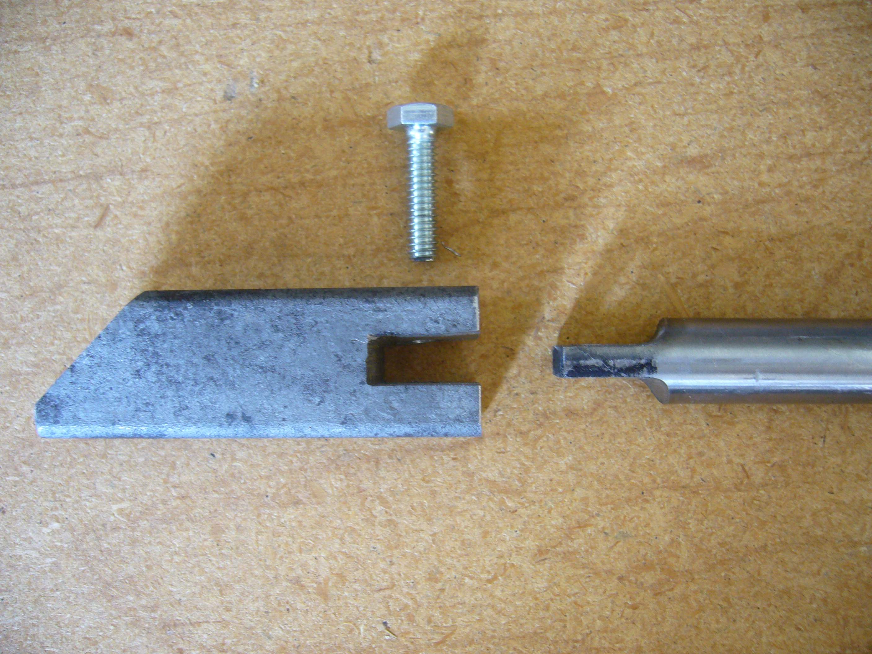

So with a new toy... er tool! in the shop I started to make the locking parts. I picked up some 5/8 cold rolled for the long locking shaft and sliding stud, used some old, rusted up 1/2 I had laying around for the weld-on stud. The handle came from an old disk I used to make a row hipper, they were used to actuate the disk scrapers. I had to relocate the existing hole and add a new one to get the action I wanted.
Here is the top end. the shaft at the bottom is my first attempt at threading on a lathe... and actually the second thing I turned! Ugly but it works, the other pieces turned out a little nicer. Turns out I really didn't need that much thread anyway, the more you compress the spring the 'looser' it makes the handle:
Bottom end, shaft ground down with a bench grinder. The locking pin is made from 1" square stock I had left over from the disk. I drilled through the 'top' and threaded the 'bottom' for the bolt. The shaft can 'wiggle' on the bolt:
'Before and After' of the locking handles:

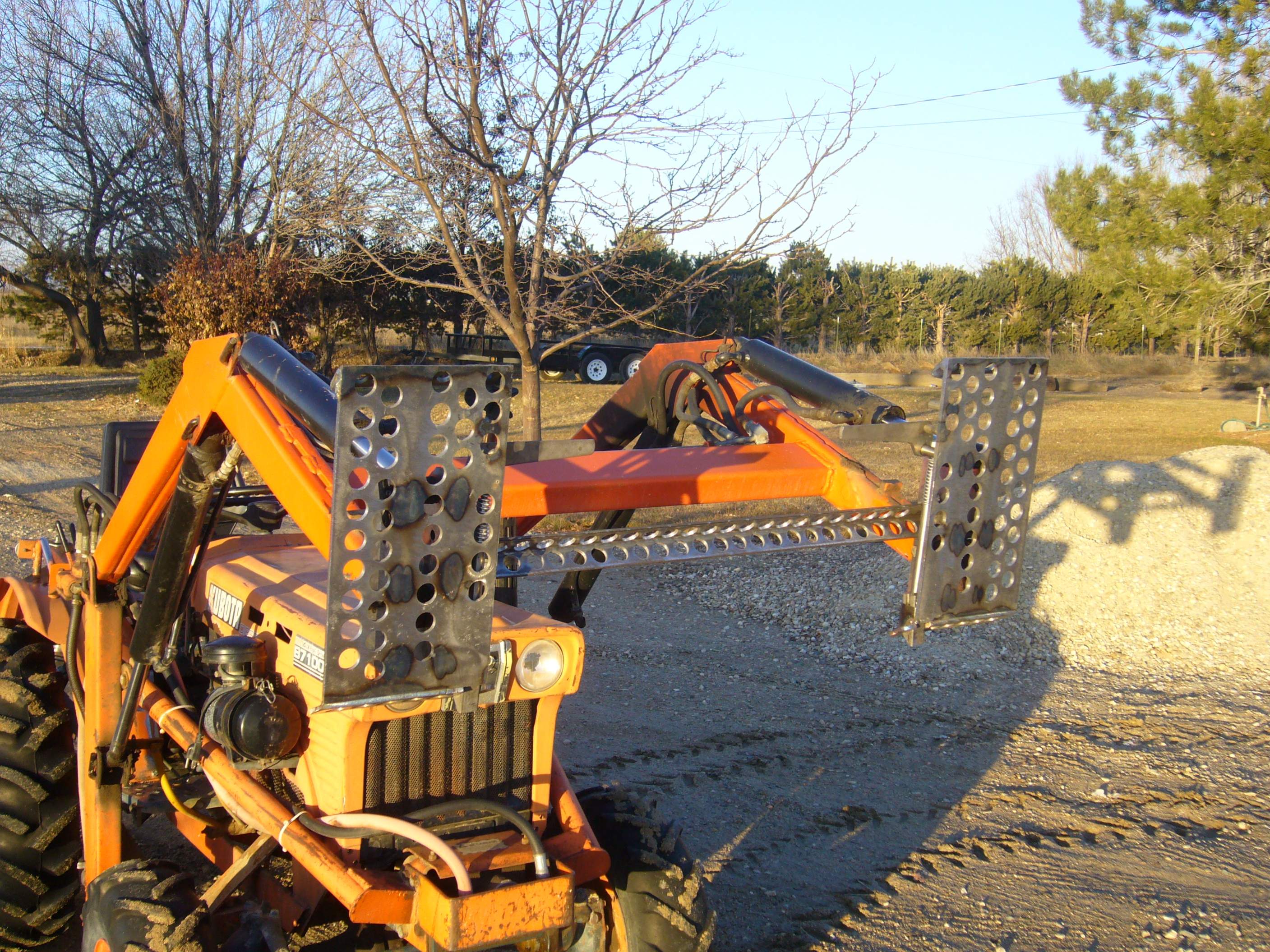

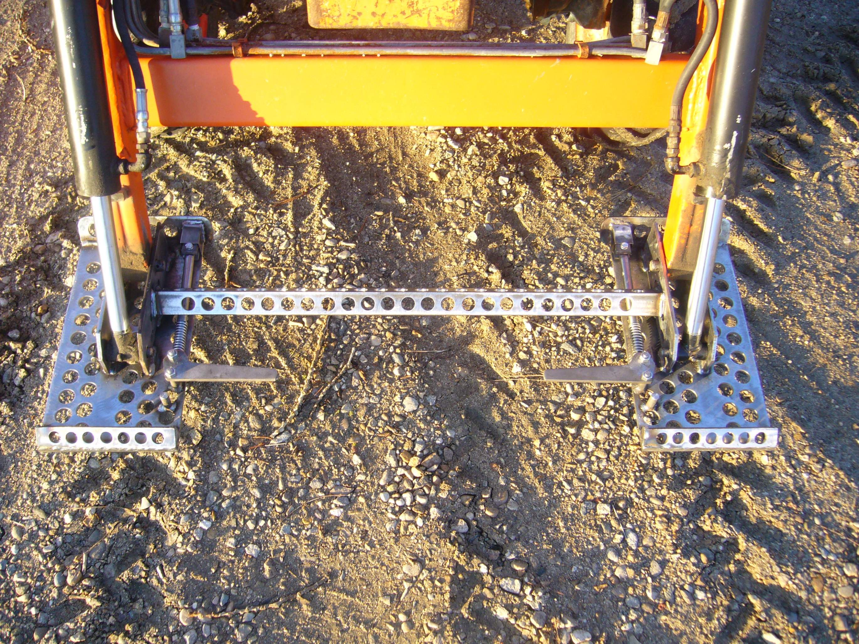

This post gets me caught up to where I currently am, needing to figure out how to put the attachment points on the round back bucket.

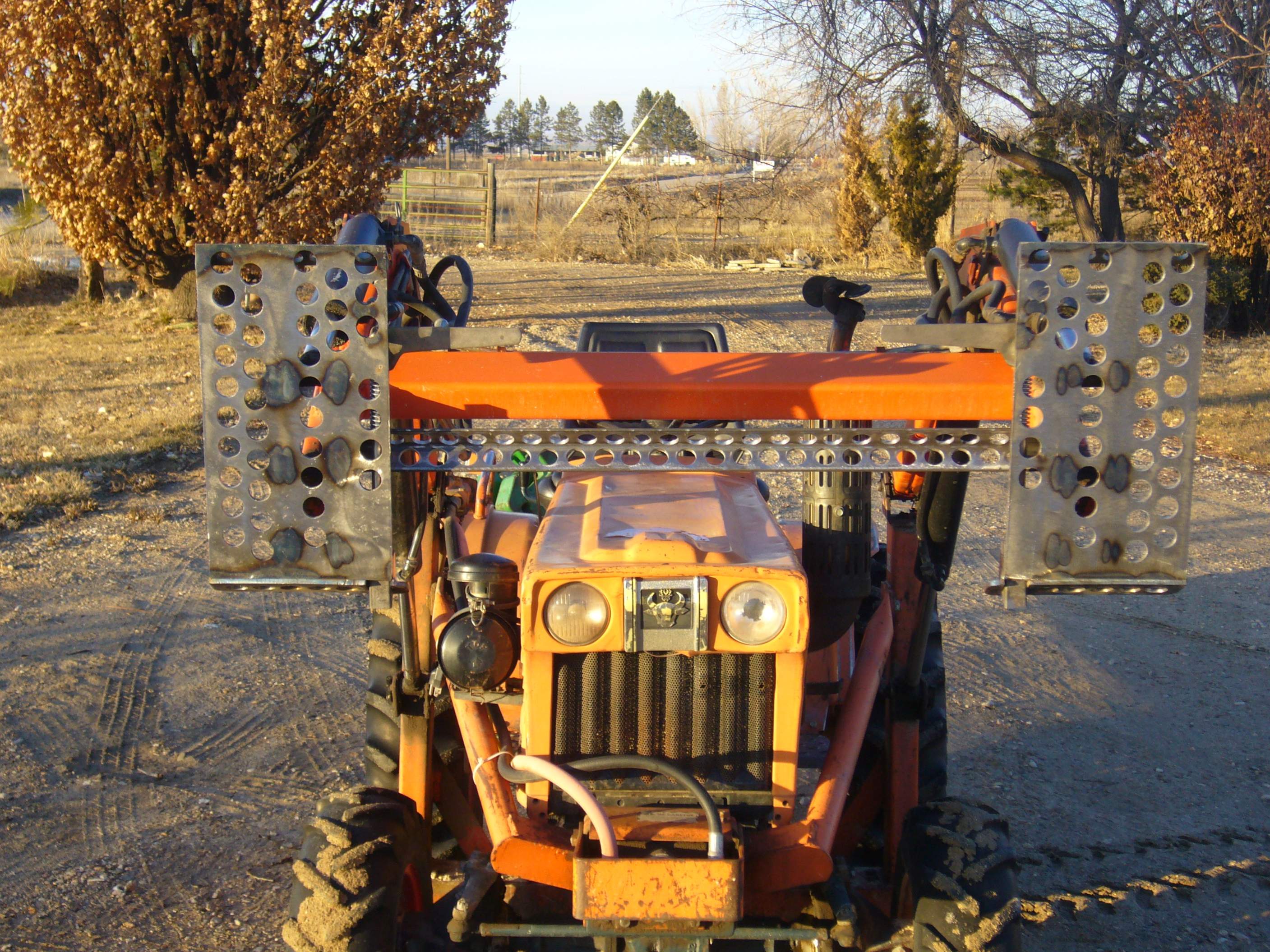

Once I figured out the locking mechanism things moved pretty fast. I cut the brackets off the bucket and cut the 'round' part off to weld them on the tractor adapter. I took a cue from Ductape on his quick attach modification and spent _days_ in front of the drill press making things lighter... I could have went with lighter material but I already had a pile of 1/4 plate and a drill press so.... :rolleyes:
Here is what I ended up with:
Still weighs in a 35lbs even though it is mostly holes ;) That piece of angle iron is a little lightweight now but with the cross arm on the loader not too far away I think it will be OK. I still need to weld in the 'stop blocks' between the loader brackets. The original bucket had these so that both cylinders would 'stop' at the same point and keep the bucket level.
Now the next trick is mounting attachment plates on the bucket. Looks like my pretty adapter plate is going to have a date with the plasma :eek:

Nice work ! All that swiss cheese looks farmiliar, as i did that to mine also.
/ B7100 Quick Attach #8

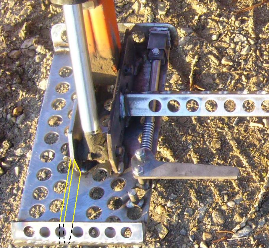

Very nice! I built my own also (see http://www.tractorbynet.com/forums/build-yourself/141029-tractor-side-shuttle-shift-quick.html).
I like that your attachment does not displace the bucket any further from the pins - maintains lift and curl performance.
I have a couple of suggestions though;
Add a small gusset between the top angle (45 deg) and the loader pin bracket. This will prevent the flat stock from flexing especially with all the "speed holes" (Homer Simpson;)) in the material. It might be strong enough to not fail but movement may cause your lock pin to tighten and jam.
Also, the holey angle iron between the sides might not be strong enough. There has been debate about how important (structurally) this piece has to be but you will likely bend or twist that angle if you only get one side of the bucket hooked (this does happen). I understand that your loader does not have a huge lift capacity but you can subject it to a lot of stress with the tractor.
I like your design; I had to use a different configuration because my loader arms lined up on top of the QA pins. With my setup I was able to have both lock pins work off of one lock handle which is really nice and now I can make it remote control!:cool:
It does but only about 1/4 to 3/8 of an inch.
Yeah I left that one 'path' through the holes to help stiffen things at the top. By gusset do you mean just welded to those pieces (air underneath) or also welded along the flat plate?
Hmmm hadn't thought about pressure more on one side of the bucket than the other. It _is_ twisty and I had really only thought about when the curl cylinders come full back. (need to put those 'stop blocks' back in)I used angle because I have a pile of it, another cragislist buy :D , but actually liked the idea of tube better.
The other thing I am a little concerned about is the 'softness' of the locking pins. Been wondering if it is better to have 'hard' pins?

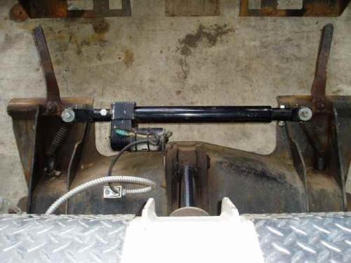

Found a picture of something that you might can use on your adapter. A linear actuator for open and closing the locking pins.

That would be sweet! Doesn't help much with the weight issue though. Nice thing about a small tractor is I could just use one of these:
:D
if I could find a place to carry it! :rolleyes:

I know that your bucket would be out a little. Aftermarket QA plates add two inches or more...
For the gusset, you don't need much. See my hack of your picture. I would do this for both the top and bottom. Doesn't add much weight and would do alot for rigidity.

Very nice build, I have a question: What keeps the locking pins handles in the locked position, I have been drawing up some ideas for a quick attach for my L4200 and have been stuck on the locking pins, I really like the simplicity of your design, I just dont know what to fab up to keep the locking levers from popping up
Thanks,
Mike
#17
Charlz,
Thanks for the comments. Since I haven't finished I have not been able to drive it around and test how well they stay 'locked'. What I did is under the angle iron there is a 'stop block' that prevents the handles from rotating too far, on down and around, and thus loosening the lock pins. I set this block so the handles come just slightly 'too far' and hopefully that is enough to hold the handles in place. Not sure if that makes sense or not. ;)
Another thing, which actually plays more towards keeping the handles up when 'unlocked' is the friction provided by the nuts holding the handles on. I plan on using nylock nuts so I can set that friction without having to worry about the nuts coming loose (hopefully).
Maybe someone who already has this type of QA can comment on the handles staying down.

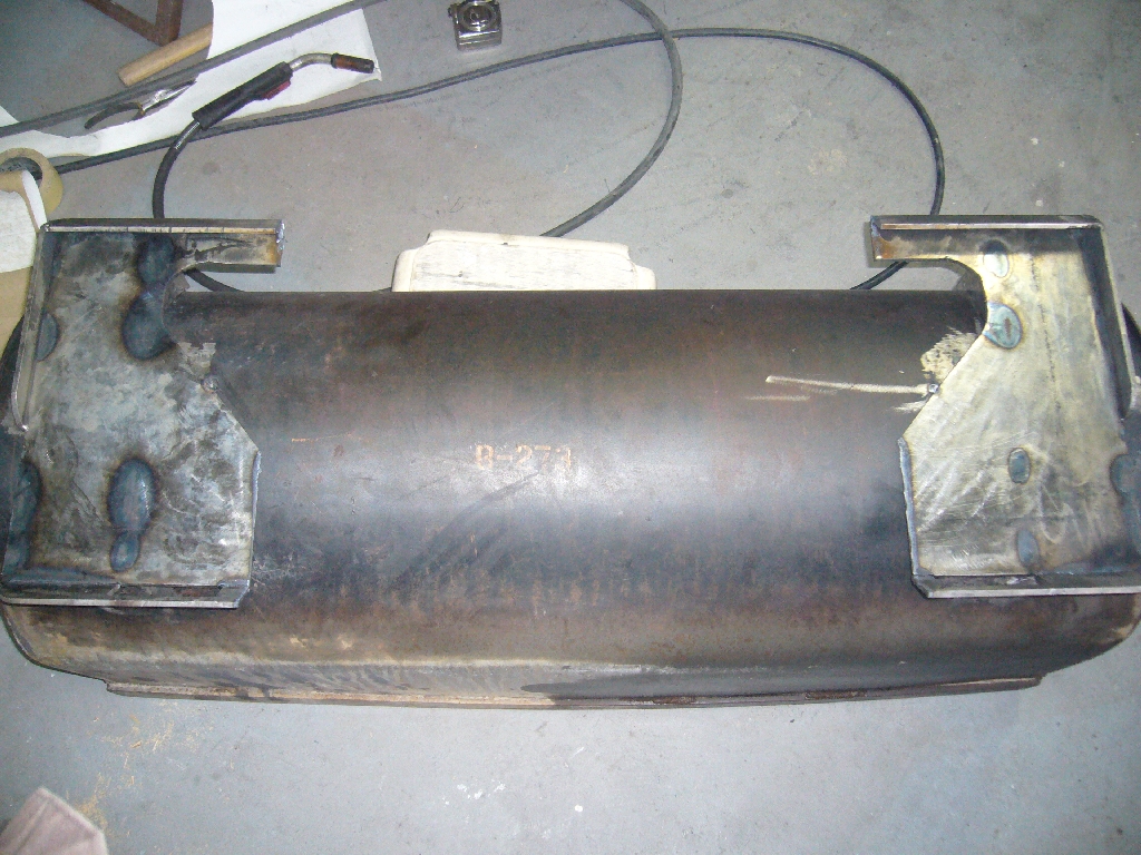

Speaking of the locking handles and their stops. Tonight I tacked the QA plate onto the bucket and did a test fit to see what it looks like. Well, I found out the upper 'stop pin' that the handles come up against is perfectly aligned with the elbows coming out of the curl cylinders... and just long enough to hit them :eek: and if you curl the bucket all the way back somewhat quickly with weight of the bucket on there... well let's just say a new street elbow and some oil in the loader reservoir are in order along with moving those stop pins :D :rolleyes:
#19
The other day I fixed the hydraulic 'problem' and solved the issue by moving the stop pins higher up, clears by a nice margin now. :D I also added the gusset between the loader bracket and top 45 degree plate as suggested by MWB.
While I had the QA plate tacked to the bucket I mounted it all on the tractor and checked the full dump and full roll back positions against baseline photos I had taken before cutting the brackets off the bucket. I had also made a line on the ends of the bucket that was parallel with the backs of the loader brackets. This would be the plane that the QA bracket would need to match. Everything in the photos looked good so I believe got it. The QA bracket is going to be lower than I would like but with a small tractor comes a small bucket :(
Next I started working on making the curved gussets to support the QA plate on the bucket. This took some messing around because I don't have a compass that can draw a circle as large as the curve of the bucket. I wound up taking some heavy paper and 'cutting' it to the curve of the bucket with a ball peen hammer.... like they used to make replacement gaskets back in the 'good ol' days'. Worked out pretty well. One of the things about working with a 30 year old bucket is there is pretty much nothing straight or the same on the each end :eek: I then figured out the height and length of the gusset and marked out a rectangle. By using the curve on the paper I could trace it from one corner to the other. Then I moved to the opposite corner and did the same thing. This gave me two gussets in one 'rectangle' with only a little 'football' of waste material in the middle. I can see where a plasma table system sure would be handy! :D
I made a wood template to help guide the plasma torch with the correct offset. Not everyone came out perfect but in the end it worked out because the back of the bucket was not perfect so I could mix and match gussets until I got one that fit that particular spot.
Once I tacked most of the gussets on the QA plate I took the plasma to it and cut the center sections out of it. This is an effort to lighten it a bit. Overall it will just compensate for all the gussets etc. I have to put in. I also welded on the gussets that I had tacked.
Here is where I left off, the two halves sitting on the bucket where they go. I made witness marks before pulling off the QA plate for cutting to help line these halves back up:
One half flipped over to show the gussets.
Now I just need to figure out how deal with the hole, there is one more set of gussets that will go along that edge of the plate. I made the QA plate from one I saw online and cut the center out. In hindsight I should have waited until where I am now to figure out how to lighten it up a bit. Oh well, live and learn ;)
