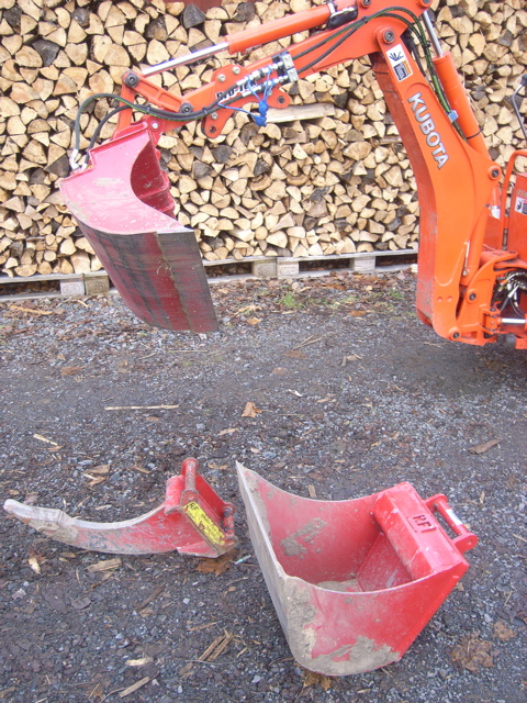

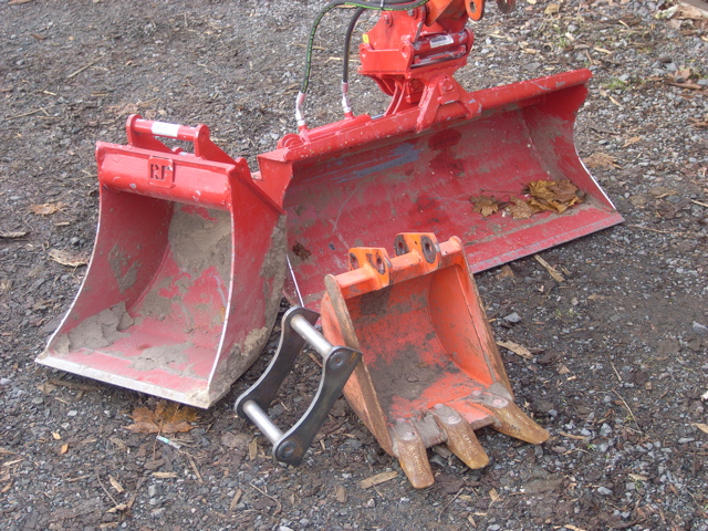

Heres a little bigger pics. If u wonder anything please respond.
I used a 6-2 valve, sitting on the inside of the backhoe at the lower parts.
I have installed a "push contact" using my right foot to activate, 12volts comes from my fuseholder inside battery compartment, then I use the right lever, bucket movment to tilt the bucket side ways. This is very useful when you not can stand in line with the slop.
/Sam
