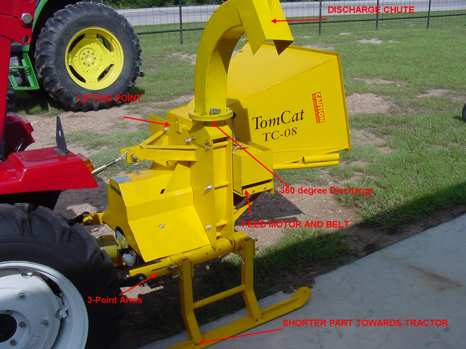

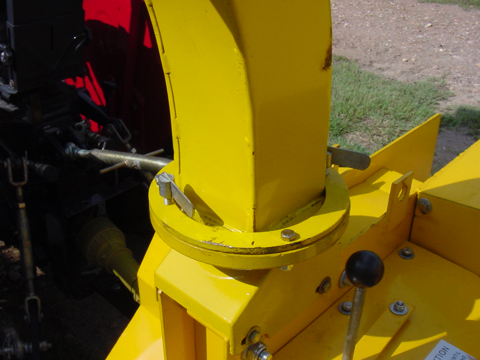

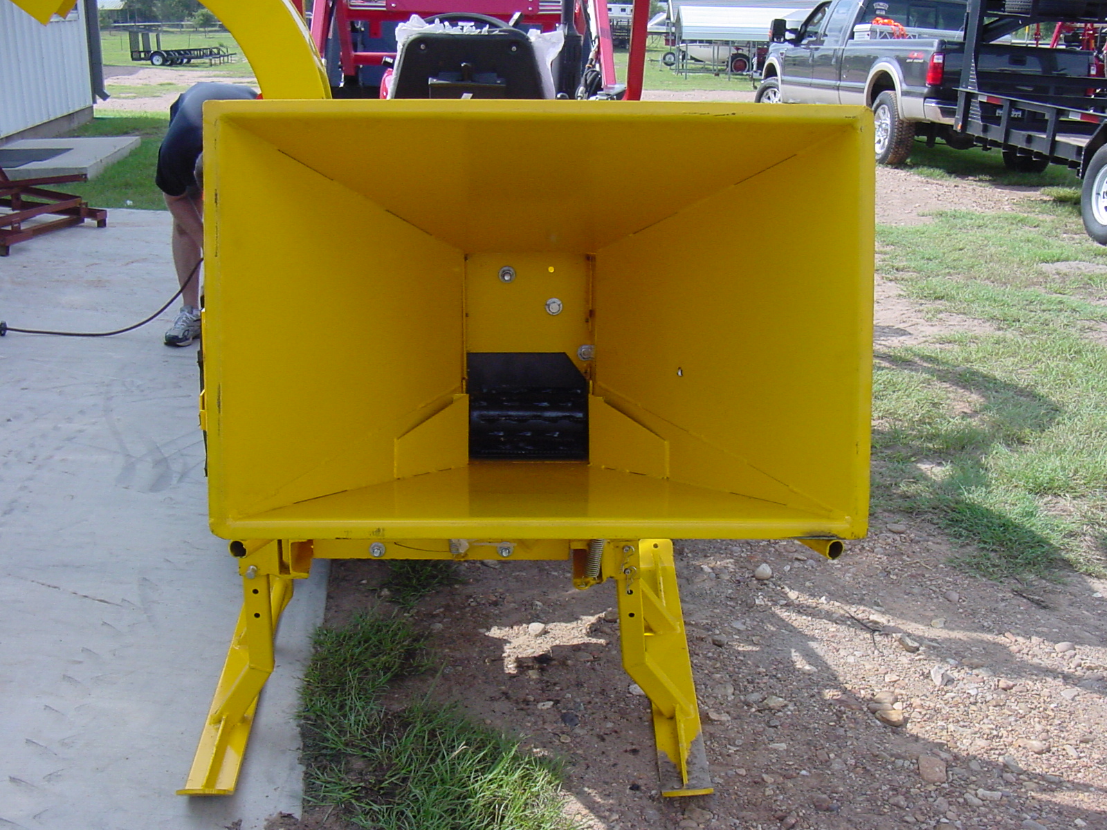

We have sold Jinma Wodchippers for years, no big problems at all a great value for the money, I also have a 8" Chinese self feed Woodchipper,with some added features that Jinma does not provide.E-mail me for more information if interested. We keep every part for both in stock.

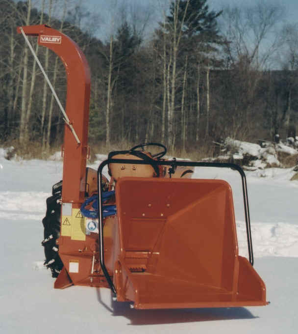

I have this and I run it on a 3710. it works very well and has chipped a substantial amount of brush. I have put up 70 cord of fire wood in the last 3 years and it has chipped up the slash from that work as well as a lot of slash from other brush cutting.
I believe it is a Valby 150, made by the same folks who make Farmi logging winches.
This thing is VERY stout and robust. I have owned it for 12 years and had zero issues with it.
He picture on the right is the most accurate one I could find on the internet. Aparently Valby now calls this model the CH 150 HF (hydraulic feed). Mine is a two stage hydraulic feed. I find it best to make a big pile of brush and then stand there feeding the chipper......... It makes very fast work out of a LOT of brush. nOisy though, I wear ears when running it.

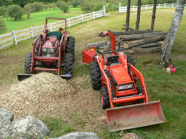

Roy, when I am cutting a stand for firewood (often an area that I need to clear which has encroached my orchard and I am tire of limbing to keep them back) I will fell several trees and then set my winch at a central, level spot where I can also set up the chipper.
I will winch each tree in and then limb and run through the chipper. That way I am only handling each piece once.
Winch, limb, limb, limb, feed, feed, feed. Winch some more, buck the length, reset the choker and winch some more.....
Rince and repeat until I have 6 or so 20' lengths, and then skid to the bucking/splitting yard. I will do that until I have the area cleared and all the slash in a single pile of chips.
The chips get moved by big loader for landscaping purposes and then I move down to the bucking/splitting yard for a stint at that end of the firewood production. I put up 40 cord this year, so I had to learn to be efficient in my movements.
My avatar tells nearly the whole story..............
here is the rest:
