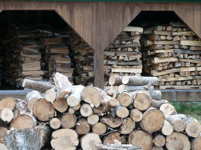

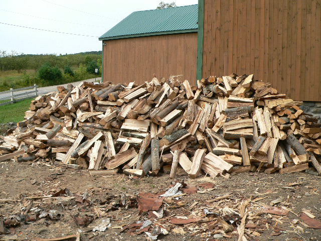

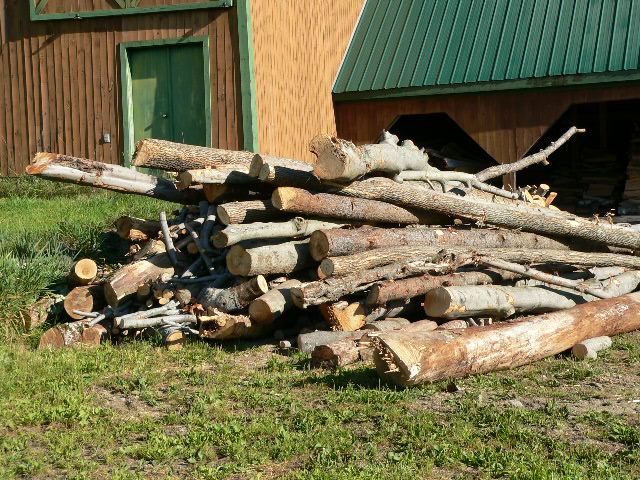

Roy, when I am cutting a stand for firewood (often an area that I need to clear which has encroached my orchard and I am tire of limbing to keep them back) I will fell several trees and then set my winch at a central, level spot where I can also set up the chipper.
I will winch each tree in and then limb and run through the chipper. That way I am only handling each piece once.
Winch, limb, limb, limb, feed, feed, feed. Winch some more, buck the length, reset the choker and winch some more.....
Rince and repeat until I have 6 or so 20' lengths, and then skid to the bucking/splitting yard. I will do that until I have the area cleared and all the slash in a single pile of chips.
The chips get moved by big loader for landscaping purposes and then I move down to the bucking/splitting yard for a stint at that end of the firewood production. I put up 40 cord this year, so I had to learn to be efficient in my movements.
My avatar tells nearly the whole story..............
here is the rest:
