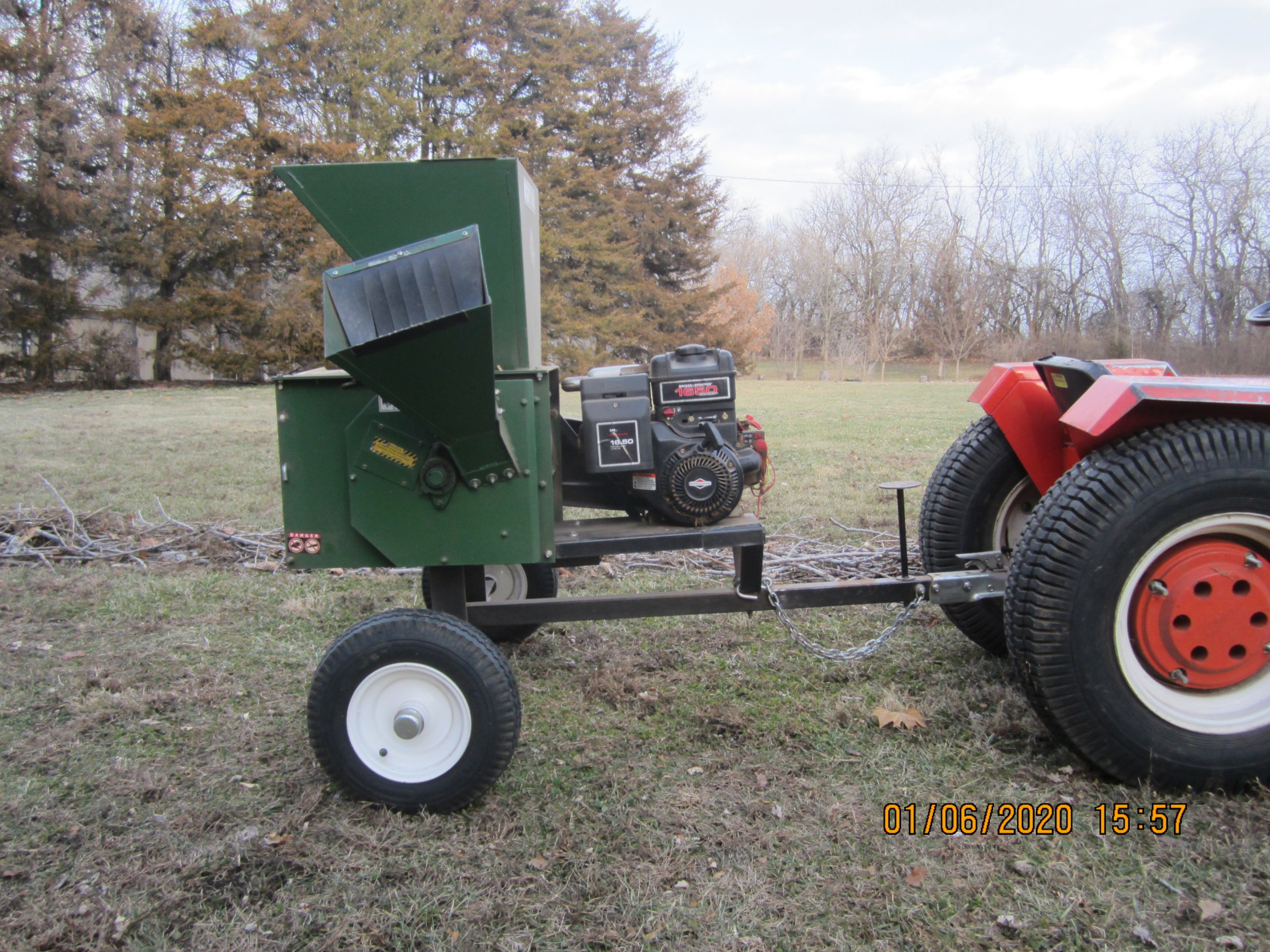

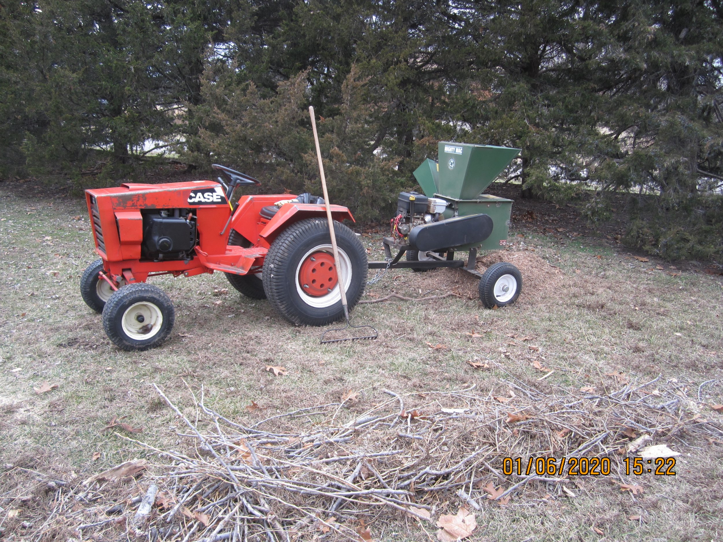

4" is small, as mentioned above, due to the trouble with wood that isn't straight. There is a company in Canada, that makes nice chippers, and depending on the size, not much more than the one you listed. Woodland Mills? I forget.. I ended up buying a well-used Bush Hog chipper/shredder with 5 inch or so capacity, and it works fine, but is put together with like 20 small nuts and bolts so sharpening is a challenge. Still, the price was right and it works. I believe the Bush Hog was rebranded from another brand, and the same chipper/shredder with some modest changes is still available today, but it's very expensive. I forget what brand it goes under now, but Echo was selling it for a few years not too long ago.
Even if you never chip anything more than 3 inches, you'll want a bigger chipper, on that I'll bet.
I have an old Troy Bilt super Tomahawk 8 hp, 3" machine I bought new about 35 years ago, and even though I burn firewood to heat the house, it was small for what I needed, and I sure wish I had an 8" machine even though I would never chip anything close to that, unless completely rotten. 5" is better than 3", by a LOT, and you'd find 6" far better than 4..

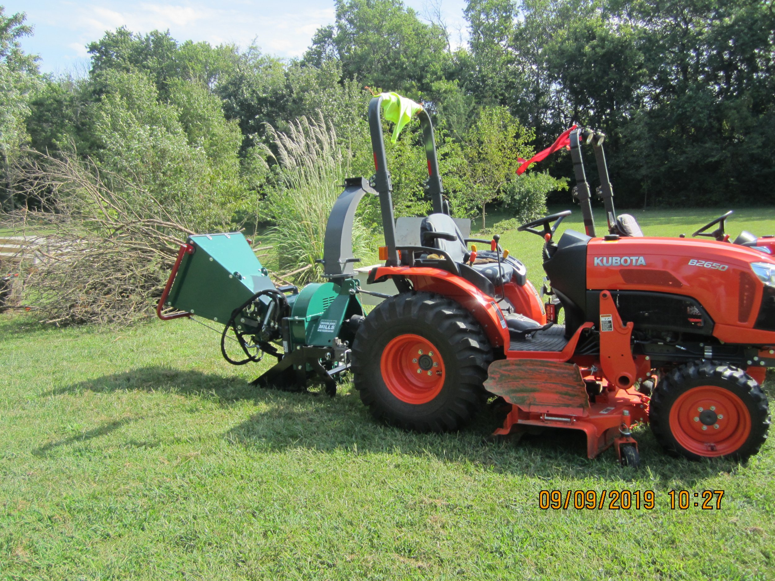

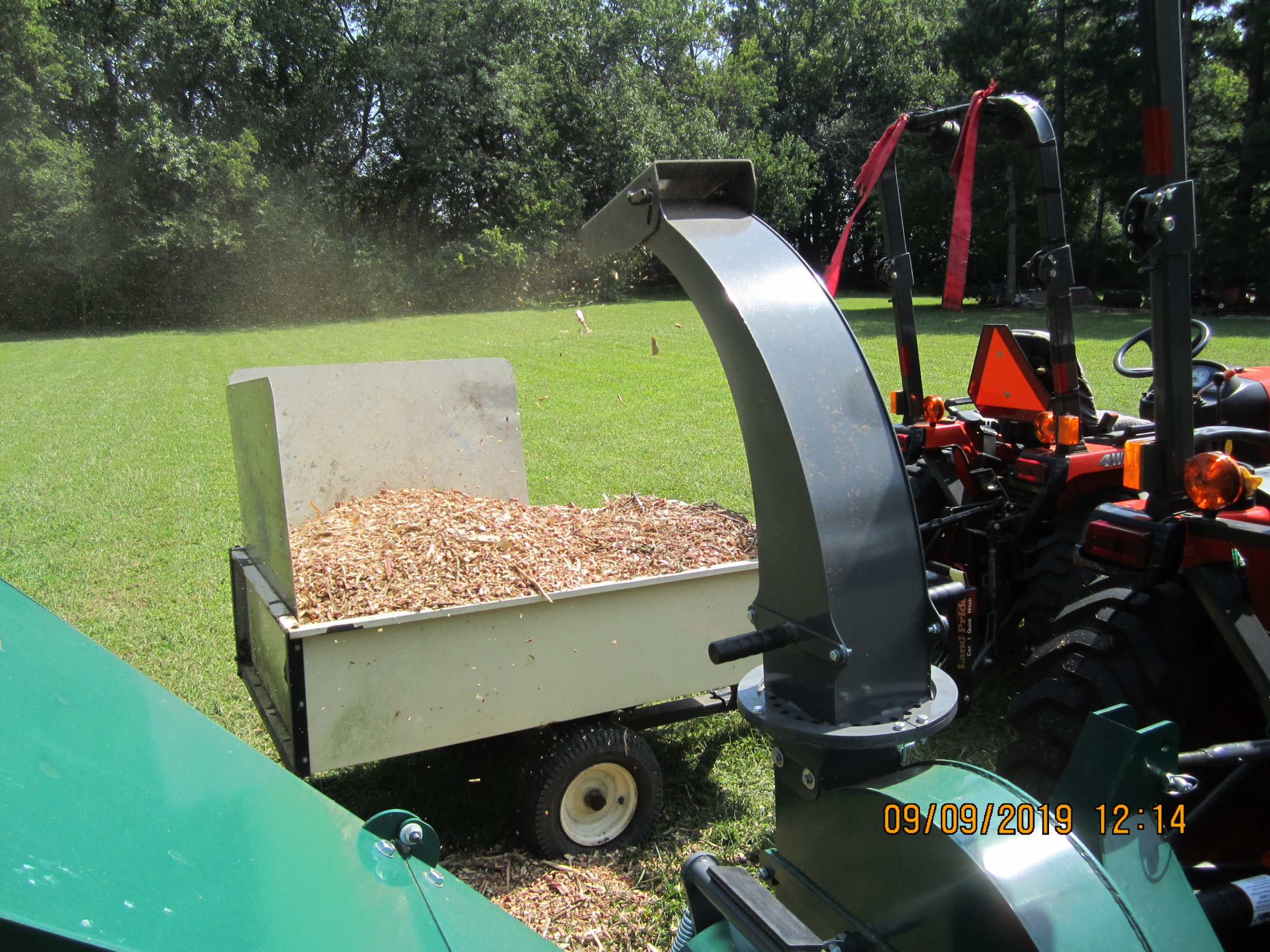

After doing a bit of research, I purchased the Woodland Mills WC88 8" PTO Wood Chipper at the beginning of this season for my Kubota L4701. We absolutely love it – by far the best tractor attachment I've purchased to date! It's fast and efficient, rarely fails to pull in brush and logs we feed it, and gets the job done. Because my tractor is on the lower end for recommended PTO horse power (47hp), I don't attempt to feed it 8" logs because I'm sure it may bog down. However, I've had no issues with 6" material or less. The reviews of other users speak for themselves on this product – over 260 reviews, and they're all 5 stars. I couldn't agree more!
