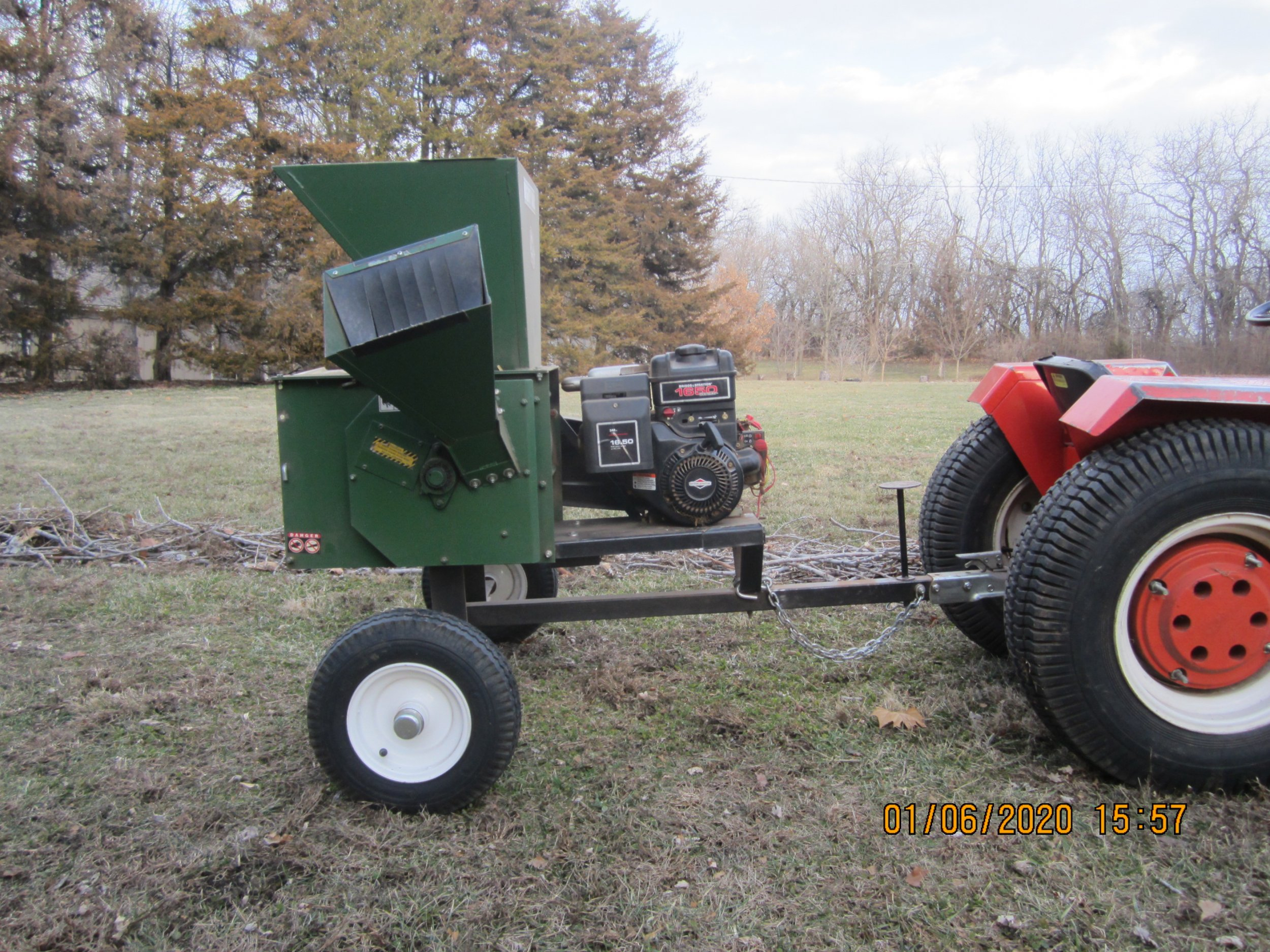

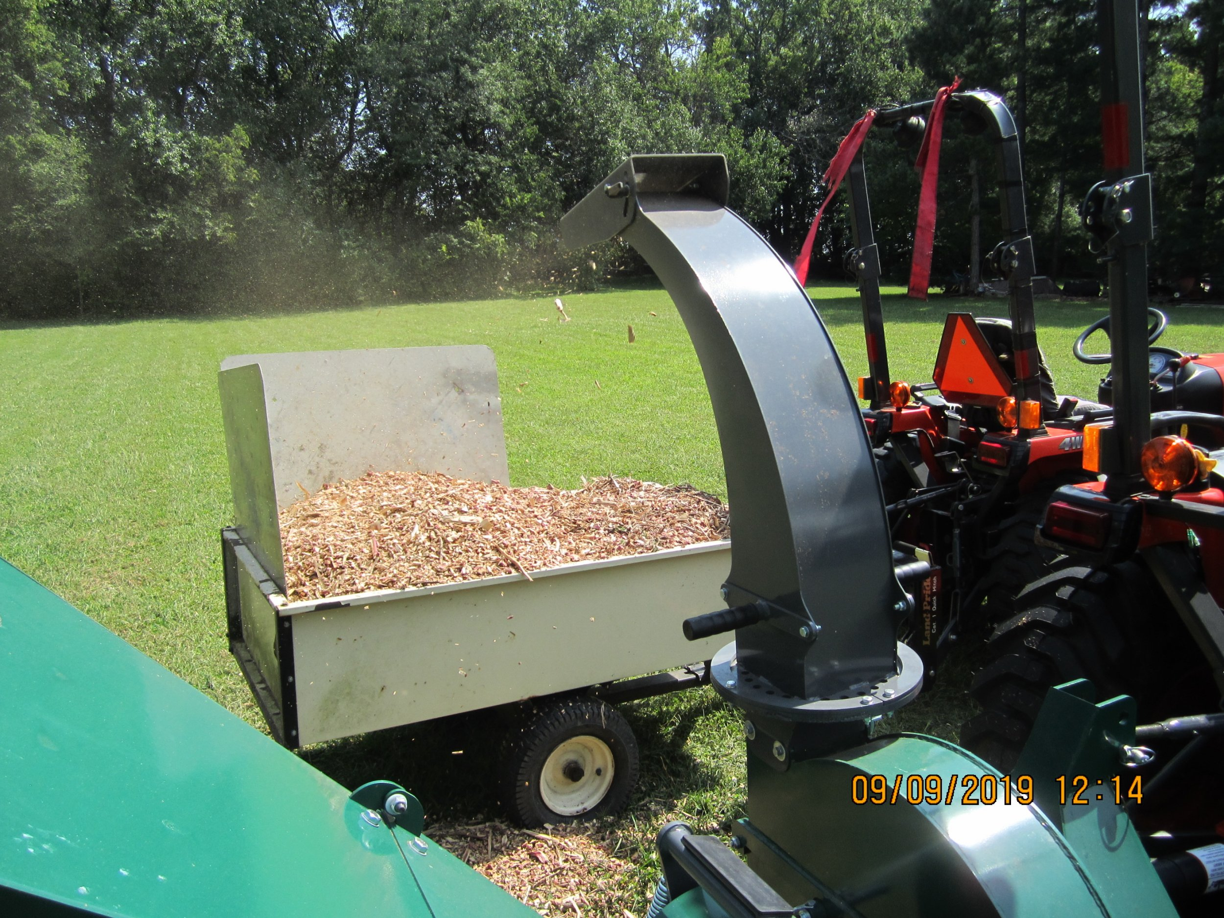

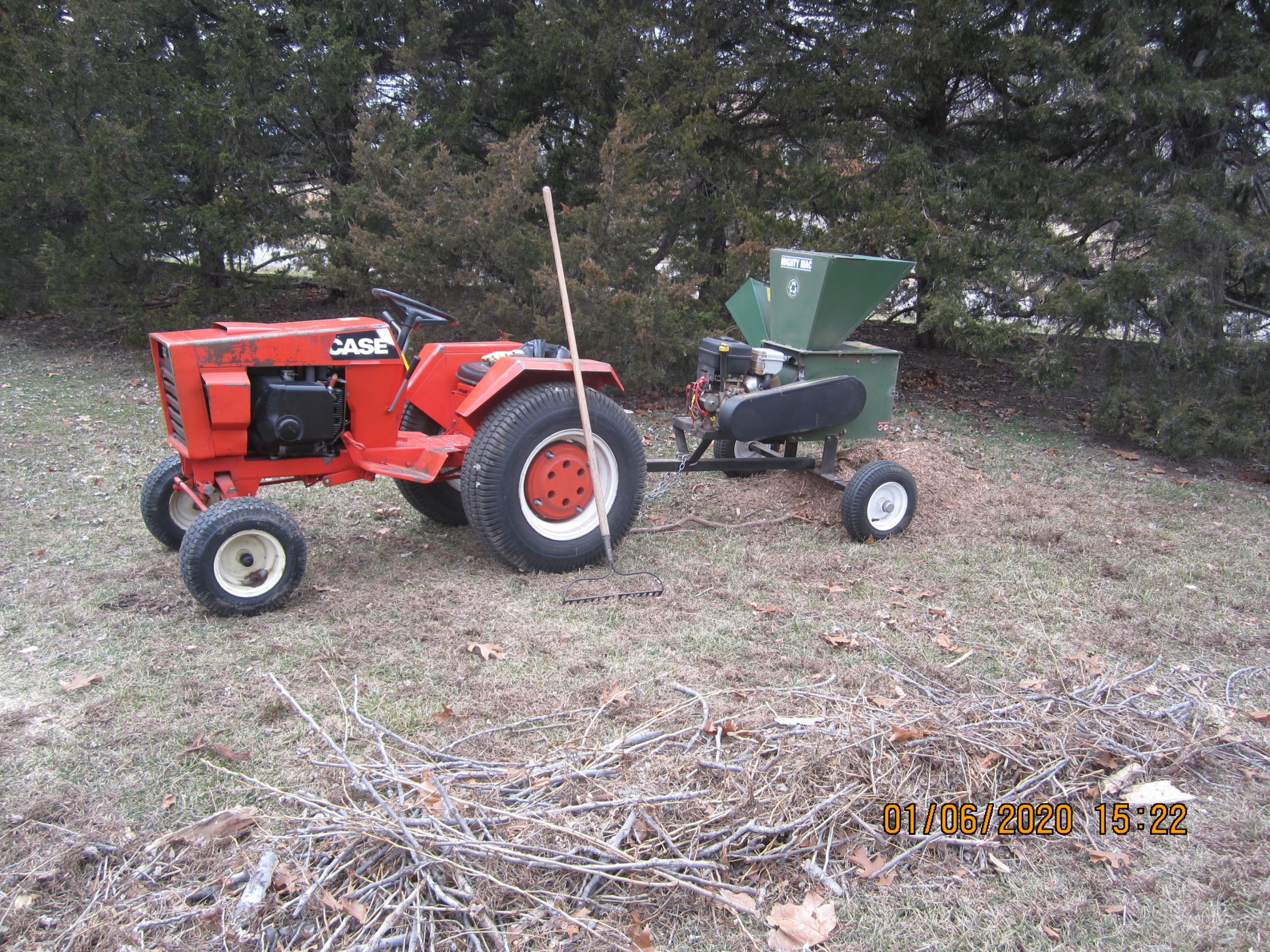

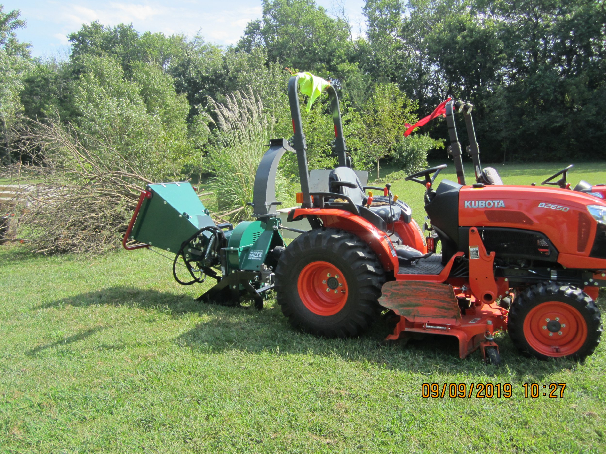

As my life moved on around here in years, I ended up with two machines........
1. MacKissic Mighty Mac shredder / chipper....SC1650 HTE It still serves me the past 13 years. It is electric start ...gasoline powered ..4" maximum capacity chipping. It is really good at shedding small stuff....but can chip larger branches as well.
2. Woodland Mills WC68 PTO powered chipper. As time went on I needed a bigger machine to handle bigger stuff in larger amounts. Have used it over 3 years now.
I really like both machines to match the job at hand.
Cheers,
Mike
