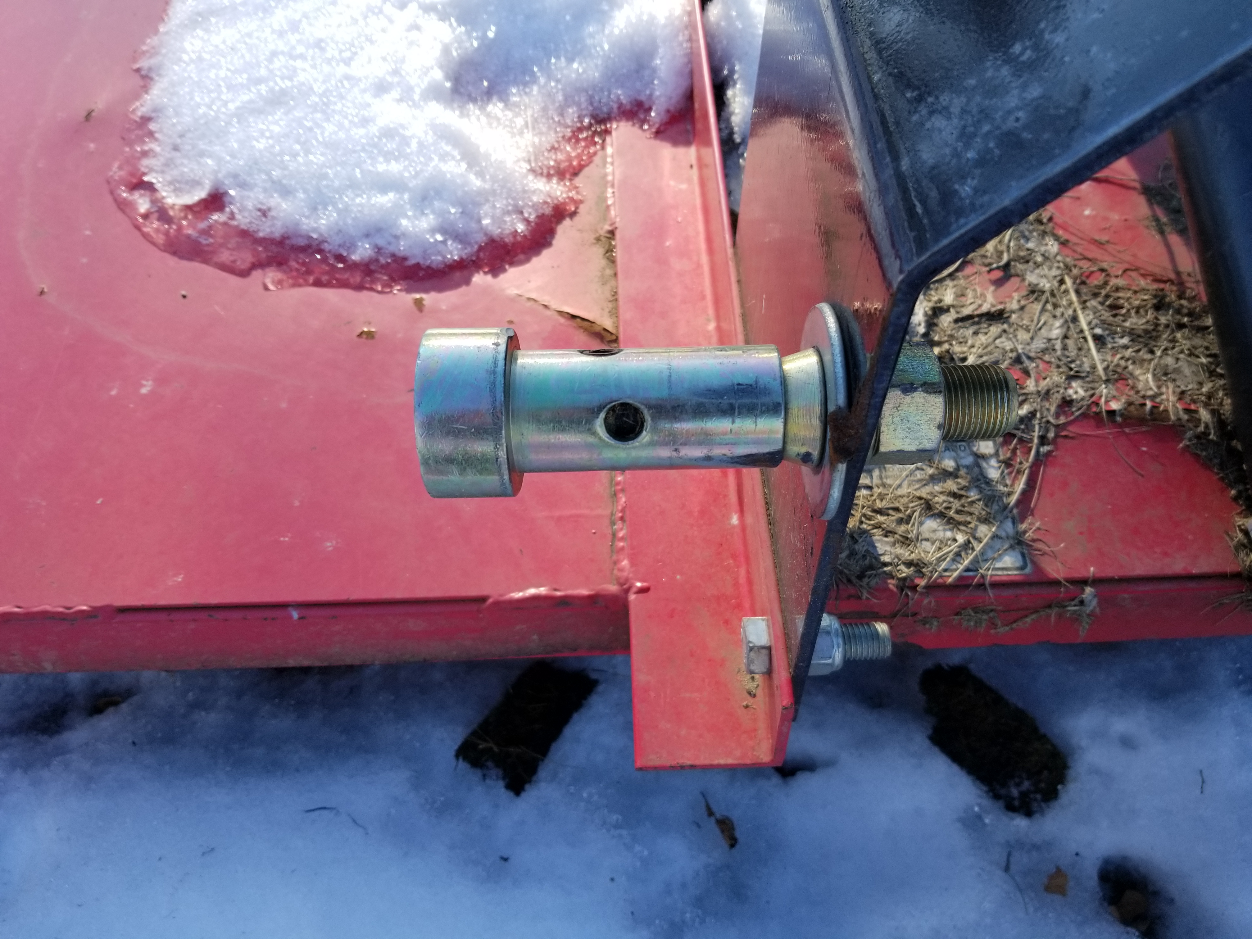

Need is a bit strong of a word. It's best to use them though. I have them on most of my impliments. My King Kutter tiller cant use them though. There isnt enough clearance between the frame & the pin with them on. I could rebuild things with the pins an inch or 2 further out, but I havent bothered. It's not wearing badly or anything.

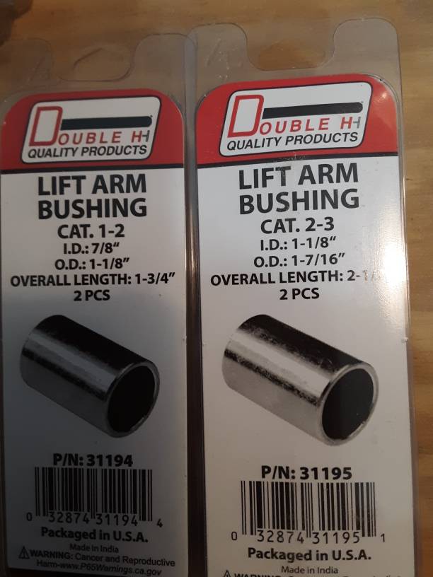

Here is what I use. Inexpensive compared to the adapters. 20191107_180432.jpeg

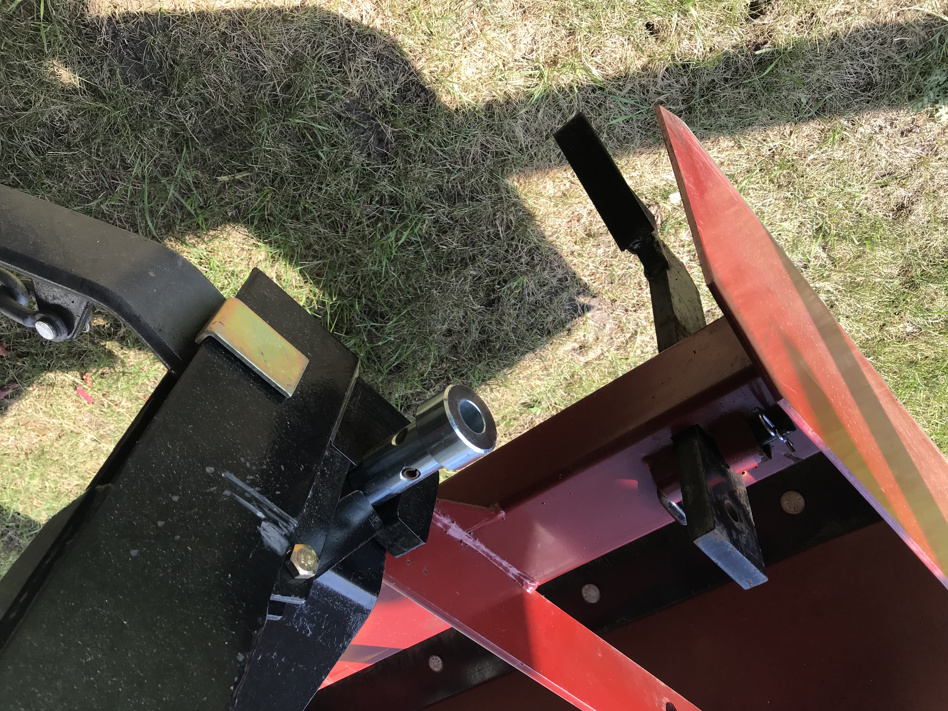

Not sure which dimension needs more clearance for your tiller. But you know you can flip the bushing around, so the collar portion is to the outside (or vise versa if you need).
I had to flip them on my brush hog:
Only my (free :thumbsup:) JD ballast box required that type of bushing... it was probably designed for a Cat 0/1 so the pins were a wee bit short.
All of my other implements use the type that Citydude posted.
You can see the rust on the frame behind the pins from where I tried & failed to hitch up with the bushings on. There is about 2.5" of clearance without bushings which is enough for the hooks to clear. With the bushings on it wont slide into the hooks as they hit the frame.
I've converted several non-standard impliments to be QH compatible & am working on welding a new top hook mount for a cheap back blade now. I just cant be bothered for the tiller as it works fine without bushings. At the rate things are wearing on it I'll be through at least 3-4 sets of tines before there is any real wear on the pins.20160910_192538.jpg
These are great. They are more expensive than regular bushings but they are probably worth it.

Outside pins get the entire bushing that is slid over with a roll-pin. Keeps the implement from wandering because of the larger end. For clevis style hookups I do normal bushings. The thing that is annoying is that most "Quick-Hitch" ready implements also need 2 cat1-to-cat2 bushings and then 2 cat2-to-cat3 to fill up the quick hitch. I guess it depends on the size of your quick hitch arms, but it seems like they all end up being a cat 3 sized bushing. They should supply them as one could argue they aren't really ready to just be hooked to a quick hitch without possible rounding things over.
/ Bushings or not? #14
Is your quick hitch a cat 2 or a cat 1,
from what I have worked with and seen,
if your tractor is cat 1 and you buy a cat1 quick hitch the hooks are cat 2 size so one to two bushing take up the slack.
When using a cat 2 tractor with a cat 2 quick hitch the hooks are cat 3 size and cat 2 to cat 3 bushing will take up that slack.
/ Bushings or not? #15
All my cheap Cat 1 QHes had hooks sized for Cat3 pins.
/ Bushings or not? #16
The MX5200 comes as cat 2 with cat 1 bushings. That is attached to the quick hitch. The quick hitch takes cat 3 bushings and most of the implements have cat 1 pins. That is why I go cat1-->cat2-->to end at cat3. I wish the sold just a cat1-3
