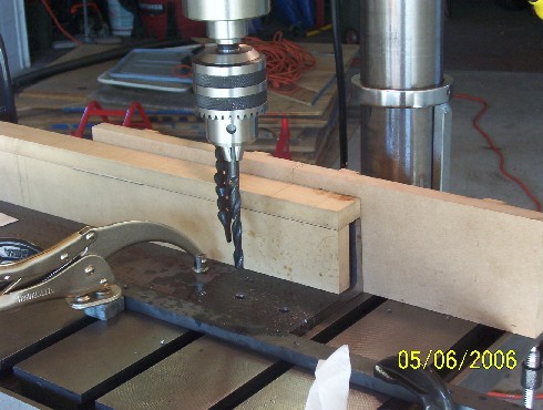

#25
drilling pivot plate

/ building a rake #29

/ building a rake #30

#39
Eddie, thanks, the rake is my design developed from research on the internet, studying manufactured rakes and with the help of MadReferee, he has been an inspiration.This is my first tractor, the only thing I know about tractors is what I have learned on TBN. As far as pivoting the rake,I believe it would push the debris off to the sidein a line to pick it up with the bucket or keep moving it over in a big pile.I think it would be worth making it pivot.The tines I purchased from Agri-Supply(Thanks MadReferee)
