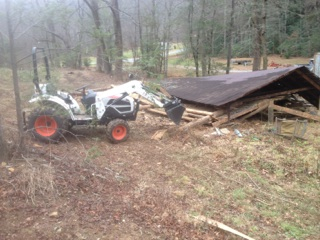

A couple of things I discovered over the last couple of days as I took the tin off of the roof:
1. Apparently it was common building practice in the 1940s to put anywhere from 500-900 nails into each piece of 24" wide tin.
2. R4 "Industrial" tires should not be considered R4 "Indestructible" tires. Reference point #1 above.
Fortunately, it was a front tire that took one for the team and not one of my filled rears. A quick trip to my tire guy and a $10 plug later and we were back in business.
At this point, it is beginning to look like there is little salvageable material left. I had hoped to save a good bit of the loft floor but because of the volume of rat excrement (it's the New Year and I'm trying to be nice) it is just not worth the time and trouble to cut out what little good is there. Some of the roof joists are in good shape and many of the roof purlins are fine as well. I'll grab what I can.
The plan, for now, is to salvage the last bit I want, cut as much of the rest as I can and haul it off, then burn in place the remainder. After it's burned. I'll rake out all the metal I can, then rent a small excavator, dig a small hole, and bury the rest of the debris. I want to take off about 4"-6" of the top layer to make sure I get any escaped nails and such.
Today's work. Now to pick out the good tin.
