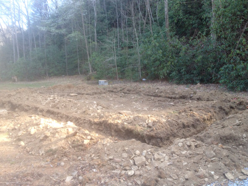

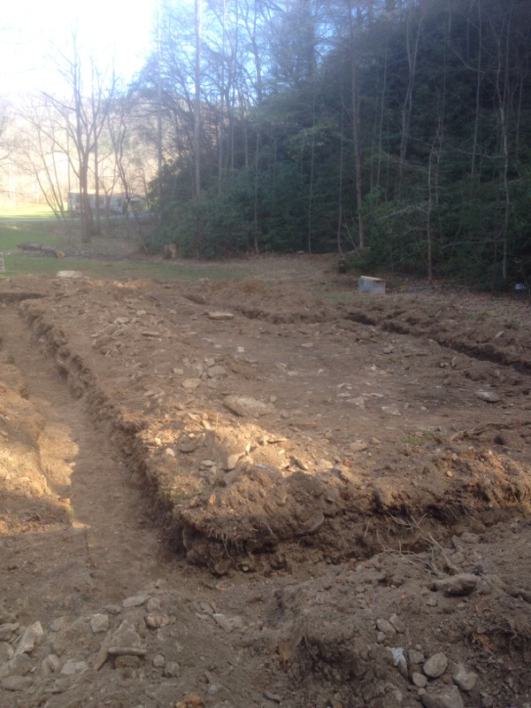

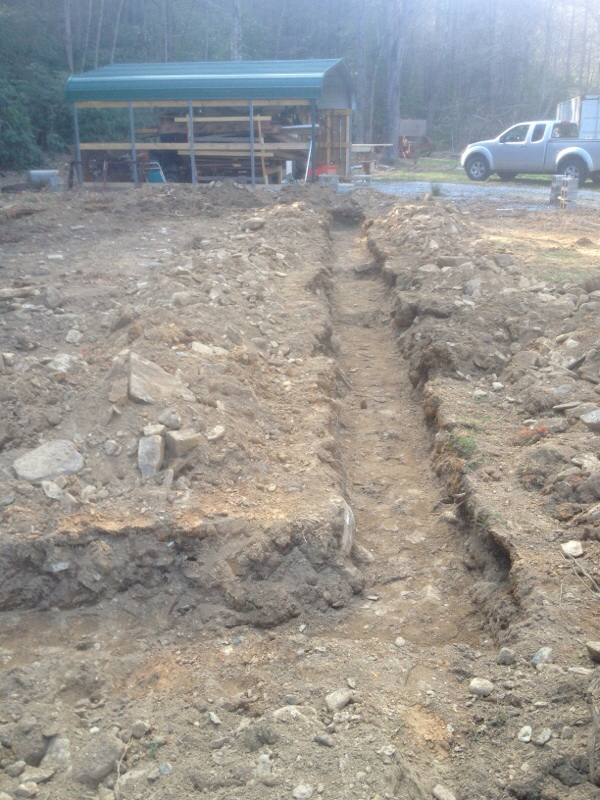

You have a valid point. I suppose I should have mentioned the purpose and such before soliciting advice. I keep my tractor parked under a drive-thru shed. I need the new barn to be big enough to work on the tractor (routine maint., etc), but not store it. The primary purpose is to be a workshop/man cave. I will have it wired and will have a wood stove for heat and a window unit for when it gets too hot.
It's going to be placed by the drive on the approach to the house. Because of this, I decided to go with this plan. With the steep roof and the pole construction, I have several options to finish the outside to complement the house. I will eventually finish the loft of the barn as a bunkhouse...if and when grand kids arrive.

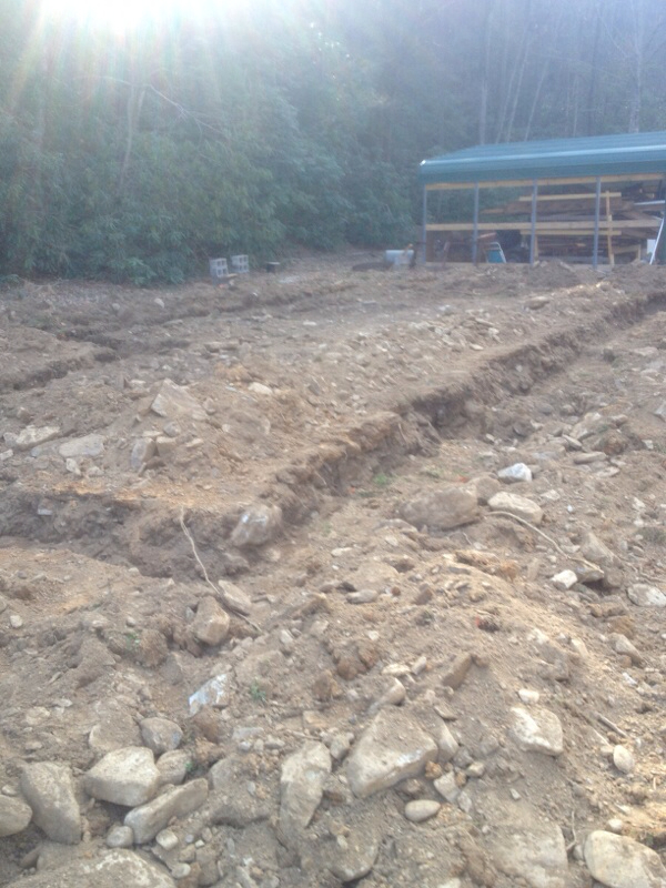

I'll take a few pics of the site and the old barn that is there now to an idea of the plan.

The Permacolumn idea looks pretty good. I had planned on boring 24"x4' holes for the posts, filling with a foot of concrete for the base, then surrounding the post with concrete up to the top level of the slab, but those look like an even more permanent solution.

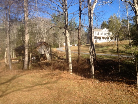

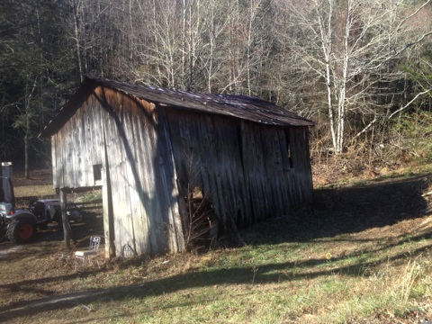

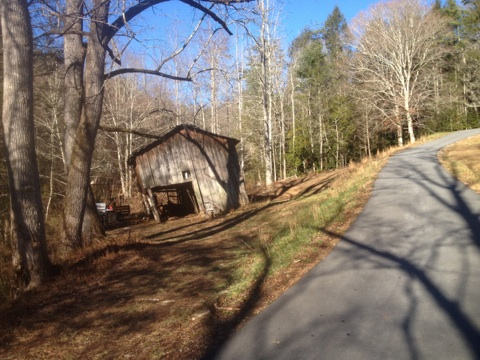

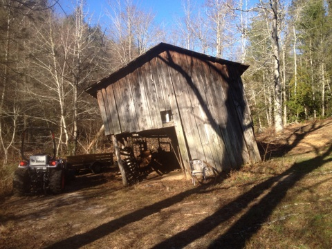

I've been cleaning out the old barn in preparation for taking it down. I figured I should take a few pics so everyone can see what I'm planning and what I am facing. As you can see, the old barn is beyond saving, the lean is too severe. However, I can save most all the exterior planks (hemlock) and most of the loft flooring. I am planning on paneling the part if the interior that will be the "man cave" with the weathered boards.
When compared to the trees nearby, you can see how the barn is leaning. Also, the ground has become unlevel in some places so I will be doing a bit of work with the box blade. I am trying to decide between a traditional red barn or painting the exterior a clay color with white trim and dark grey metal roof...colors like the house.

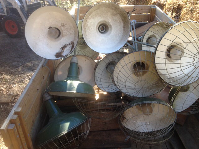

And I found the lights I want to use too. My Dad was a principal for 30+ years and when the lights were replaced in the gym of his school, naturally he took the old ones and "saved" them. I am going to clean or repaint them their original color and mount them without the down rods in the barn then put two for exterior lights.

That is a leaner:D. If your tractor was not beside the barn in that first pic I would have thought you were holding the camera crooked:laughing:
Put a few poles on the side to brace the barn. Once you start taking interior boards off and the exterior off that thing could collapse. Be safe.
The barn wood would look great in the interior. I don't think the lights would look good at all, I will buy them from you for $10.00 each and you can get some nice florescent lights.:thumbsup::D

You know, I think I will try the lights but if they don't work out, you will be the first one I call! Actually, my Grandad built the barn back in the 1950s. My Dad used it to milk a few dairy cows and store stuff. Lots of stuff. And yes, I grew up on this land...left for my Air Force career, then came back here to settle here. Mack-Dowell county is an interesting place. But I do love North Cove...the north end of the county. You've probably driven right by if you've ever been to Linville or Boone. Feel free to stop by!
