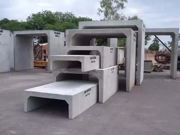

You might find precast box culverts in your area. Some have bottoms and others sit on slabs.
Bruce

Use steel stringers so the bridge will be there after you are gone. Rather than being non useable while you are here.
   / Building a bridge? #27
I priced one of those to replace a four foot culvert, the estimate a little more than $18000.
They must be priced for Gov't buyers using taxpayer money. :)
Bruce
   / Building a bridge? #28
No, concrete isn't cheap. That's what it costs by the time you buy, have it trucked, and excavator to dig the ditch.
   / Building a bridge? #29
If you are using timber forget the 4x6. You want a deep section. 2x8, 2x10 etc.
   / Building a bridge? #30
4' dual wall plastic culvert is $42 per foot governmental cost here is Missouri. The cost of larger culverts is extremely high.
