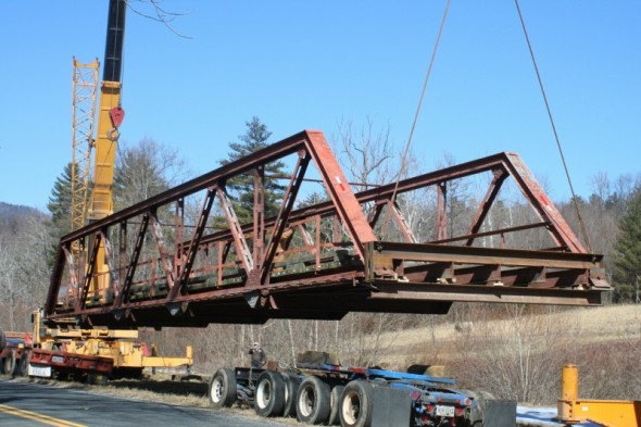

That photo scares the heck out of me. You need to have that bridge evaluated by a P.E. with regards to its new setting. You need to have the foundations designed by a P.E. You need to have the bridge periodically inspected by a certified bridge inspector.
If there isn't a law in Virginia that forces you to do those things, there should be. That is a serious bridge.
Don't cut into your saftey factors. That's always a bad idea, but in the case of this bridge it is a incredibly bad idea.
Nothing personal, but I think VDOT was crazy to sell that bridge to a private individual for anything other than scrap.

Koop,
You mentioned a low water bridge now being used, which would cause me to speculate that this bridge is not crossing a 90' deep ravine. I, for one, would like to hear about the crossing. Is this bridge going to span the same distance that it did originally? Can the new supports be set so that the free-span length is reduced? Is it possible to place a center span support pier?
For me personally, the circumstances of the crossing would be a factor in what I would risk. If the span were as long as original but only 5' off the stream bottom I would feel different about it compared to a 15' deep stream. Not that you would want to lose the bridge under any circumstances, but a 5' collapse would be less likely to hurt someone when compared to a 15' collapse. Around here we have a lot a 2-lane state highways with the bridges rated at 52,*** lbs (not sure why that is the prevailing figure) and they are constantly crossed by log and grain trucks weighing in excess of 80,000 lbs year in and year out. This practice is well know by the state regualtors and no effort is made to stop it. The limits seem to be more of a CYA effort by the state because the state DOT itself routinely moves loads exceeding the posted limits across these bridges.

Toiyabe said:
Koop,
Why?
This bridge was in use up to the day it was moved.
Less than a year ago, VDOT had the bridge inspected and it was given a 7 ton rating in its current condition. One concern mentioned in the report was the condition of the crumbling stone abutments. The report also stated the average traffic volume was 300 - 400 cars per day.
So I ask why is this bridge only good for scrap? It will be repaired, painted and set on brand new abutments. Not to mention, on a heavy traffic day, there might be 6 trips across.
I would like to help clear up some of the assumptions being made.
The bridge weighs approximately 68000 lbs.
Because this bridge spans bank to bank, we should not need a permit, although we are waiting for this to be verified by the appropriate agencies.
The bridge spans the head waters of a small river with average depth of 12" - 18". The bottom of the bridge will be set about 6' - 8' above the river to ensure good flow beneath the structure during high water events.
The low water crossing is sufficient at the moment because it is only used a few times a year.
Perhaps the worst assumption to be addressed is from Kendall69. This forum is a great way for me to hear the perspectives of other members, even if I disagree with them. I really appreciate the input from critical thinkers (Toiyabe). I don’t see the value in those who choose to respond to my questions by assuming I am an idiot who wants to cut corners to hurt my family and friends and that the forum is a useless tool with which to gain information to assist in making a sound decision. You think that in asking my question I am analogous to a drunk driver etc, shows you think the worse of people and Tractorbynet members and that is a shame.

I think that VDOT should have scrapped that bridge before letting a private individual get a hold of it for liability concerns. It would be a shame as it is a very nice looking bridge, but it has a great potential to cause harm if used inappropriately.
My wild guess of 50 tons was wrong. Still, the fact that it weighs 34 tons but is only rated for a live load of 7 tons should clue you in to the fact that you are dealing with a structure on a different scale than most people are used to.
There is something sometimes called the "square-cube law". It states that the strength of a structure increases as the square of its length (cross-sectional area) whereas the the weight increases by the cube of the length (volume). So as things get bigger, they get heavier much faster then they get stronger. It isn't strictly true, but is good for mental approximations. The upshot is that big structures don't behave like scale models of themselves, although people often think that way. That way of thinking can lead to big trouble.
This is a very difficult thread to be involved in. I have an ethical requirement to urge you to seek professional advice while not giving you anything that could be seen as professional advice.

Renze,
You have seen the picture, I can give you the dimension of every piece of steel you see. Just let me know. I would love to see what your program comes up with.
It would appear I need to reassure everyone that if your program says 40 ton weight limit that I am not going to invite every tandem axle dump truck with 4 pony axles and 23 tons of gravel to come test your results. LOL:D :D
