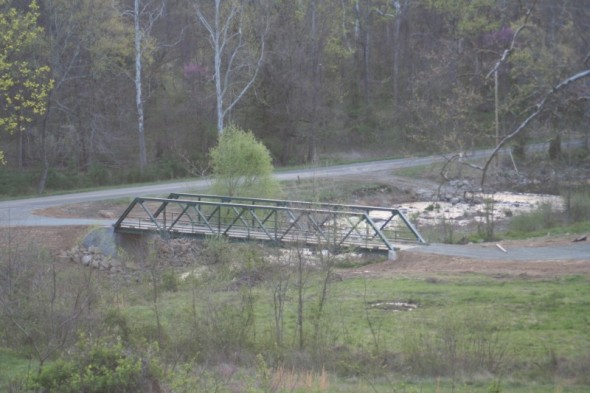

Can't you just find out who built it from VDOT and get the ultimate load rating from the original plans. I bet CBI must have cranked out a million bridges that looked like that. All the girders are standard shapes.
Hey, Is that bridge in Madison county?

Renze, You gave very good info. Curiously, today on NPR (National Public Radio) there was an engineer going on and on about steel fatigue, elastic limits, stress risers and on and on. It was fascinating but I wondered what percentage of the audience stayed awake.
Anyway there is an empirical way short of destructive testing (we intend and fervently hope) to determine the bridges stiffness, its Hooke's law constant well before reaching the elastic limit.
Flexure causes fatigue. Small flexes can be repeated virtually infinitum with no deleterious effect. Large flexures (like bending a coat hinger tightly to 90 degrees and straightening it out again a few times and noticing how easy it is to break it in two)
Somewhere in between the small repeatable ad infinitum flexures and the large clearly damaging flexures there is a point reached where small flexures over enough repetitions will cause failures. Before this was well understood, as well as we do now, (new understandings of metal fatigue has within just the last couple years radically changed the understanding of this phenomenon and the way it is studied in engineering schools strength of materials classes.)

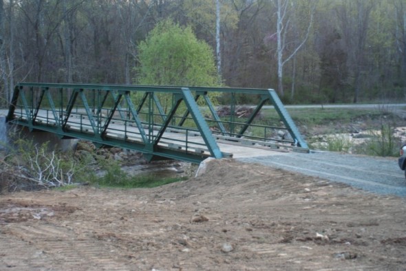

Anyway leaving history, and philosophy behind what do I recommend. I recommend that the bridge be supported where it was designed to be supported and that you instrument the bridge, i.e. put some dial indicators in the obvious locations and then add weights to the bridge to see how much movement you get. Since you don't know the alloys used or how much has been corroded and sand blasted away over the decades it is difficult to estimate the bridges performance. I recommend that instead of having everyone guess at the number of angels dancing on the head of a pin that we get a magnifying glass and count the little buggers!
Support the bridge up off the ground and put some dial gauges on it (like under the center of the span etc.) and load the sucker up and see how much it flexes. It shouldn't cost an arm and a leg to get an engineer to cooperate with this experiment and help you interpret the results. Then you will have some real data instead of a bunch of us guessing at values with no basis in fact for our comments.
I am reminded of the guy who didn't want to pay for an expensive operation so he paid a guy a few bucks to retouch the X-rays and make everything look good.
Bad economy!!! How will you feel if you avoid paying an engineer, save a buck, and have the bridge collapse and injuusr or kill someone. All you need is one lost and confused ready mix cement truck driver drive across your bridge...

Patrick_g, the stiffness of the bridge isn't the big issue. The strength is. You can't directly figure out the strength of a structure from its stiffness. For one thing, all common steels all have the just about the same elastic modulus, although strength varies widely. Fatigue damage is related to the ratio of cyclic strain to ultimate strain, not deflection. Bend thin sheet metal and a thick I beam through 90 degrees, the I beam will have much more strain at the extreme fiber.
   / Building A Bridge #67
I will not go into this in great detail as there is a zero WIFM index. If there is doubt about the strength and the bridge for some reason would flex too much for comfort at the intended weights then one simple cure is to put more supports under the bridge so spans are reduced.
The stiffness experiment was not intended to derive the strength of the bridge. It is a cheap, simple, and quick way to attempt to see if you can show the deflection to be so small as to not be an issue with the intended loads and strength of materials used. Who cares what the ACTUAL strength figure is so long as it can be shown to be sufficiently greater than needed?

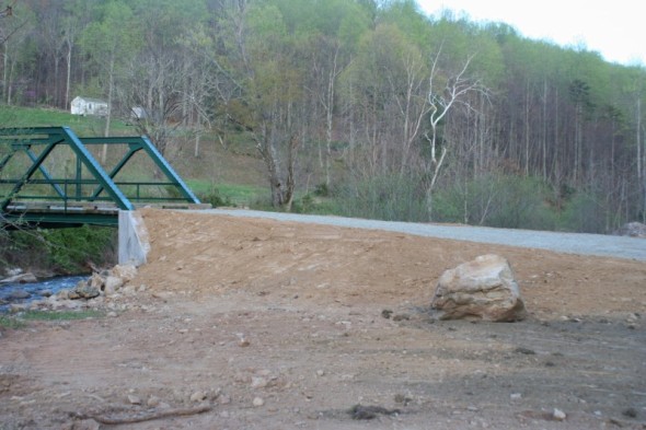

Irrespective of bridge strength, the supports have to be good enough or the system fails. I hired a PE consulting engineer a few years ago. He brought out a sub contractor and helper with a drilling rig. We bored a 6 inch diameter hole and took samples every 6 inches till we hit solid rock. The PE analyzed the samples in his lab and issued a written report with his PE stamp. He made recommendations for my foundations and drain systems. This was a three story structure with massive amounts of concrete and steel so I wanted to build a foundation from a position of knowledge not good ole boy guess work.
The total cost of the engineer, report, subcontractor, the whole enchilada was less than $1000. This included designing various drain systems and the foundations. My liability DOES have access to his E&O insurance.
This was a bargain. The engineer was a professional in high demand. I got him through recommendations from the civil engineering firm I used. When I asked them to do the work they said it was out of their comfort zone (firm owner was PhD in civil engineering with several staff PE's) and they gave me the contact info for the consulting engineer they used. The point of this is that you can hire good help at reasonable prices. Your insurance company will be pleased if you get a PE to design the bridge supports and test the sub soil so the supports can be tailored to reality and not a one size fits all good ole boy estimate approach.
