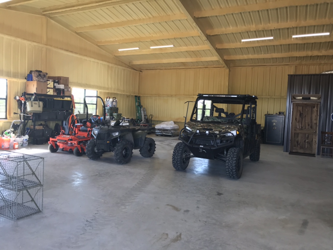

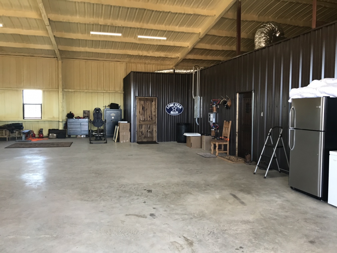

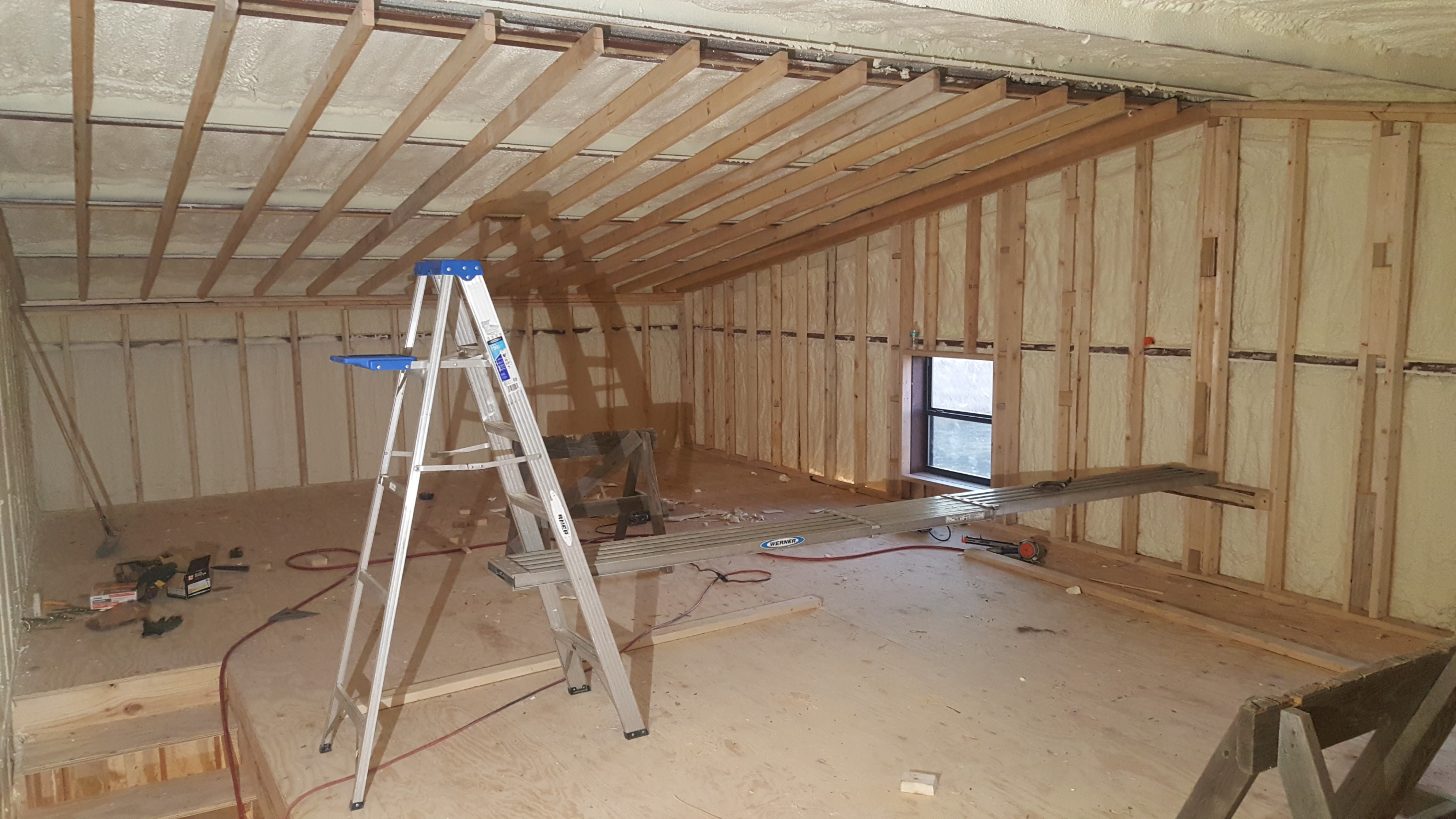

That closed cell is nice stuff. How thick did you go on your walls and ceiling?
/ Building a barndominium
#63
Started framing the upstairs false ceiling. I sandwiched a 2 x 6 between the metal roof purlin and an additional purlin at the peak and middle of the roof before insulation was sprayed. The 2 x 4 rafters are screwed into these 2 x 6's

Framing is almost complete but progress is slowing down because of other projects and to let the bank account refill.
/ Building a barndominium #65
Yeah, that spray foam is pricey but well worth it in the long run! Looking good!

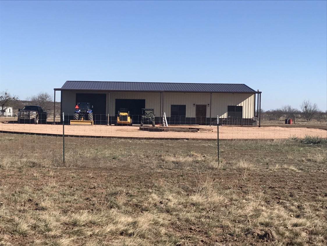

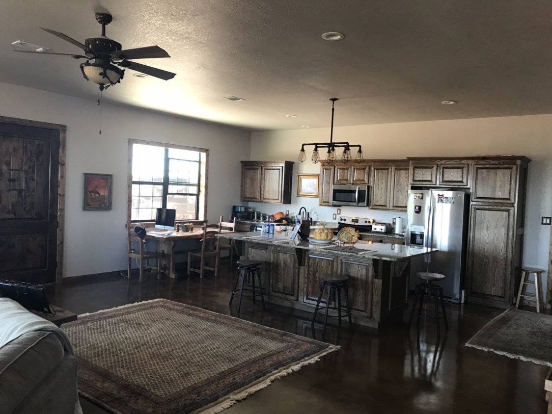

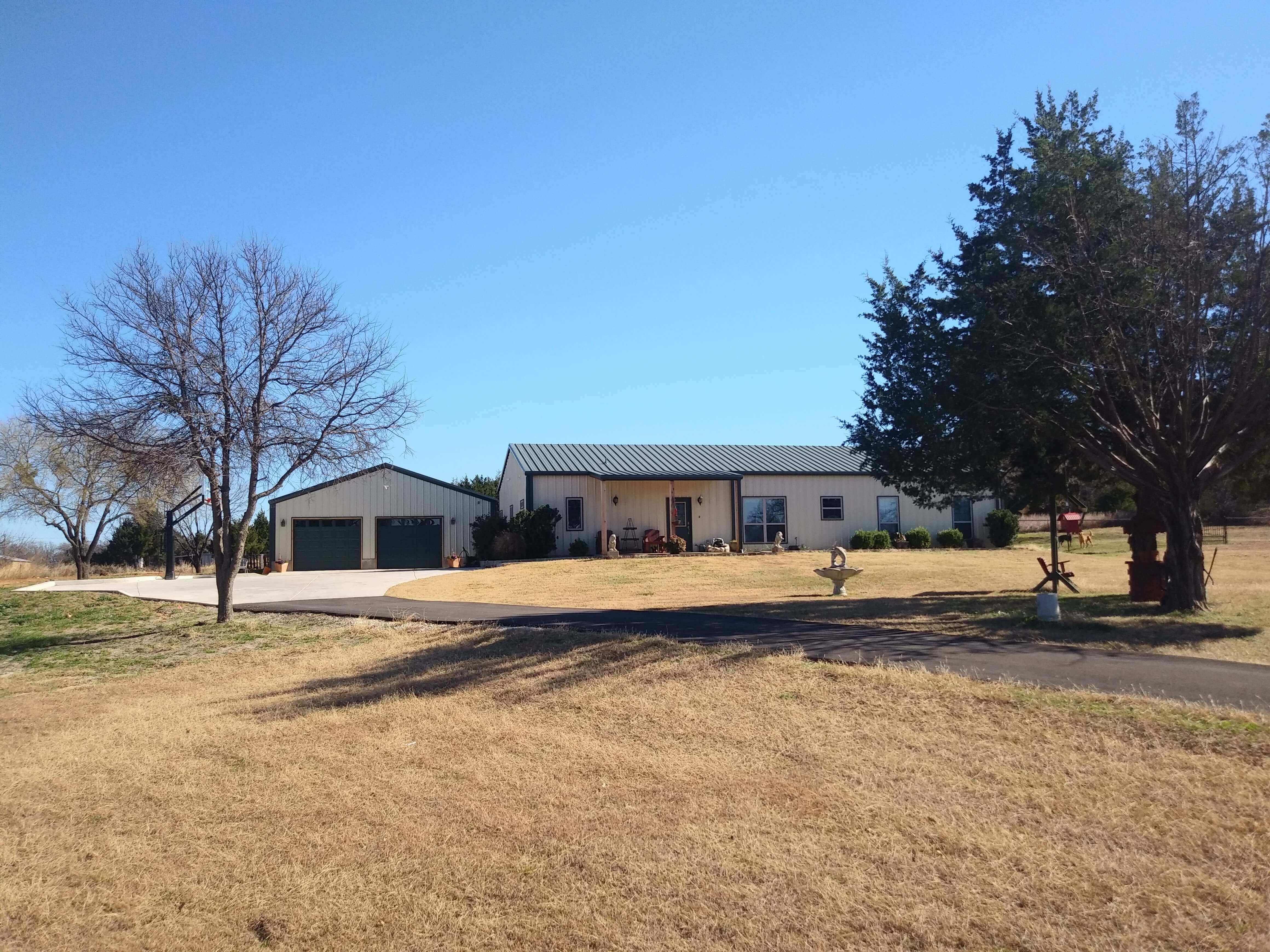

/ Building a barndominium #66
Real craftsmanship there! We built our steel building, barndominium style house in 2011. Added a metal building detached garage in 2018.

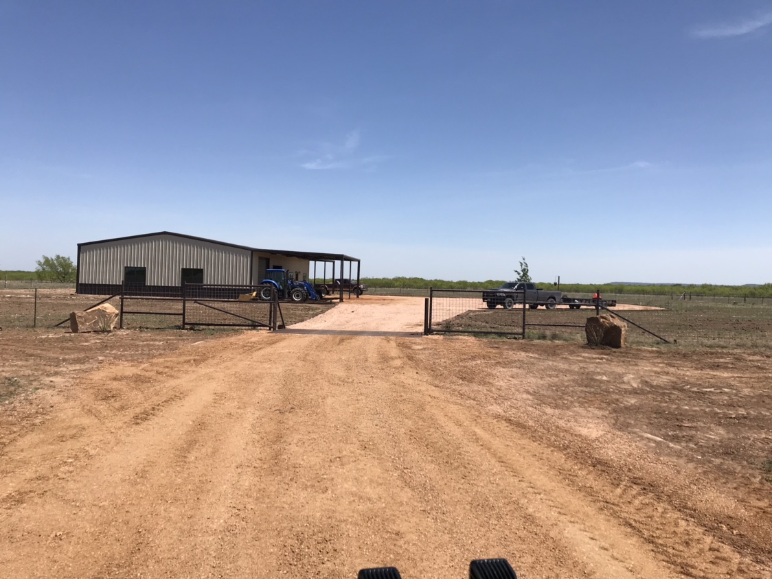

/ Building a barndominium #68
Welcome to the club. These barndos make a lot of sense and are a great way to build in the country. Love mine, 80x50, 14’ walls. It’s perfect.
