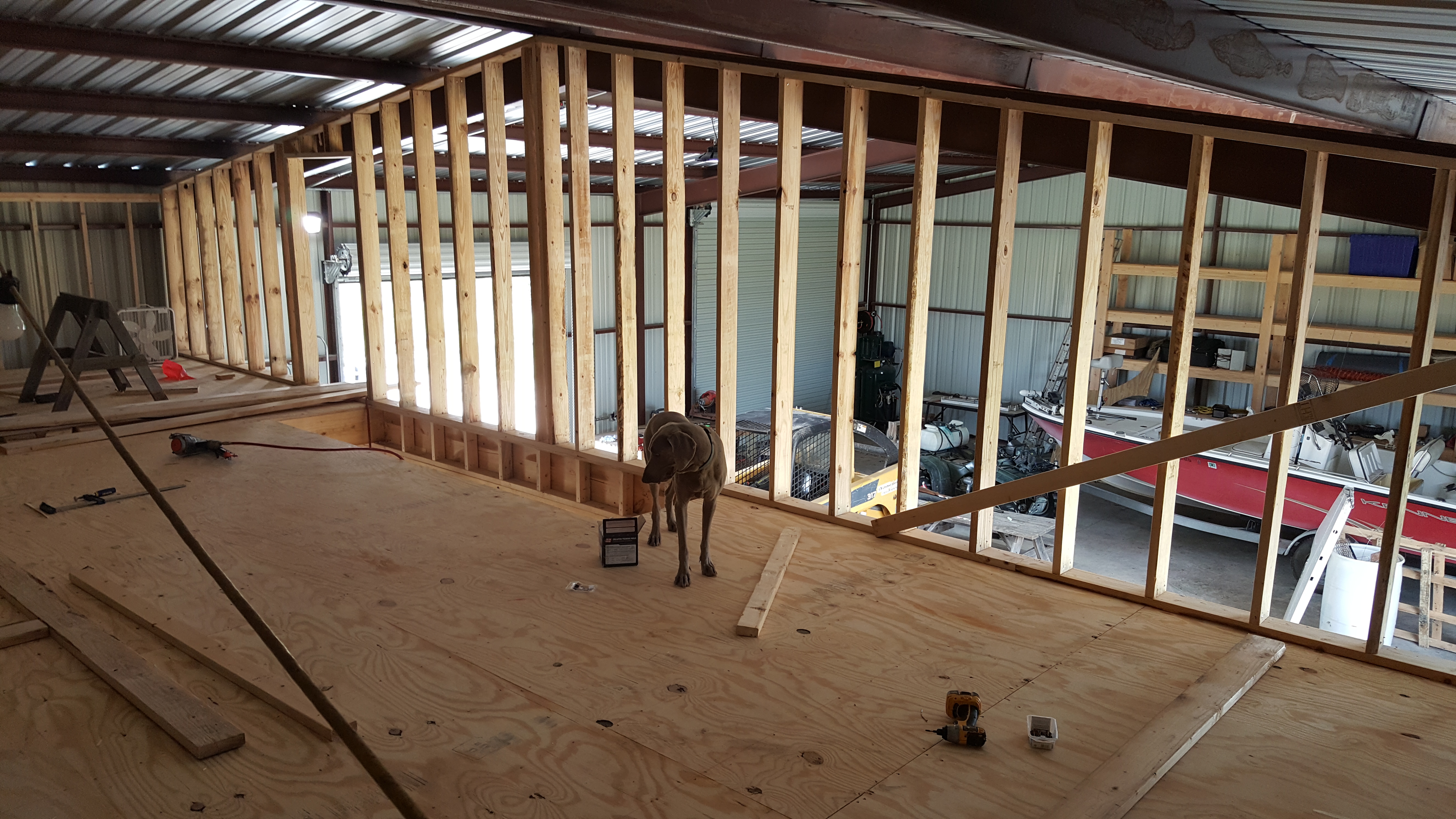

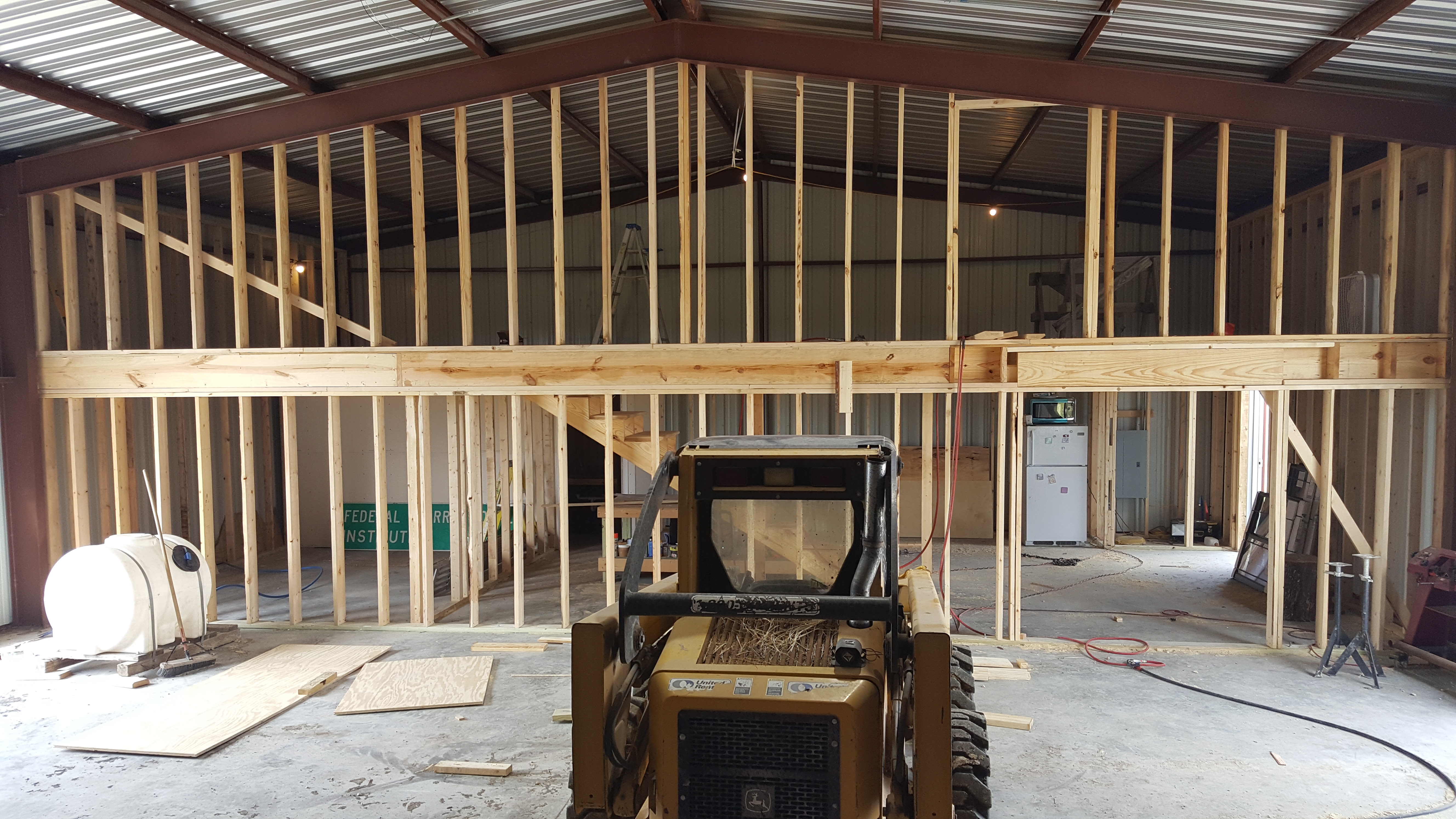

Started framing the upstairs false ceiling. I sandwiched a 2 x 6 between the metal roof purlin and an additional purlin at the peak and middle of the roof before insulation was sprayed. The 2 x 4 rafters are screwed into these 2 x 6's

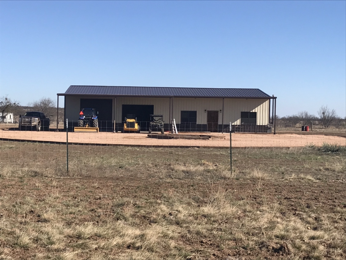

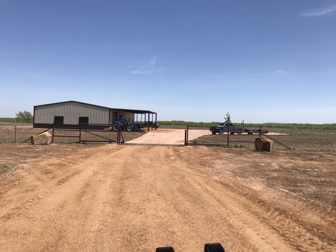

Real craftsmanship there! We built our steel building, barndominium style house in 2011. Added a metal building detached garage in 2018.
