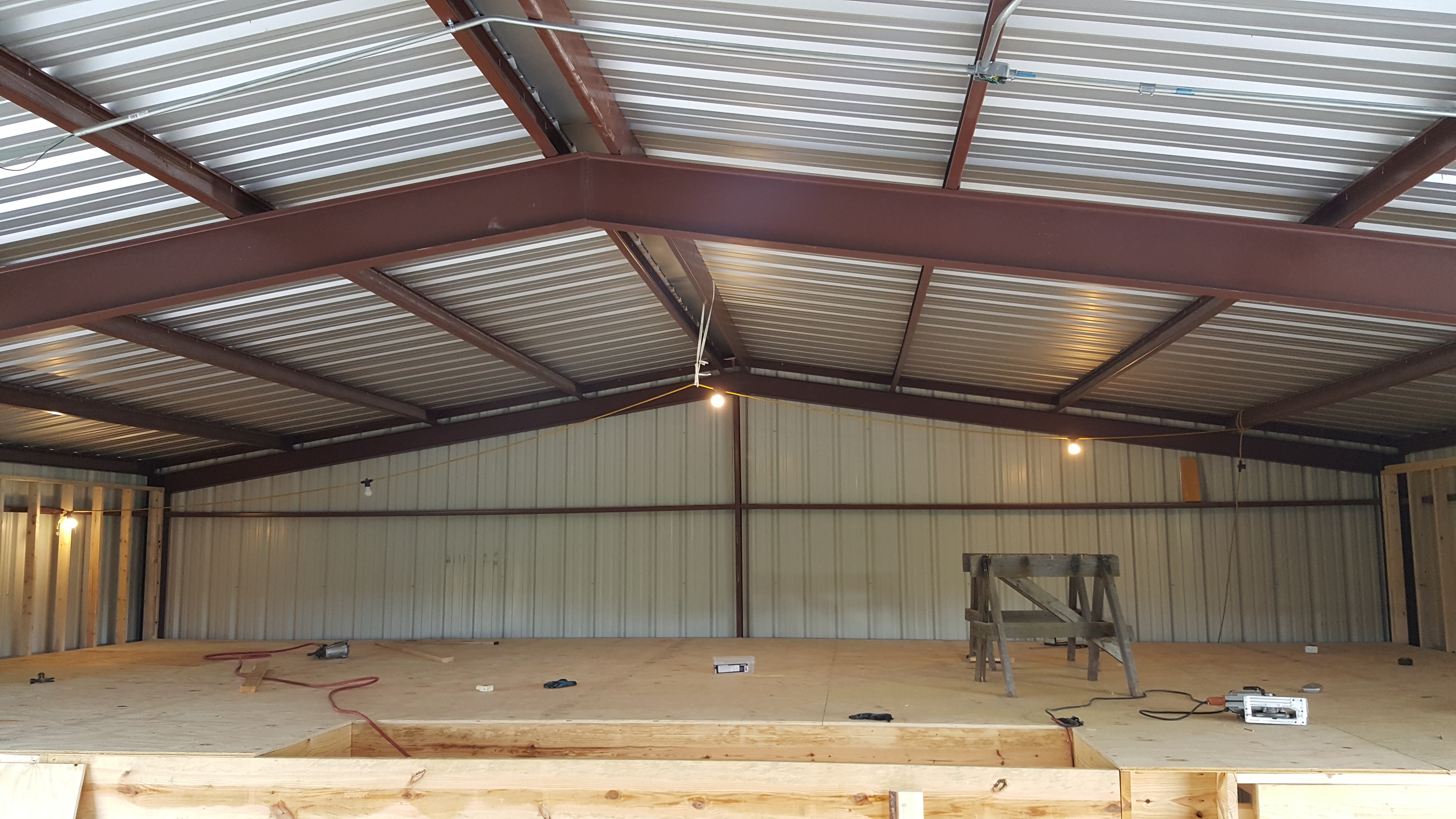

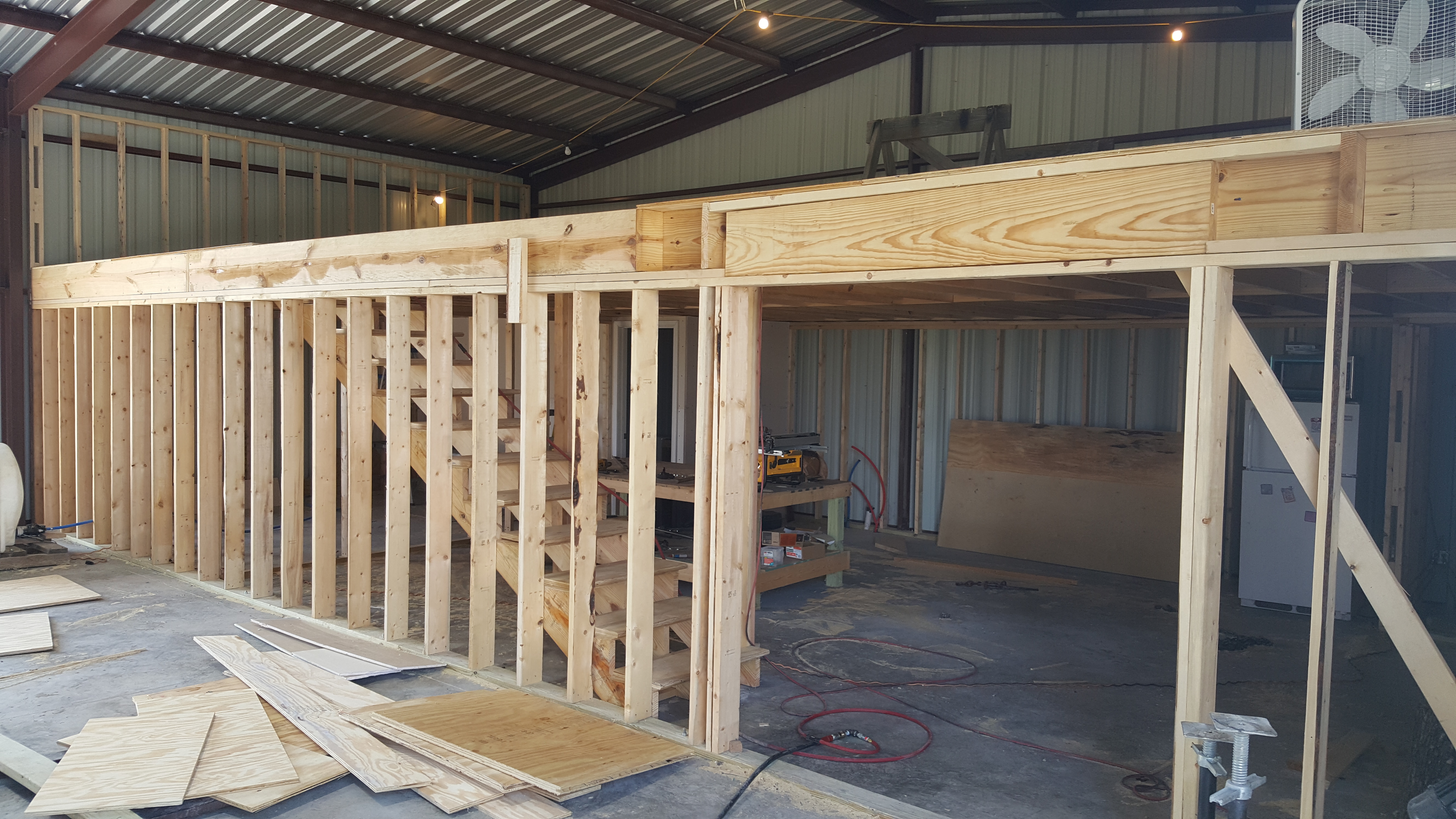

Making some more progress framing the second story.

Looks good. Any plans for windows? I see what looks like a 2nd floor door, egress?

Nice work!
What are your insulation plans?
I'm going to have closed cell foam sprayed after I'm done with plumbing & electrical. Depending on how expensive it is, I'll either have it all closed cell foam or a layer sprayed directly on the metal and then fiberglass batts.
Windows are next on the list. One in each upstairs room and two in the living/kitchen room downstairs. 2nd story door is to allow usage of the fork lift to put stuff upstairs in the future when it's just storage.
