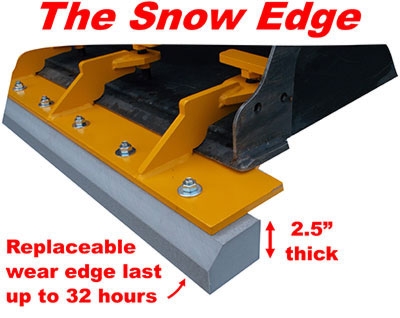

I tried the pipe routine and failed ...... Then I went with a snow edge with no regrets. This year is the fifth season and the wear edge isn't near half worn yet.

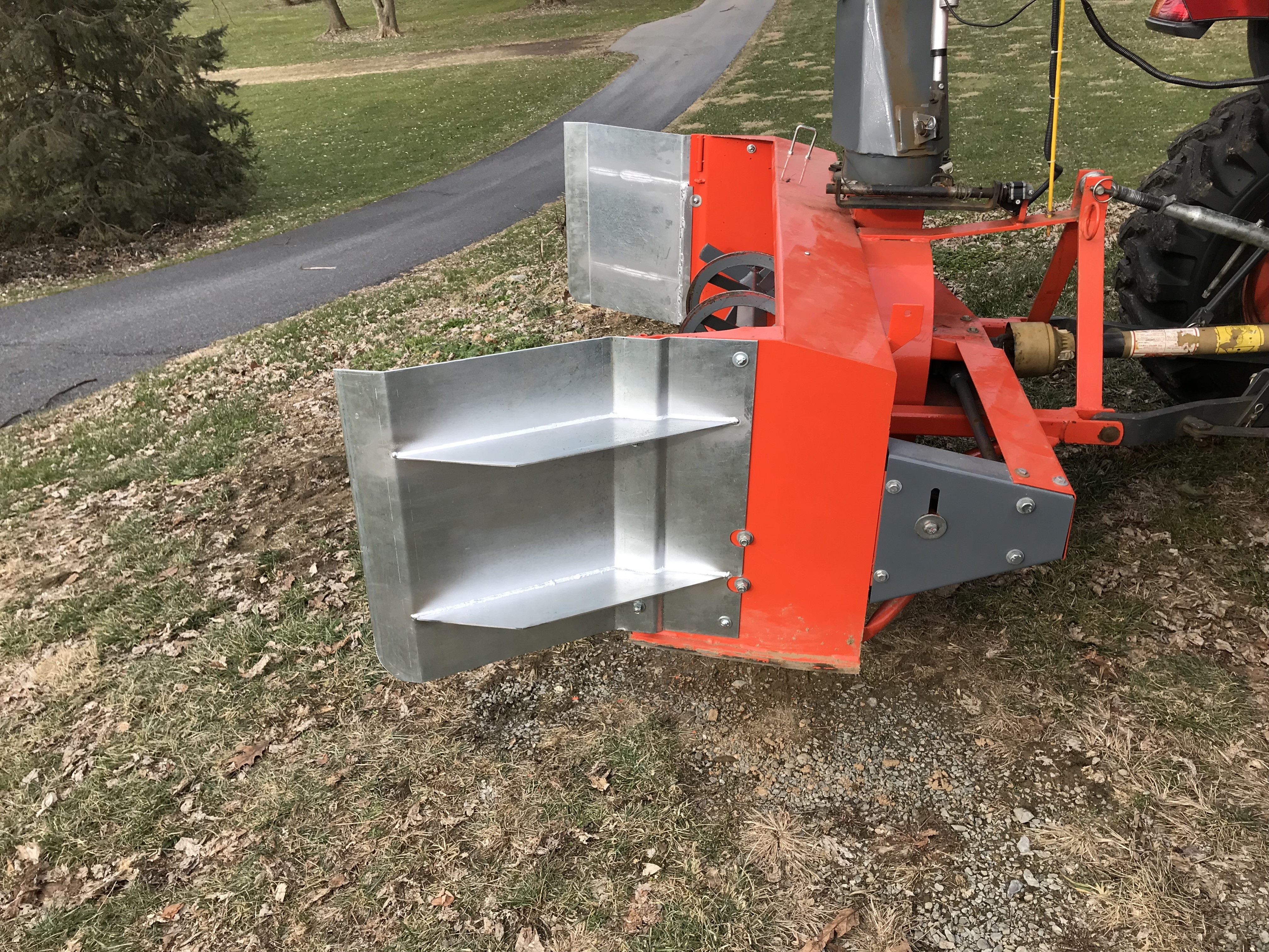

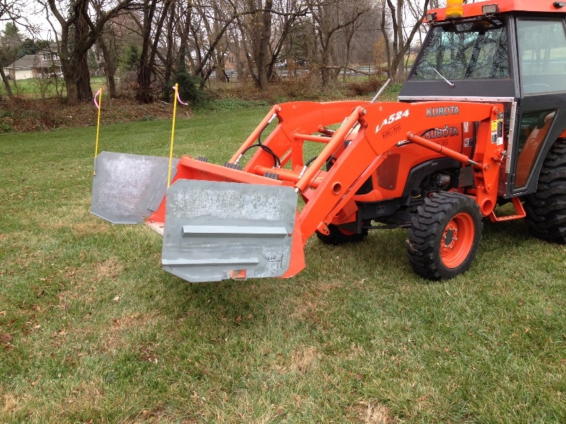

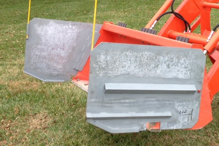

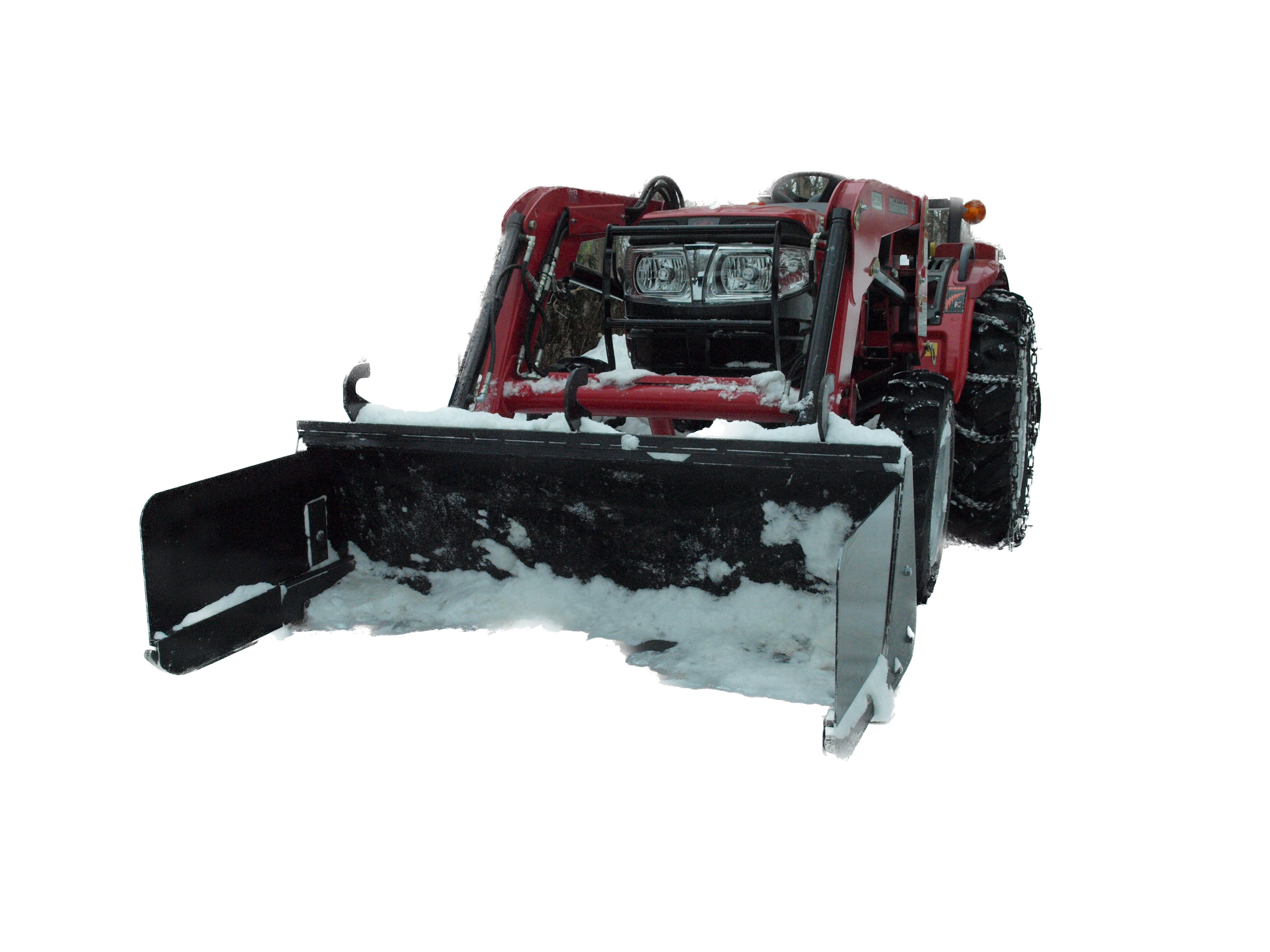

I did some wingy things for a bucket and a blower in the past. Worked OK but gave them up after mounting an 8' power angle blade on the L4240.

Saw a couple clips on YouTube. No experience with them. They put the blade pretty far out in front.

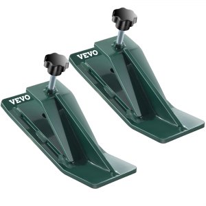

These are cheap Chinese knockoffs of R2 Manufacturing's EdgeTamers; EdgeTamers are great, but I hate to see the damn communists stealing American products and under-cutting them at every turn.

I bought the Vevor on clearance, $39. The clamp on bolt was too thin, not hardened, and bent like a cheap folding table. I contacted Vevor, they gave me $20 back. I bought grade 8, 5/8" bolts for $10 shipped, tapped the ski, welded grade 8 nuts to ski, and it is now what it should have been. I only use until gravel driveway freezes up solid. I have EA toothbar on, and use that to dig into snow/ice when it gets built up on driveway.
I forgot what cheap crap Vevor makes. 2nd time for me...
But they do make it right, or at least acceptable.
Bought 3 edge tamers for my 72 inch LS front loader bucket about 3 years ago , don’t use them a lot but when I do use them they work great, I highly recommend them. The one bolt mounting system is great, very quick and easy to mount or remove with a 3/4 inch ratchet !
