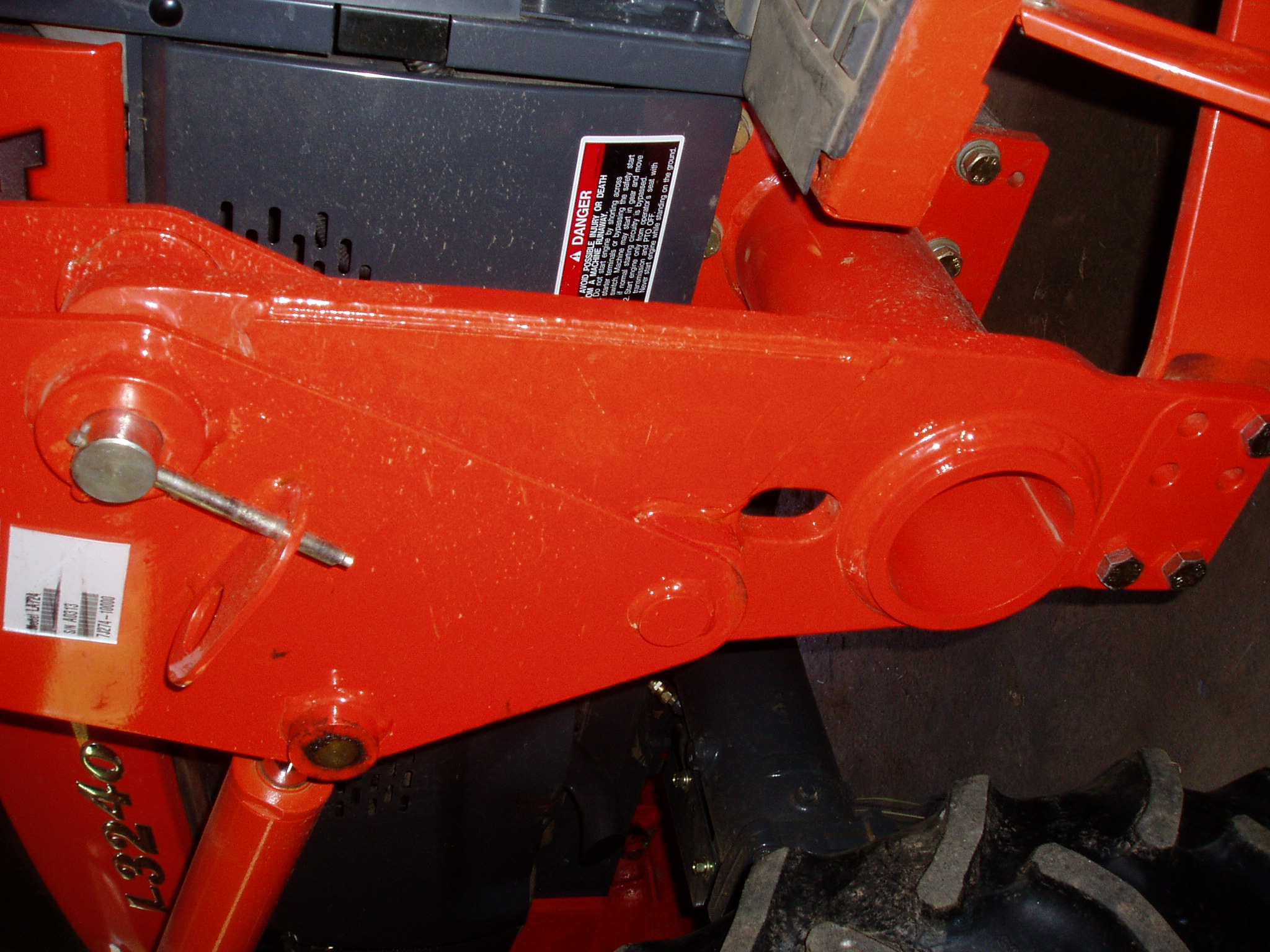

After taking a closer look at the design of the pillars, I've gotta say I think it's a design problem. It reminds me of the Deere loader setup on some of their smaller tractors, like the 2305 for example.
Mine (about the same HP and a LOT less loader capacity), is a bent steel U-channel that the loader fits into. I really don't know the reasoning behind building a loader bracket this way, but I think it's on the light duty side of the fence for a tractor with that much HP.
Any side load at all is going to put some stress on that cast steel structure that it's not formed to take.

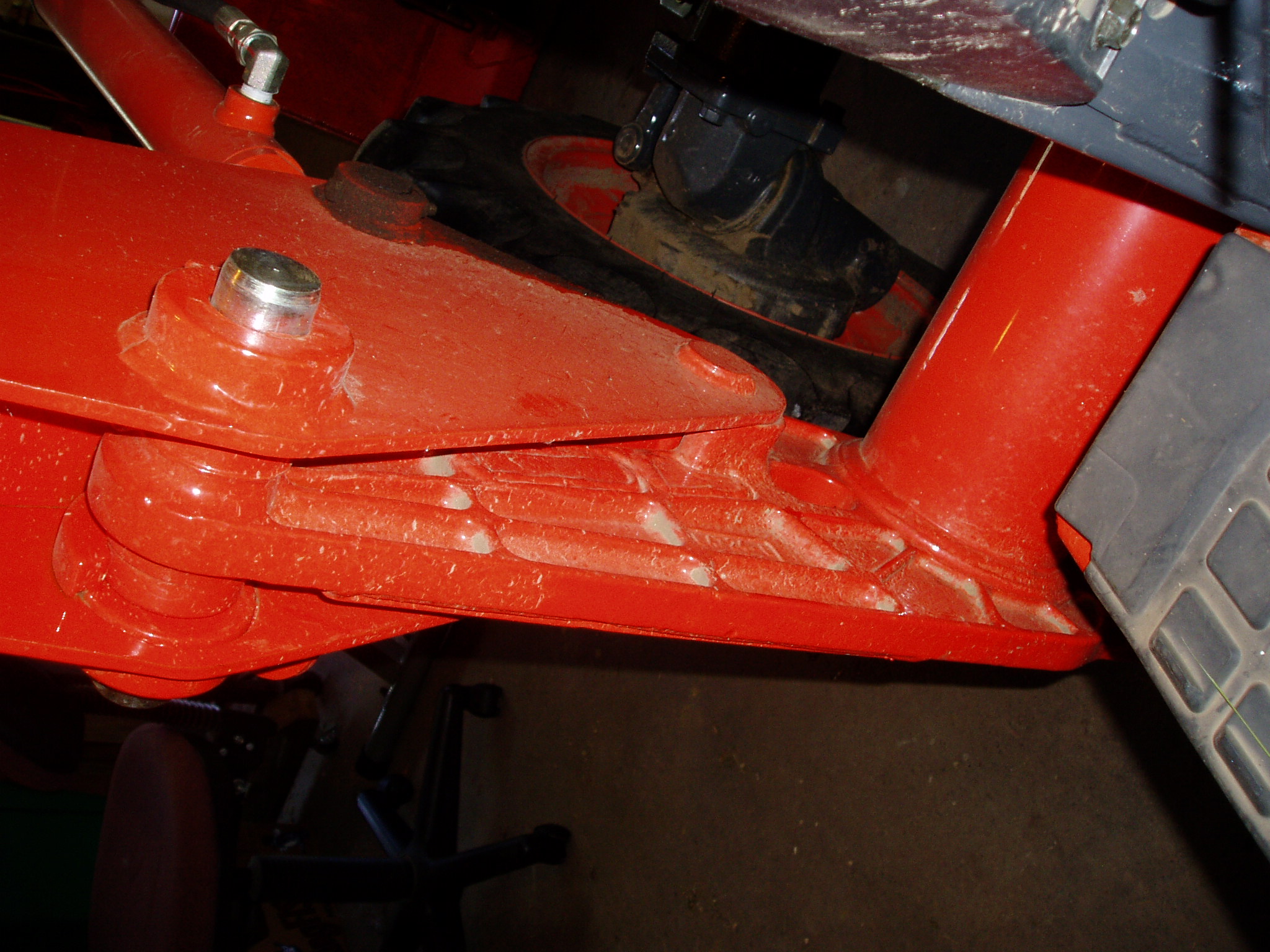

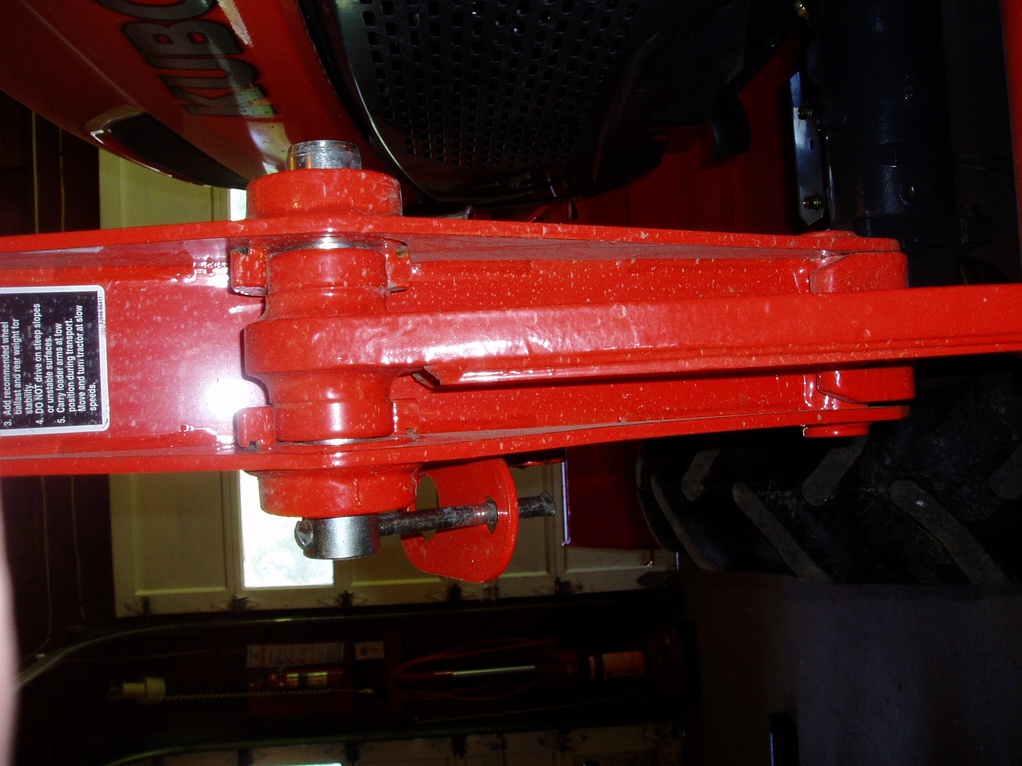

Strange ... looking at the OP's original photos ... and then at my FEL, which was bought in July 2007, there appears to be a difference. My cast uprights have a heavy (sheet steel?) "flitch" plate, 3/16 or 1/4 inch thick; filet welded to the web of the casting. This reinforcement runs almost the full width of the upright and extends almost a foot vertically. I don't see any evidence of it on the OP's, or maybe I just can't see it?:
I may have to eat crow about Kubota wringing out weight without going overboard ...
Kcender, does your FEL have these plates, and is it newer than mine, or older?
