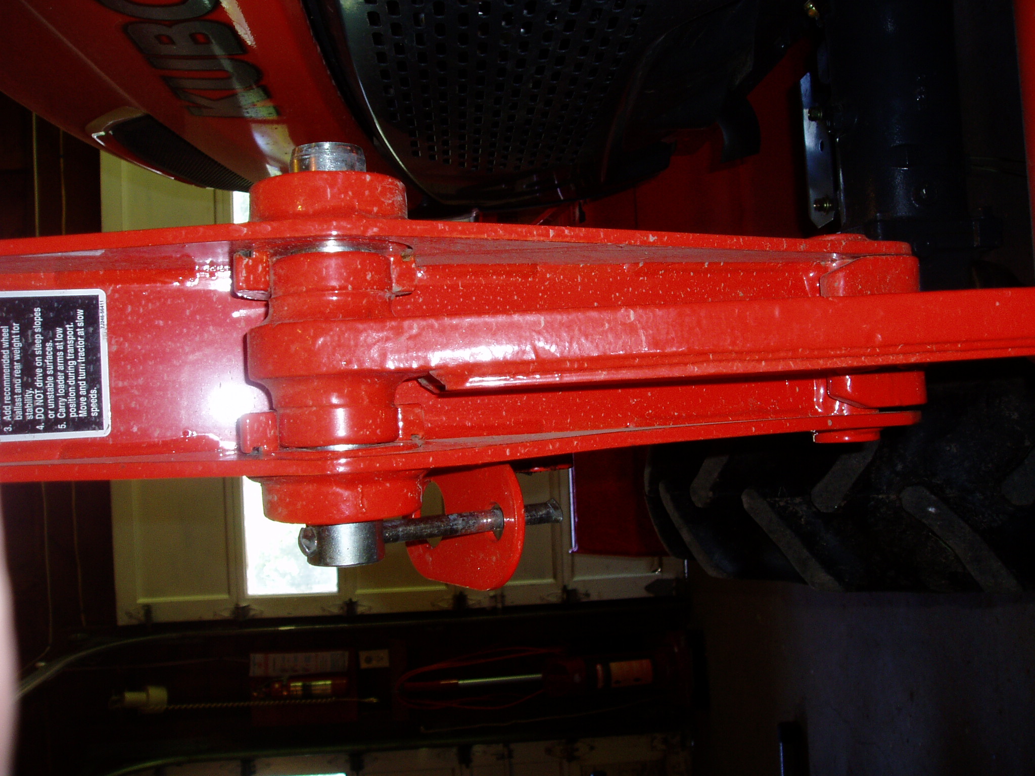

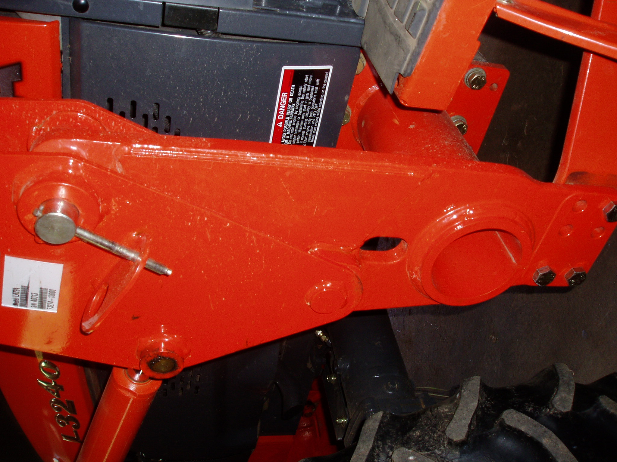

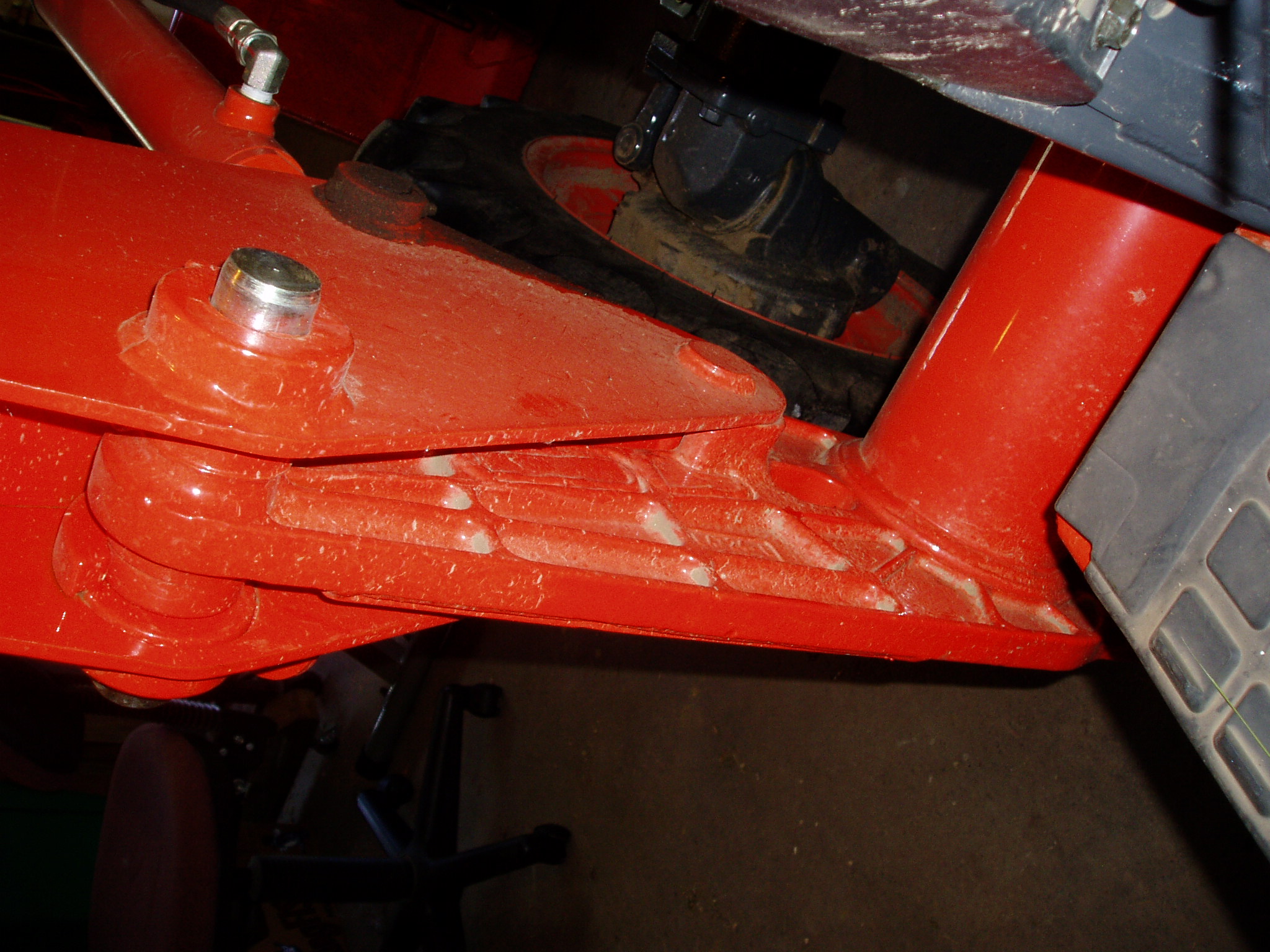

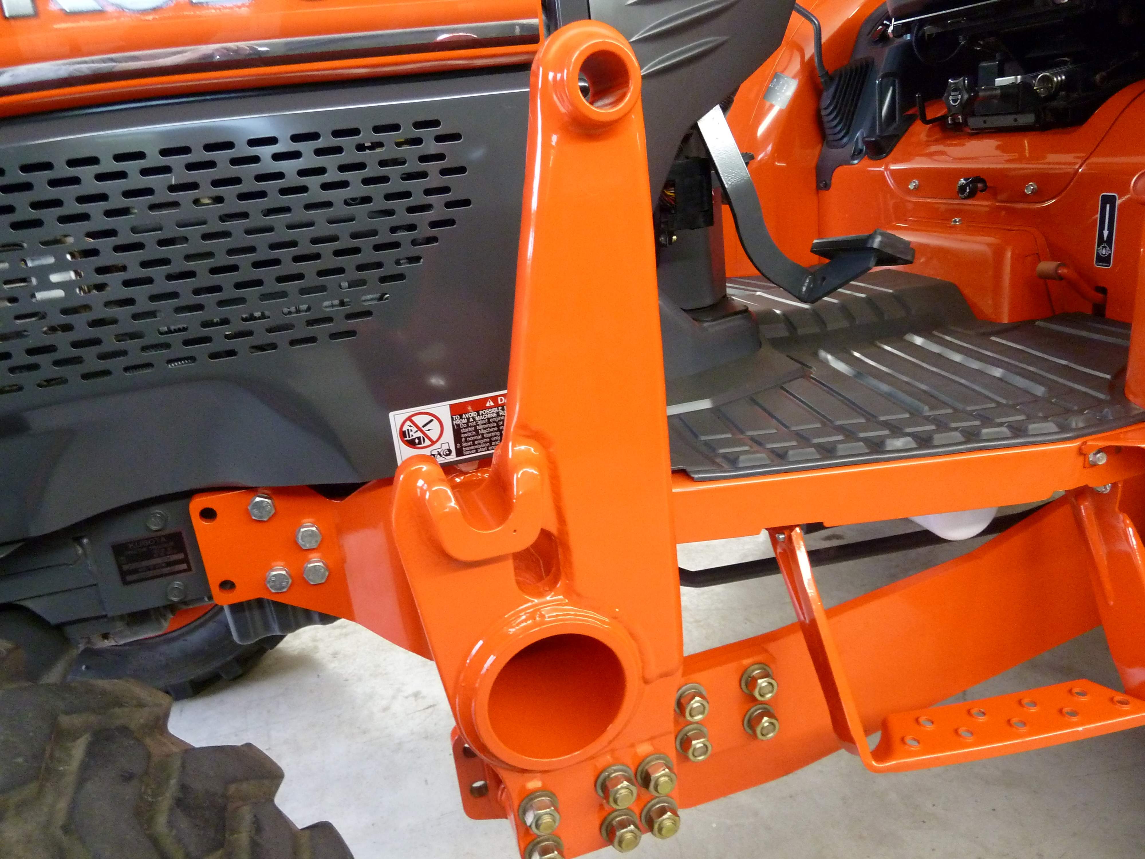

Just got my brackets back from powder coating.It was a bit of a wait but the powder had to be ordered in.The colour is Chevy Orange and matches quite well.The dealer dropped off the brackets and gave me a hand getting them up in place and the bolts started.They could have been installed under warranty but I didn't mind doing it.I torqued all the bolts to 166 pounds as stated in the manual.Thought I would add a few pictures.I added a 1/4" plate to both sides of each bracket which should make them considerably stronger than they were.Time will tell.

First, holy crap your tractor is clean! :thumbsup:
Second, the brackets look great. Chevy orange matches just fine; I wouldn't have known it wasn't Kubota orange if you hadn't posted that it's not.
Third, do you think you'll do anything different, as far as sliding the loader on the ground with the BH, etc.?

First, I will second the "holy crap your tractor is clean"!:D
Second, I will say that is one of the best looking support bracket addition I have seen in a long time. Maybe it's the paint job but I don't think so it surely looks professional. Thanks for the pictures.

Holy crap - your tractor looks brand new! What do you move with that thing, laundry detergent? Nice looking masts, by the way. I like the full radius around the leading and trailing edges. I think I can state without reservation that kcender now has the LA724 loader least likely to fail a mast.

Glad everything worked out for you. Those brackets look like they came from the factory that way, you would never know they have been modified. Very nice.

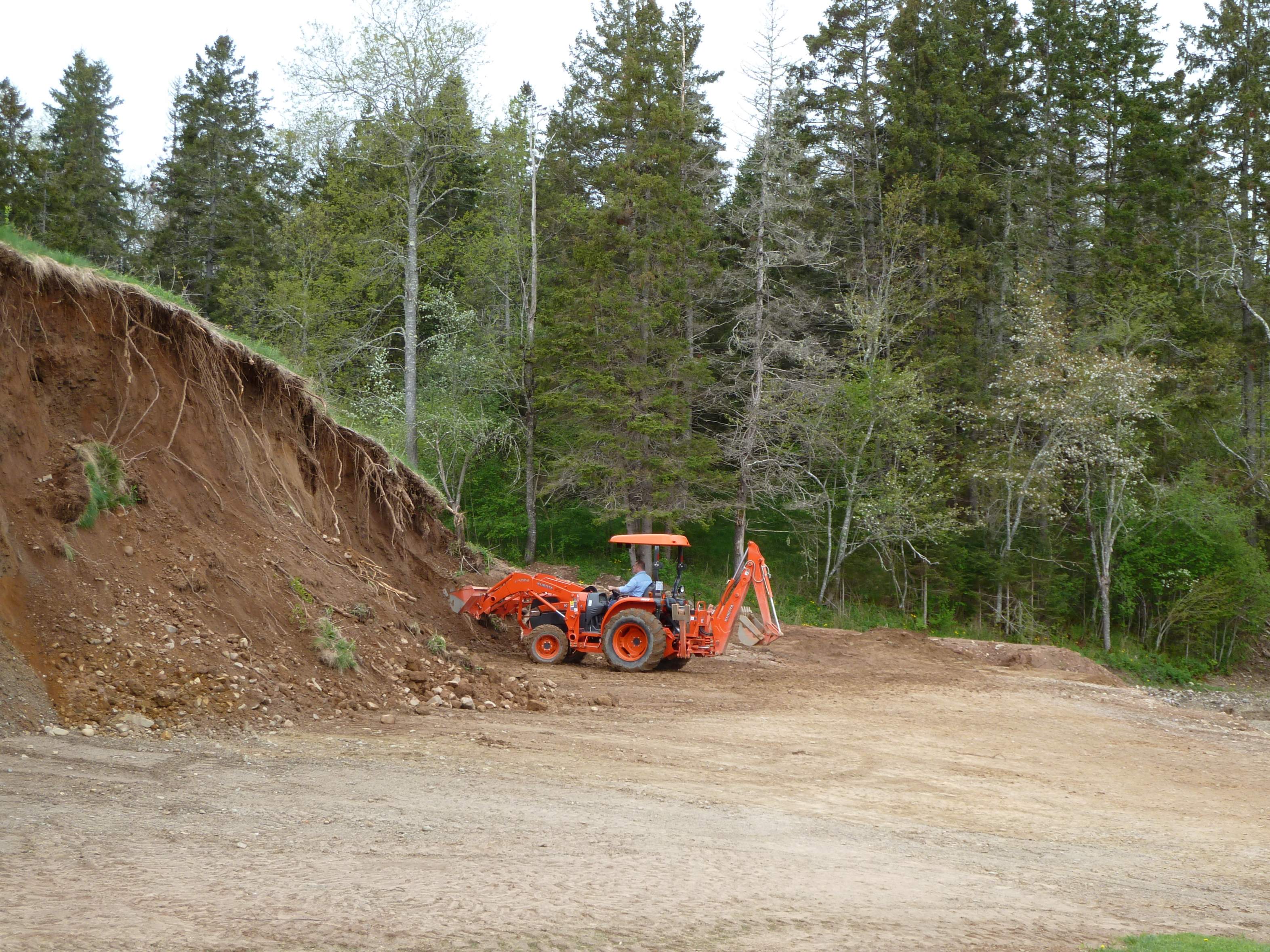

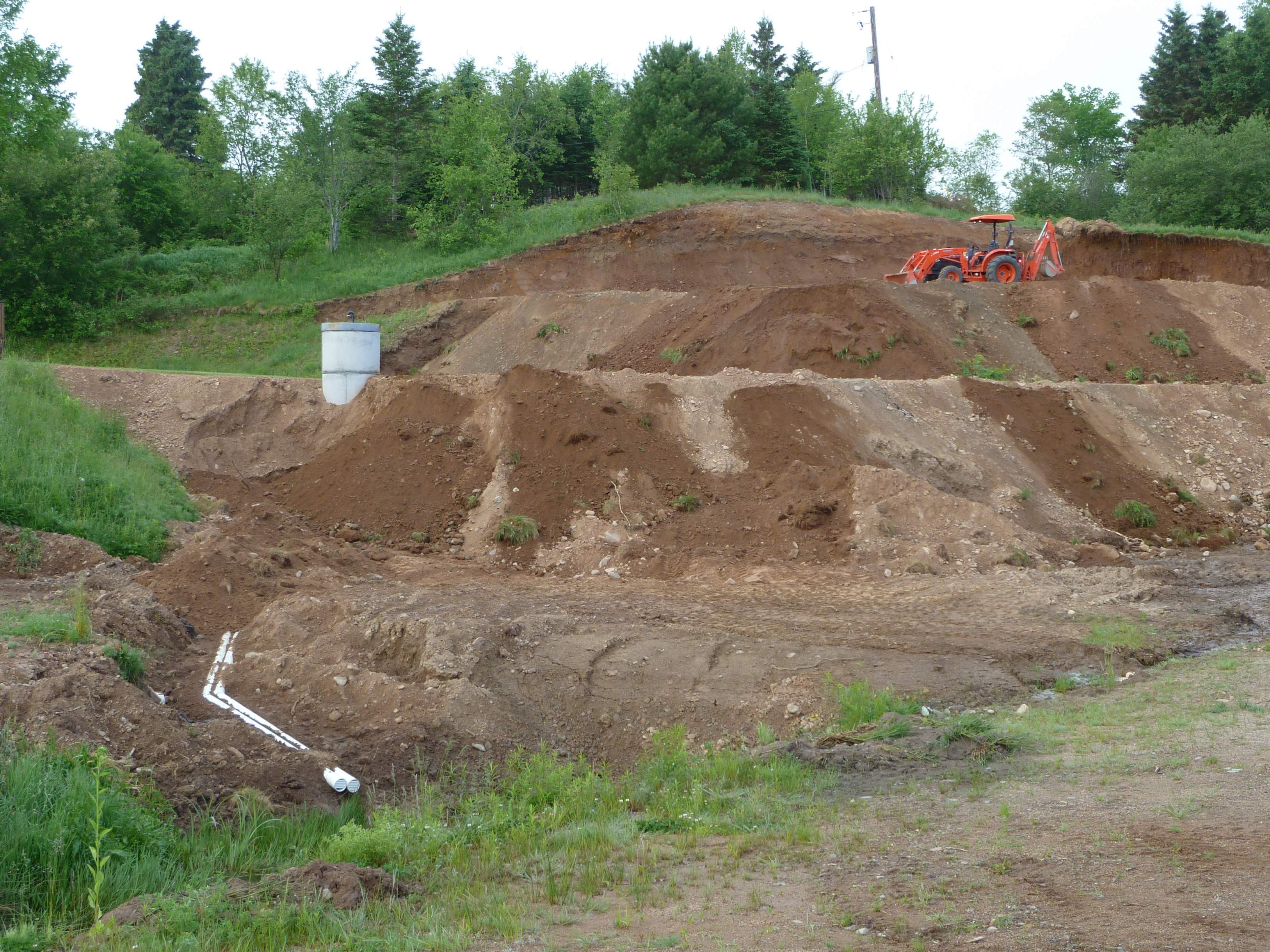

Thanks for the kind words.I only use the tractor to move laundry detergent once a week on laundry day:laughing.The other times I use it to level off my property.I am currently leveling my back yard which is where the bracket broke.I have added a few photos of it.

I have to say there looks to be enough work there for half the members on TBN.;)

I was wondering how you had accumulated all those hours on a 2010 machine - mystery solved. You are doing civil engineering on a scale that I never would have thought to try.

Level it? That's a play ground.
