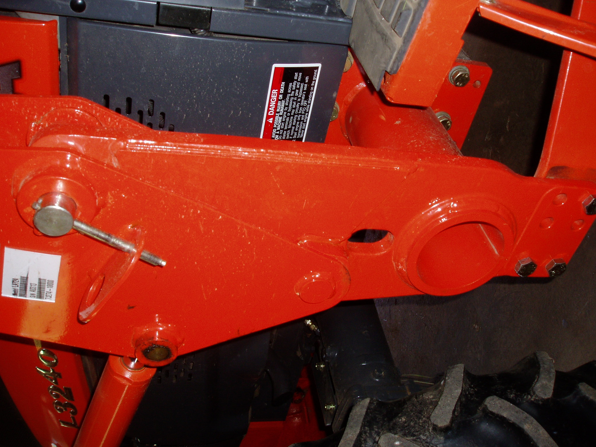

They look like yours. Solid on the outside with a pattern cast into them on the inside. No plates welded on.
My GL3240 w/LA724 purchased the fall of 2008 also has no extra plate welded, just the castings. If Kubota made a loader mount design change it had to be over two years ago as my tractor was built in early 2008 and sat on the dealer lot for 6 months when I bought it.

#66

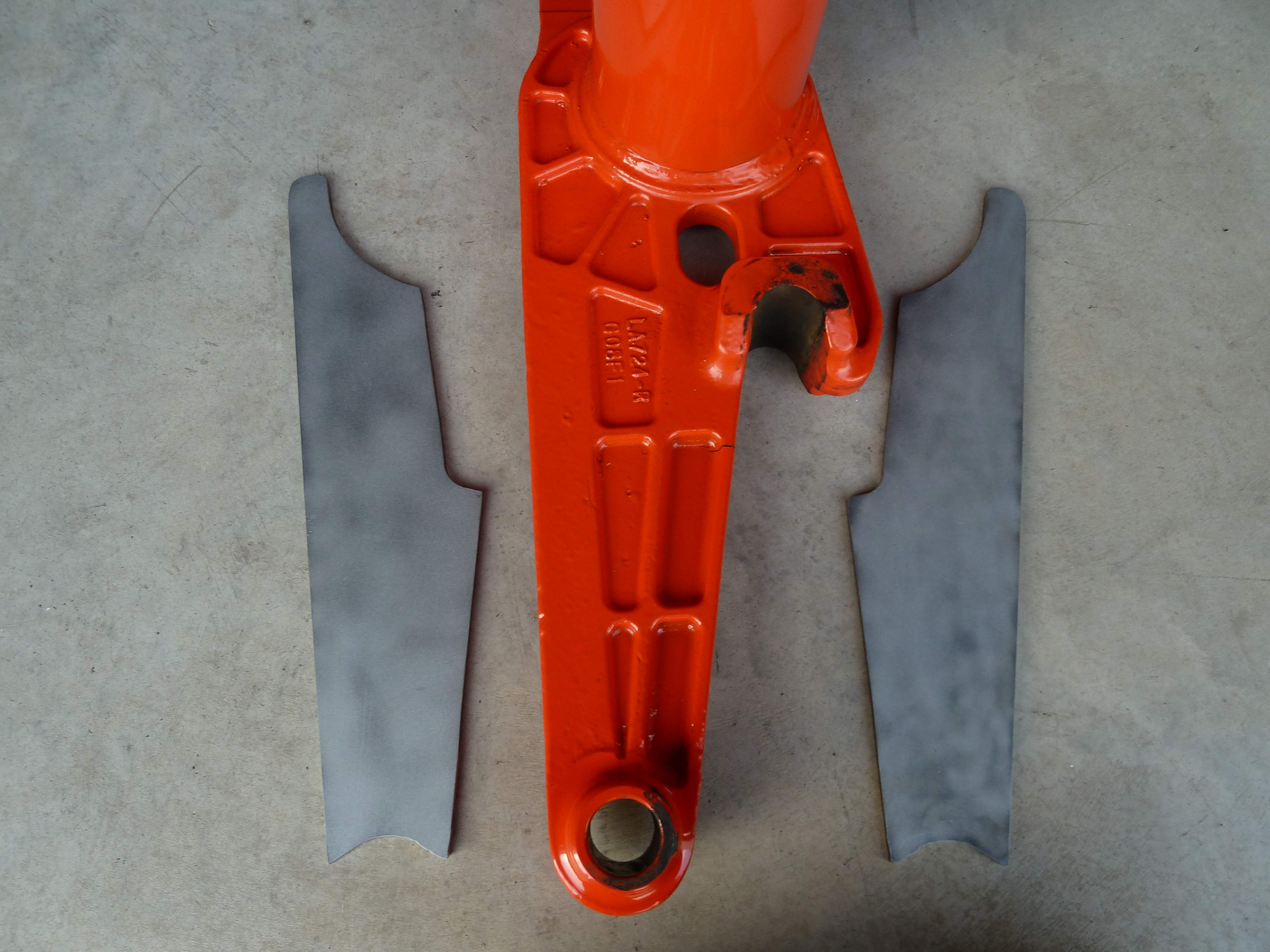

I don't know when they stopped putting the reinforcing plates on the brackets but I do know of one 2010 L3240 that will have the plates.That one is mine as I just finished making the template for them and will get the plates cut out tomorrow.I am thinking of 1/4 inch plate welded on both sides of the bracket.Some people will probably say that if I make that area stronger it will just break somewhere else.Maybe true but after studying this whole loader assembly,I definitely think these brackets are under built and are the weak point of the whole assembly.I am certainly not an engineer but I have worked around steel long enough to know a few things about it.I will add the plates regardless if Kubota replaces the brackets or I have to repair my own.I normally have quite a bit of faith in Kubota quality but this is one instance where I think they could have made a better product.:2cents:

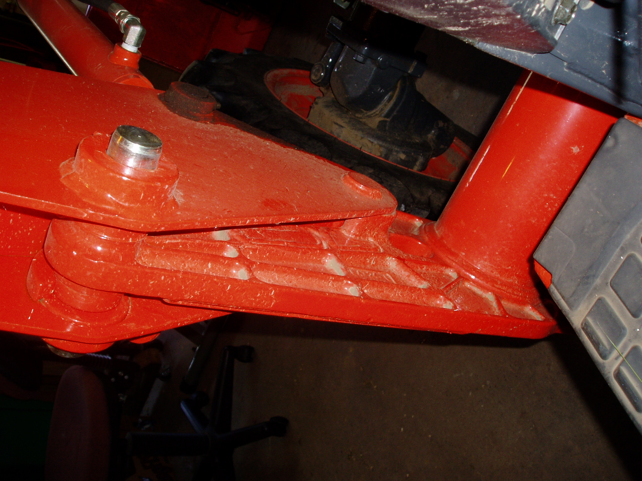

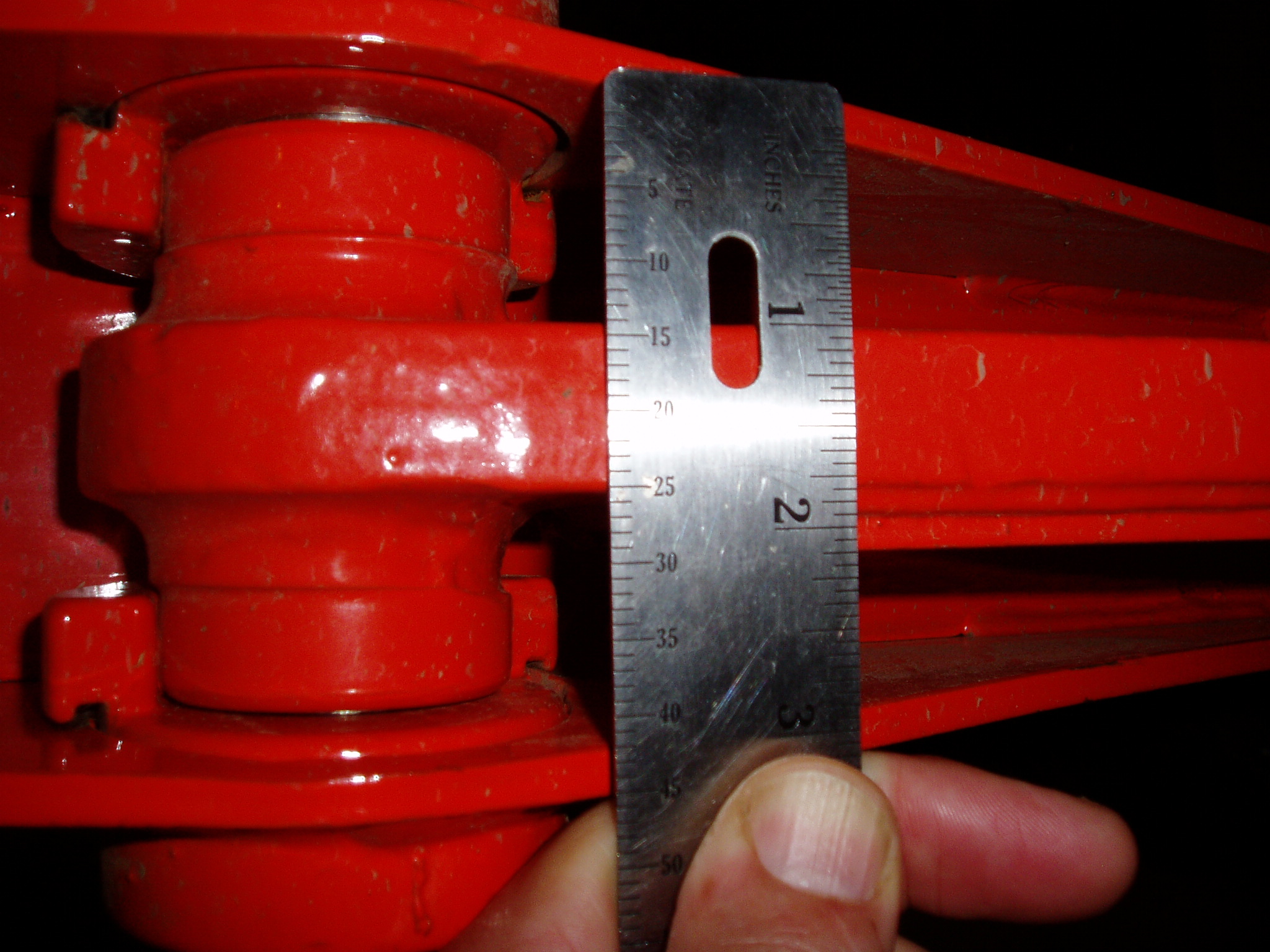

Kcender,
I'm currious as to what the design change was, exactly. Being a designer of castings, myself, my prime suspect is that the amount of long welds on the plate were cost prohibitive for manufacturing, and someone in a kwality circle or a cstcttng team got a paltry bonus or company coffee mug for eliminating it. My suspicion further suggests that this was accomplished by thickening the web of the casting to provide a similar dimension to that of the casting + plate.
Could you humor an obsessive design engineer and take a measurement across the thickness of your part? From the attached pictue I have a casting thickness of 7/8" with a 1/4" plate filet welded onto the web:
Thanks. Oh, happy (belated) Canada Day, by the way!
-Jim

Kcender,
-Jim

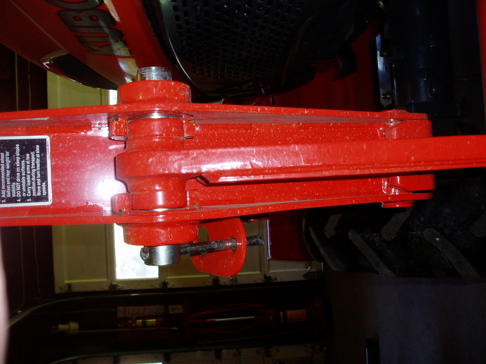

Kcender,
-Jim
I just measured my bracket in the same spot as you show,it is also 7/8".From what I can see from your photos the web pattern from the casting is different on mine.Where yours is showing three depressions across the width
of the bracket,mine only has two.The third area is full thickness from top down quite a distance.It appears there was a slight change in the casting process to compensate for the lack of a welded reinforcing plate.Whether this is good or bad is debatable,I personally would prefer to see the casting process removed entirely from the fabrication of these brackets but I assume it is due to cost efficiency.I have added a couple of photos to help clarify.One shows the pattern of the webbing with the plates laying beside it that I have made to reinforce the bracket.The other shows how the plate will fit on the webbing side,it will be the same on the other side.I plan to reinforce the other bracket the same.

MHarryE-
Thanks for that information!
Kcender-
7/8" it is, then. I am kind of surprised at Kubota and I really think someone should lose their employee of the week parking space, or at least give their mug back. I'll be dining on Blacksbird Pie tonight.
I'm fully in agreement with you about not liking a casting for this application. To be frank, I only use a casting where a weldment or hog out is highly impractical or very expensive - shapes like an engine block or pump housing. As others have stated, this looks like a perfect shape for a weldment of bent up plates and maybe some milled forgings/bar stock for the loader arm attachment points. I think your fix looks like it should work very well and be much stronger than what you started with, new. It wouldn't surprise me if you get some requests to make a few sets up for others on this forum. Please show us the finished weldments as I always appreciate seeing a job well done in it's completed form and you certainly know what you are doing. Maybe someone at Kubota will feel appropriately shamed after studying your solution. Shame is powerful stuff.

I just got home from work to find Terry from my local Kubota dealership along with the regional rep for Kubota.The rep was anxious to see the brackets and said it has generated quite a stir up through the ranks at Kubota.Apparently they had never encountered this before and were quite surprised that it happened.He agreed to replace both brackets without question,saying it should never have happened and apoligized to me for it hapenning at all.Apparently he can find no record of any changes ever made to the manufacturing of the brackets but acknowledged the difference in the pictures of Baby Grand's tractor.He offered to try and get me these brackets but I told him I would prefer the original type of bracket so I can weld on the reinforcing plates.We discussed the welding of these plates and he thought it was a good idea.He has no trouble with me doing the welding as I am a certified welder but was willing to pay a welding shop to do the work if I had wished it.He also said for the dealer to have the brackets powder coated after the welding is done as that is how they are originally painted.They are going to try to find me a set of brackets in the system but if none are available,they will take a set off a tractor on the lot.As for the timeline,I broke the bracket Wednesday evening,my dealer came down to see the tractor Sunday evening on his own time[Friday was a holiday],and the rep came on Tuesday.The retail price of the brackets is over $1100 per side.I am more than happy with the response from Kubota and feel I couldn't have been treated any better.
