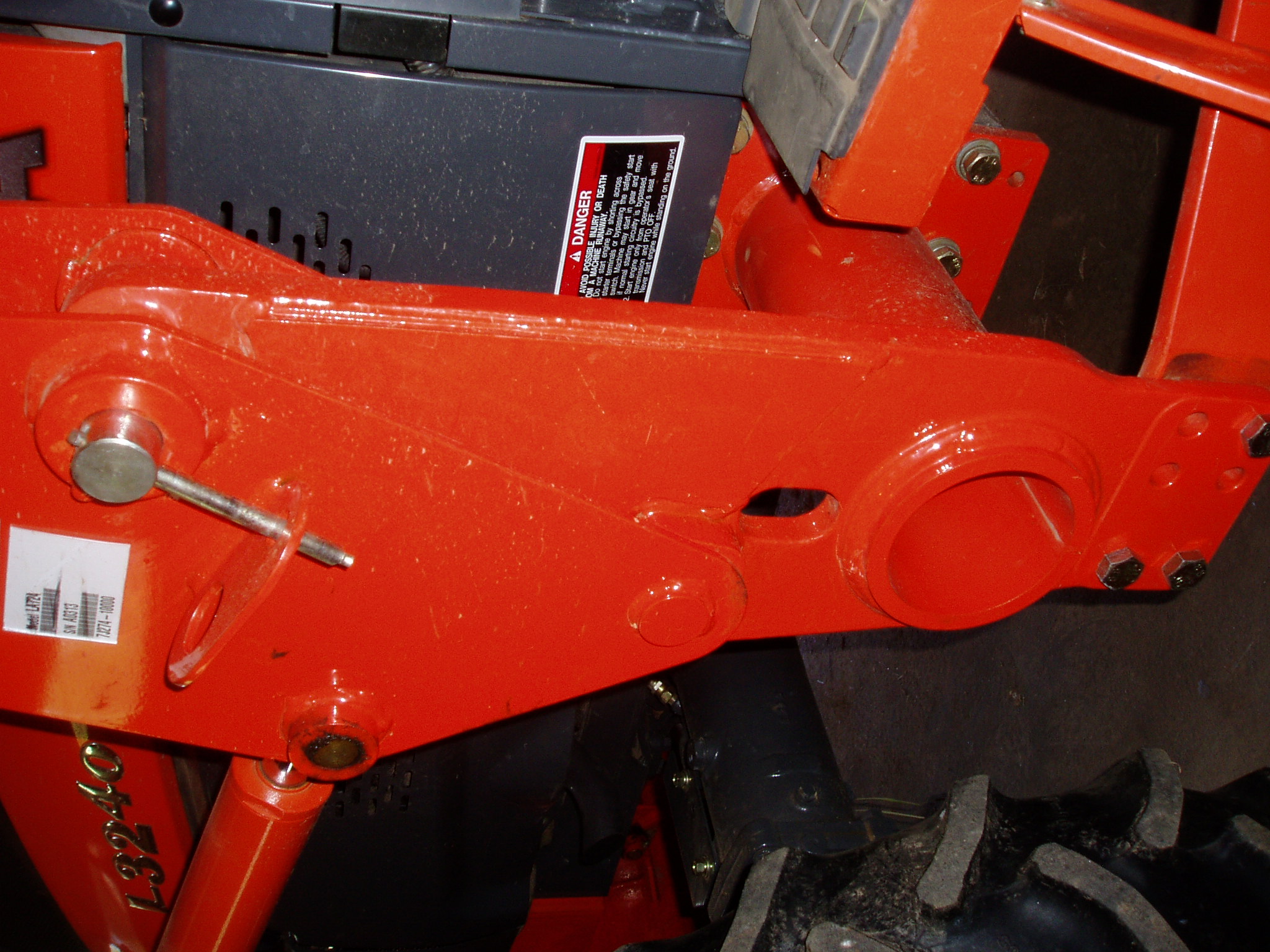

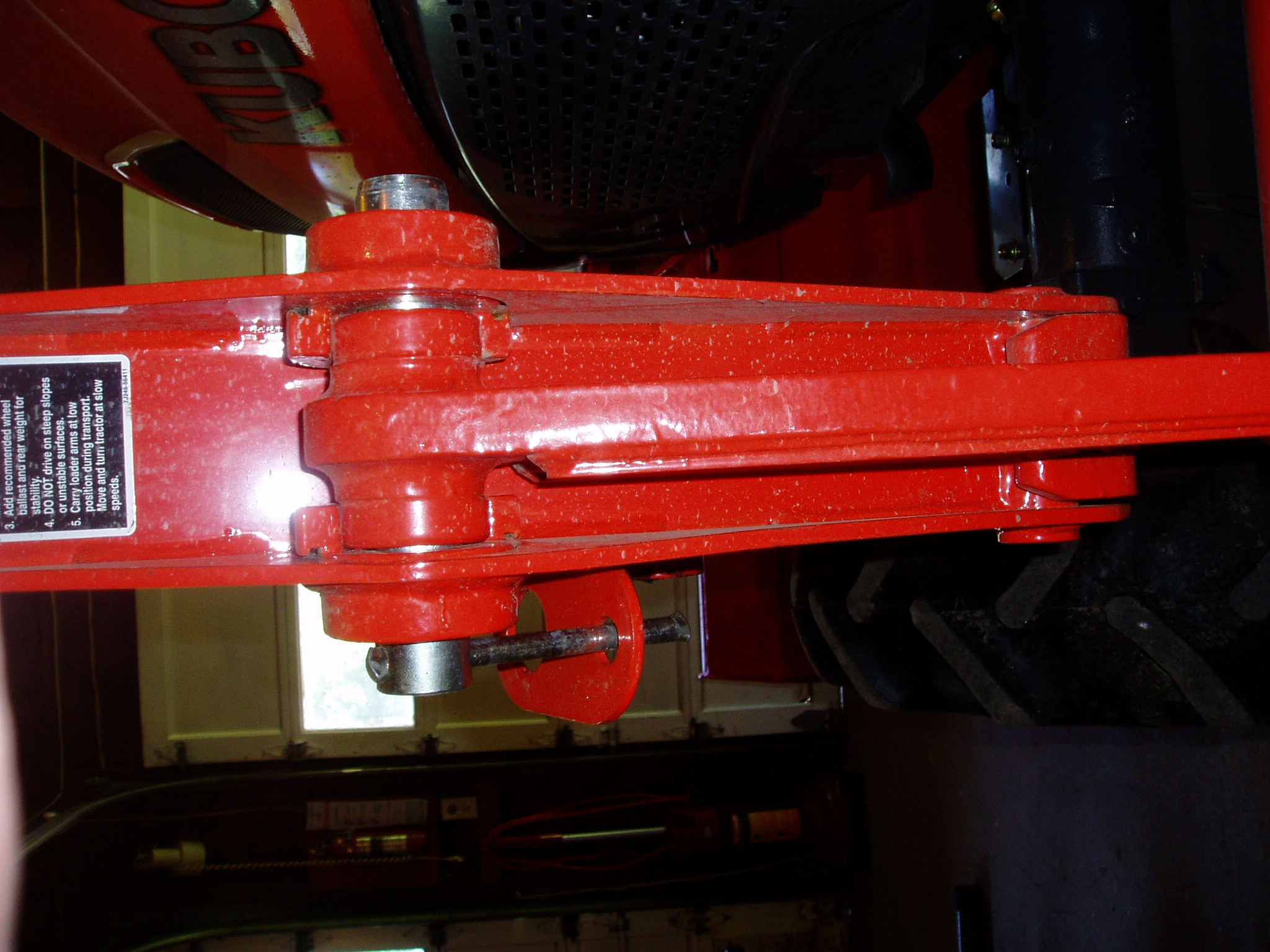

Strange ... looking at the OP's original photos ... and then at my FEL, which was bought in July 2007, there appears to be a difference. My cast uprights have a heavy (sheet steel?) "flitch" plate, 3/16 or 1/4 inch thick; filet welded to the web of the casting. This reinforcement runs almost the full width of the upright and extends almost a foot vertically. I don't see any evidence of it on the OP's, or maybe I just can't see it?:
I may have to eat crow about Kubota wringing out weight without going overboard ...
Kcender, does your FEL have these plates, and is it newer than mine, or older?
-Jim
My tractor was purchased in July of 2010 and does NOT have these plates.This is new knowledge to me and very interesting.It seems like maybe Kubota cut some corners here to save some money on manufacturing costs.Who is to say if this would have prevented my problem but I would certainly think it would have made the bracket stand up better.I will mention this to the dealer when he looks at it.If Kubota doesn't do anything for me,and I won't be surprised,this is what I had planned on doing when I weld
the brackets.The only difference is that I was thinking of putting the plates on the inside but I don't see much difference one way or the other.Thanks for the photos and this helps to reinforce that the casting is weldable and probably cast steel judging from the amount of welding done to it.Cast iron usually doesn't accept this amount of weld without a lot of care that I don't think Kubota would be willing to do that.

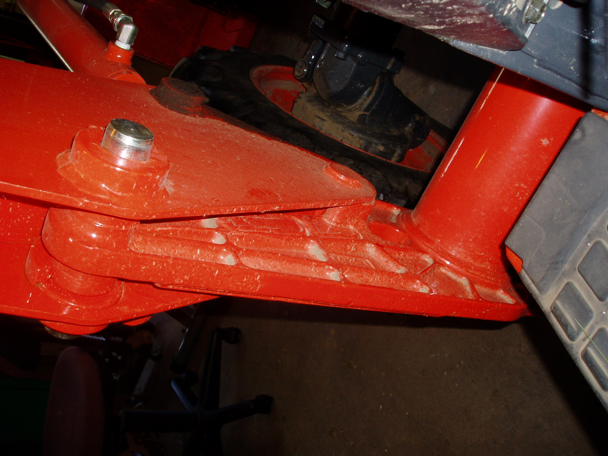

It looks like a different casting altogether, I don't remember your's having as many "pockets" on the back side, and it definitely doesn't have the reinforcing plates welded to the outside.
Ritschner mentioned earlier that he thought they had changed the brackets recently. Maybe they tried a new design that wasn't supposed to need the plates welded to it, with a lack of success in this case anyway.
It might be stronger with the plates on the inside. From what I saw of yours today, it looks like they both cracked on the thinnest part of the web on the inside of the casting first, then spread to the outside. If you stiffen the inside, the web might not crack as easily, I think the steel will flex more if it's on the outside.
It'll be interesting to see what the guys from Nova have to say about it. May be worth talking with the regional rep from Kubota directly if the dealer can't do anything for you. Where they both cracked in exactly the same spot makes me think there's a problem with the design to begin with.

Sean,your eyes are sharper than mine.I just had a look at my brackets and they do appear to have a different web pattern than the ones on Baby Grand's.Mine must be the new and improved version:laughing:I will definitely mention this to Terry when he comes to look at the tractor.I think you are also right about putting the plate on the inside which is what I was thinking.I was thinking of both sides but I have to consider the inherent stresses from welding,more is not always better unless I had a way to stress relieve the part after welding. This would require a sizable furnace which I do not have.

Terry from the dealership where I bought my tractor was just down to see the bracket.He said he found it hard to believe that the bracket broke.I showed him the crack in the other bracket and he agreed the cracks were in exactly the same place on both brackets.He took pictures and said he would contact Kubota the first of the week.I told him I didn't expect much from them but he said you never know how they are going to respond.I mentioned to him about the brackets on Baby Grand's tractor with the reinforcing plates and he asked me to send the photos to him,which I did.So now I wait.
/ Broken Mount For LA724 #51
Well lets hope Kubota steps up and replaces them. Maybe even decides to upgrade them to something stronger. It's possible that when they designed the brackets they never thought about a backhoe, just the forces involved with the fel.

Crazyal,I am curious about the brackets on your L4240.I realize you have the heavier loader,LA854 I believe,but it is physically very similar to the LA724.Does it have the same setup as my loader brackets and if so does it have any reinforcing plates.What year is your tractor?Thanks.

Just a thought on this broken bracket.I don't think this failure is due to one incident but rather is the cumlative effect of many hours use.The rust on the broken bracket shows it was cracked long before the total failure.I would also bet that the crack on the other bracket has been there awhile.Because the cracks are in identical spots on each side I am leaning toward a poorly designed bracket.The removal of the reinforcing plate leads me to believe that the brackets are not made as strongly as they once were.My tractor is only 15 months old but I have put 531 hours on it which is probably heavier use than most utility tractors get.Some people might take 10 years to put this many hours on their tractor.My point is that more of these failures may start to show up as tractors get older with more hours use but lets hope not.The failure could be because of how I used the tractor but I really don't feel I abuse my tractor to the point that something like this would happen.:2cents:

Hey Crazyal,I hope this is an isolated incident as well,especially if I manage to get the brackets replaced with the same type.I am still curious about the design of your loader brackets but you didn't mention anything about them:(

They look like yours. Solid on the outside with a pattern cast into them on the inside. No plates welded on.
