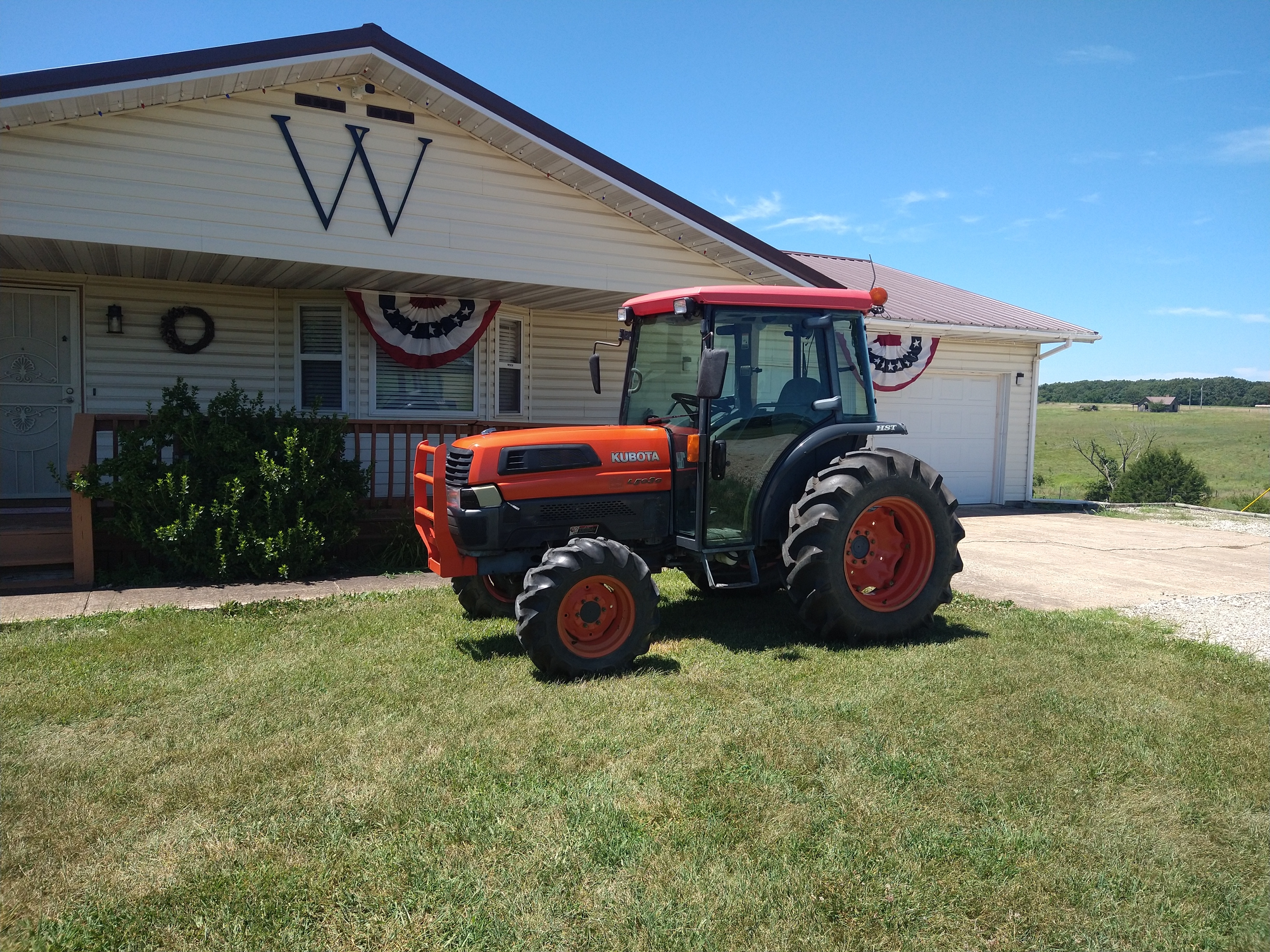

I just recently bought a 2005 Kubota L5030 with 3900 hours on it, starts in less than one revolution, no smoke, clean fluids and clean tractor, with honest wear, was used by the local state college to mow and spray . . .I paid $16,000 US for it ... Cab, but no loader ...
