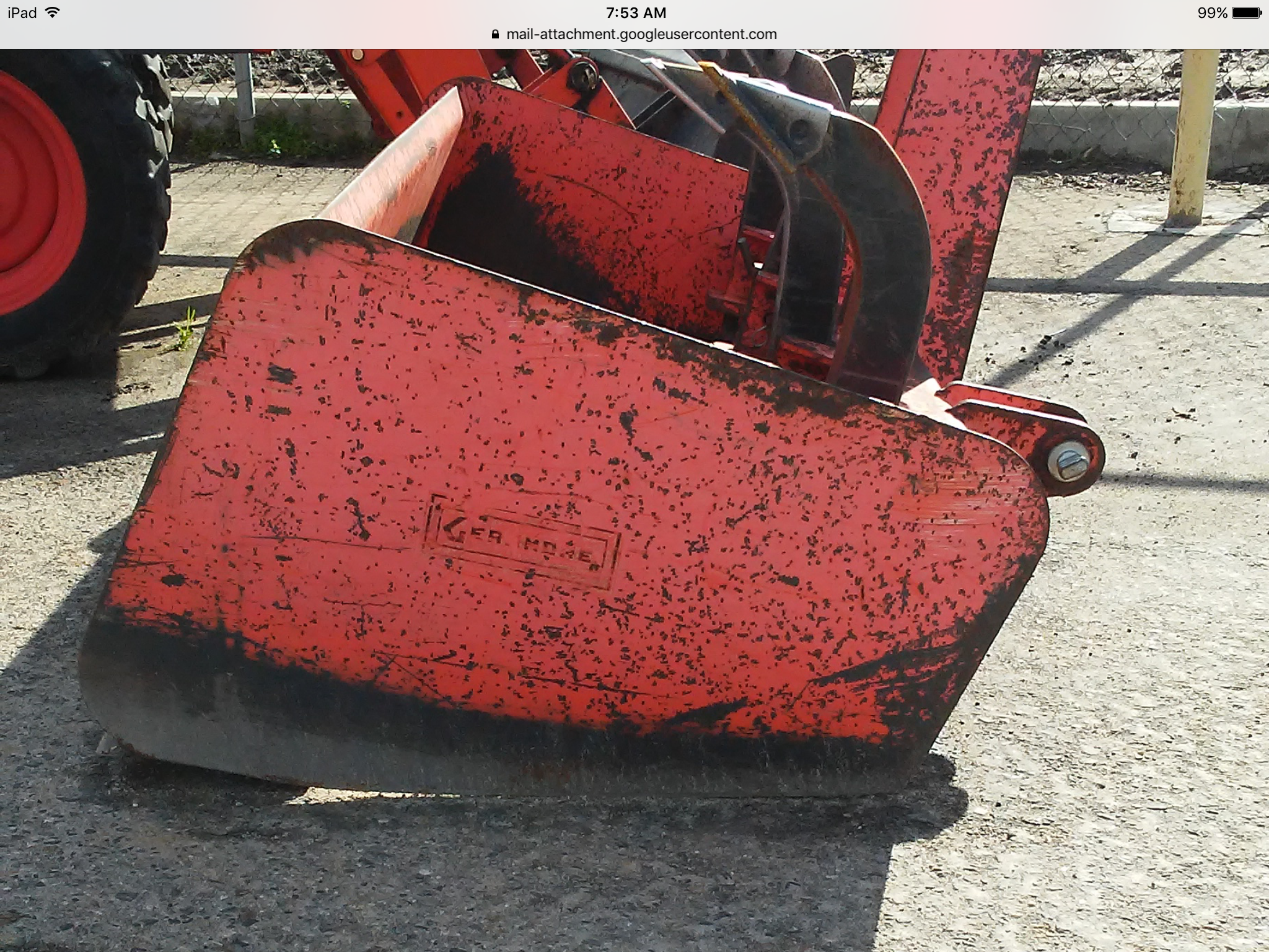

I just bought a Box Blade and have no experiance using it yet, and when I was at a rental yard I noticed how warn down this one was. So when does a box blade become unusable, and if they get ground down this much why don't they have replaceable edges or hard facing on the bottoms.
If the front is doing more than just touching the ground the top link is too short. By pressing down on front you are lifting the cutting blade.
You will need to verify the forward cutting edge length before you attempt to extend the side back to factory length. From the picture it looks like that cutting edges are about an inch or so below the side. That is about right. Raising the sides could pull the front cutting edge off the ground and it would ride on the back blade- not good for cutting.
It might not have much wear. Look at some new ones, most side plate top and bottoms are not parallel.
Mine has some wear, but still works well. :thumbsup:

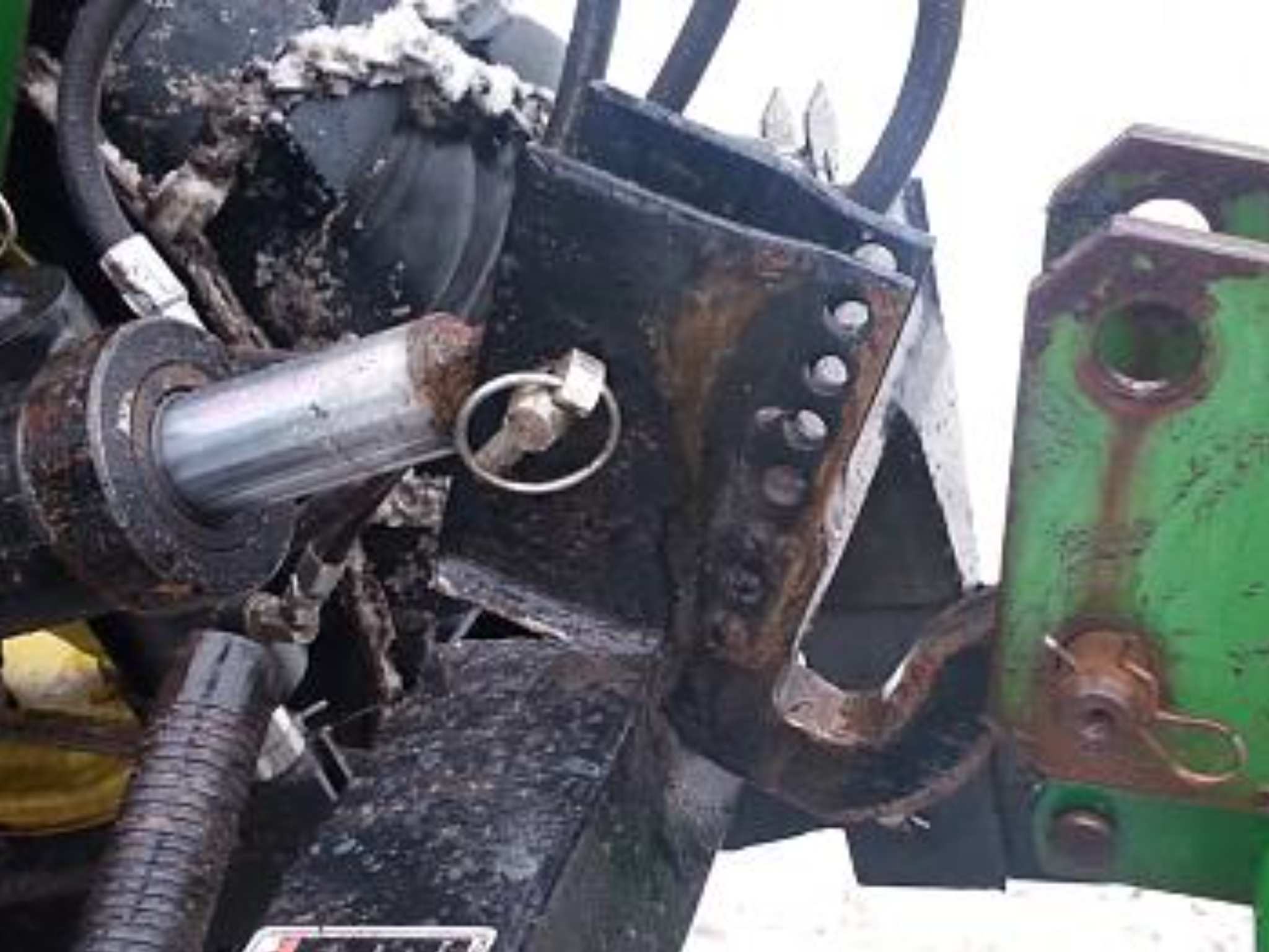

When you install a hydraulic top or side link dont you have to be careful that you don't do something like this. This was a photo I found on google images from another forum and if I remember correctly he said he was backing up and caught his blade on the ground and this was the result to his HF quick hitch.
/ Box Scraper #31
I've never had an issue. That looks like a brittle weld on a quick hitch. I've never used a quick hitch. I don't see how the hydraulics would cause anymore or less damage then a solid top link. Maybe someone else is seeing something I'm not though.
/ Box Scraper #32
Probably because it's from harbor freight....
But no, never had an issue. If you extend the top link all the way like that, the lower arms should raise up as well since they float.
/ Box Scraper #33
Catman8 - the only way I cold see that being CAUSED by a hydraulic TNT would be if your top link was able to extend way too far for the geometry of your 3 Pt hitch: so you'd tip the attachment or quick hitch plate all the way back, almost horizontal, then push even further, to the point where your top link is out further than your lower arms plus the length of the implement. I've never seen a top link that can extend that far. Even then, it should just stop and the relief valve lets go. The break shown in that picture had to be either a poor weld or abuse. I suspect a poor weld, since the type of abuse needed to rip a good weld of that size apart woudl have damaged other parts of the tractor as well.
