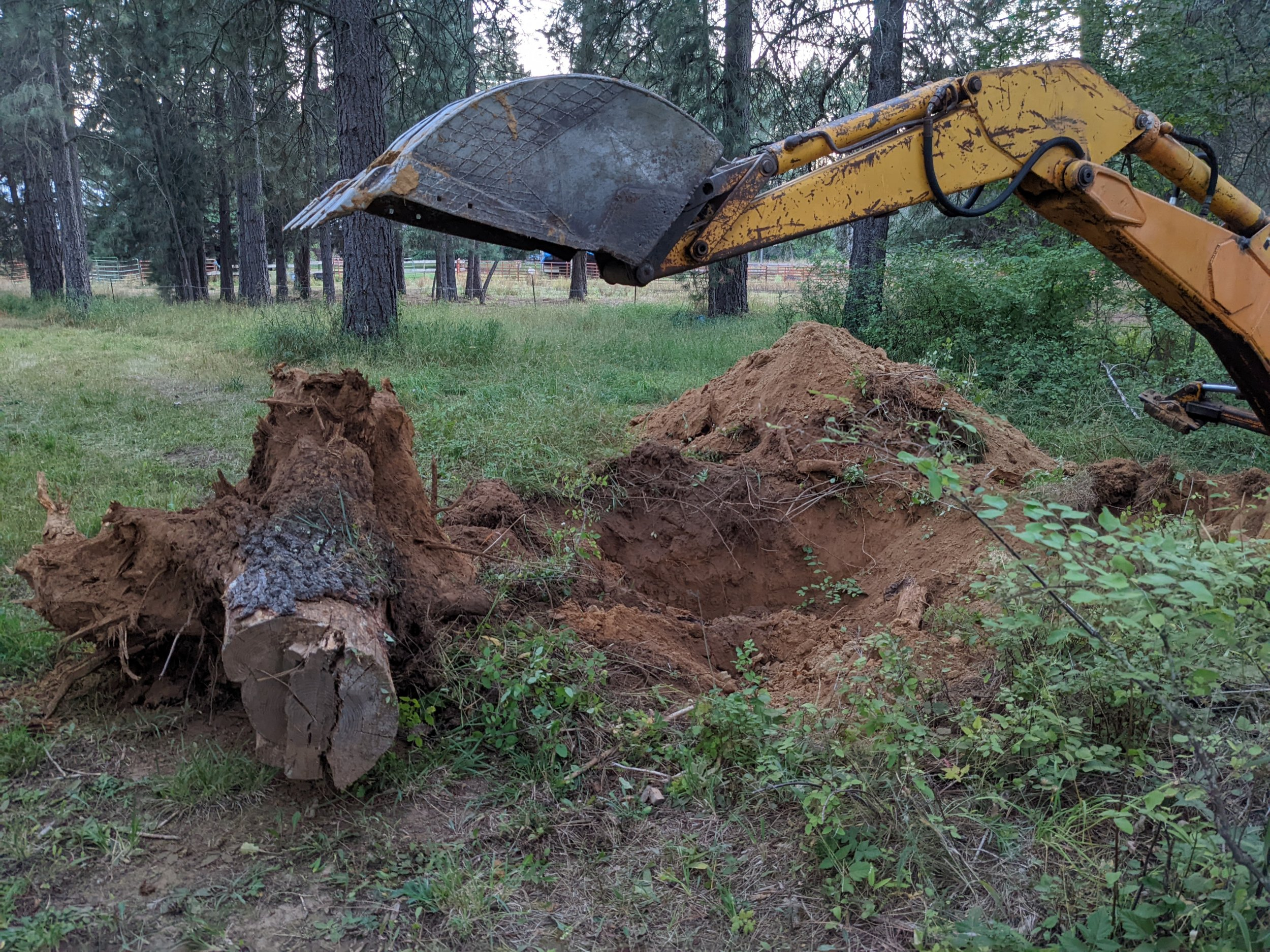

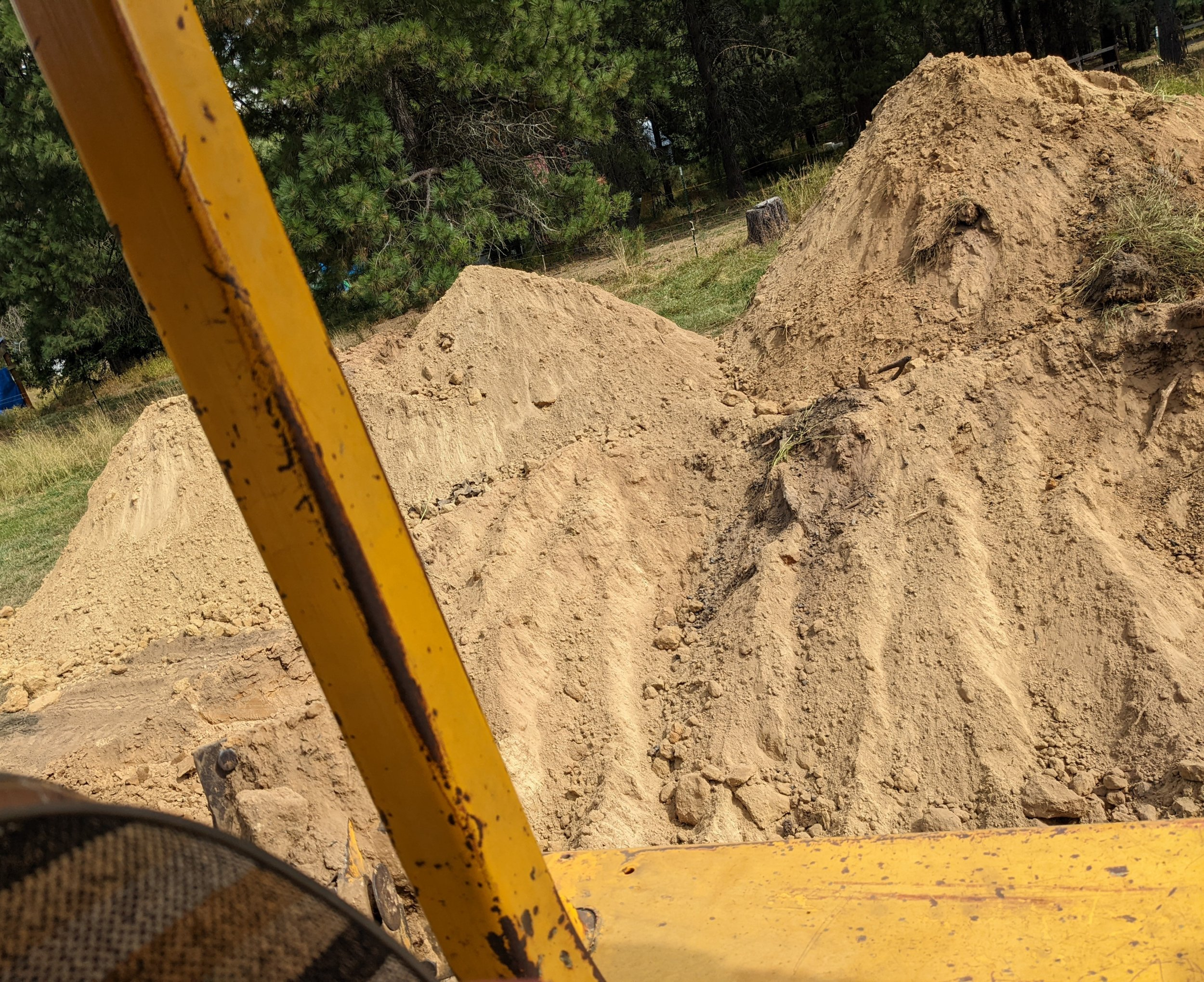

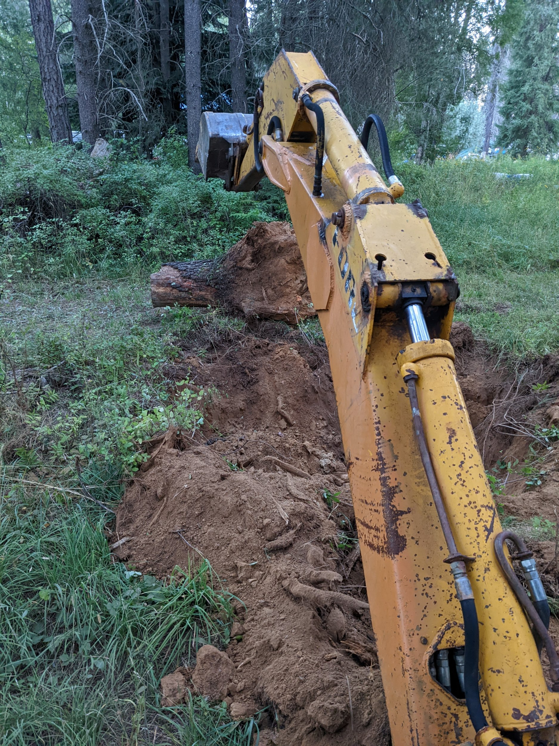

Some success. spent a good day using engine cleaner and a pressure washer getting things cleaned up a bit. Engine has a slight miss at idle and thought maybe an exhaust valve might be a bit tight checked the clearances , which were loose if anything . head work will have to wait... Running more than well enough to do some work, especially what needs done soon.
Changed oil and filter also cleaned out all of the radiators. Topped up the fluids. Still need to grease the tractor but just had to try it out on a decent sized stump.
The backhoe controls are a learning experience for sure but after digging was able to pin the stump to haul it to the burn pile with the hoe and fill in the hole and smooth it out.
Started ordering some parts that are needed like a new dash (Tach fuel gauge, coolant temp, and idiot lights) adding a voltmeter and still need a good wiring diagram /schematic- for some reason the 660+ page service manual is weak on the electrical items.

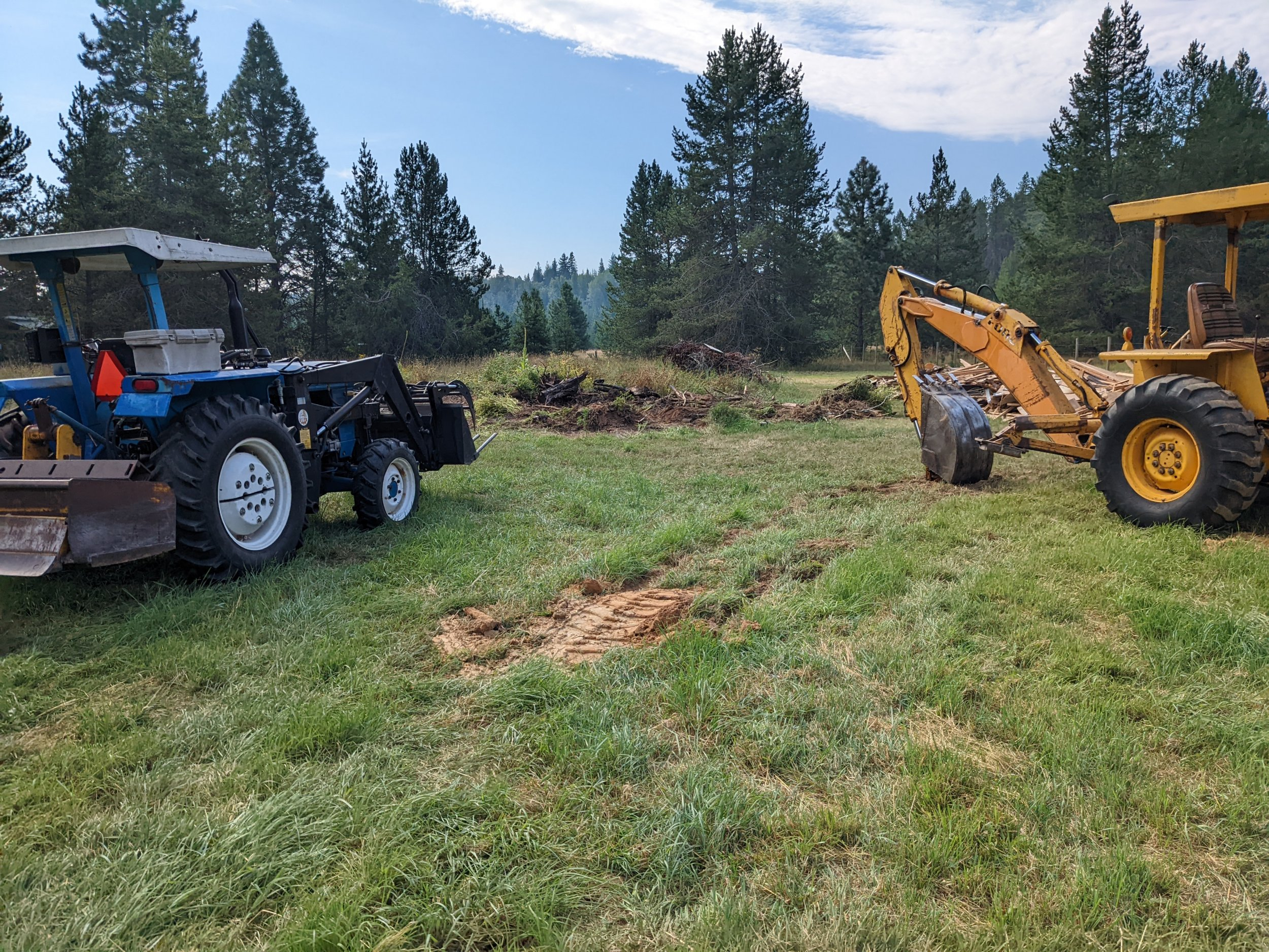

Was given an old boat which ended up being more trouble than it was worth so saved the trailer and turned it into a flat bed utility trailer.
Needed to get rid of the boat and knew trying to cut it up with a saws all was going to take a lot of time so had a patience my a--
I am going to kill something with the 550.
Was able to crush the hull with the fixed thumb and especially grabbing against the thumb and then crowding in against the boom.
Second pic was taken before crushing the last piece of hull by crowding in.
Actually picked the entire boat up and then dropped it a few times to remove the 4 cylinder engine outdrive.
Backhoes are FUN.
Still amazed at the hydraulic power and reach these old industrial machines have
Really saved a lot of time and hard manual labor have it all piled in metal for the recycler and pieces under 4x4 for the refuse disposal and regular wood for the burn pit.
