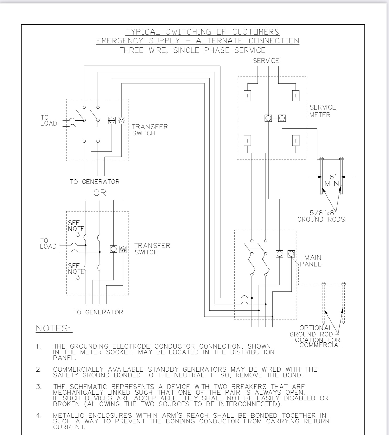

This discussion combined with lack of accurate documentation is a safety headache.
All I want to do is SAFELY hook up my generator (Duromax 9000iH with bonded neutral) either to:
(1) Equipment directly - like plugging in an electric drill, or Extension cords to distribute to frig, window a/c
(2) To a proper connection and transfer switch to a subpanel to power my "critical" house circuits - a/c, microwave, etc.
But from my reading this thread it seems like (1) needs a bonded neutral and (2) needs a floating neutral.
What's the safest and easiest way to switch between?
Is a neutral-ground plug a valid solution?
neutral-ground plug
Well it's about a week later.
The maccgyver solution of disconnecting the an internal factory wire does not sit well with the lawyer.
Duromax says to use a 3 pole transfer switch. example of an automatic, but Duromax does not sell one.
Our son is going to be installing this outside under a covered porch in Mississippi. Any recommendations for an automatic 3 pole transfer switch?
Manual 3 pole transfer switches are easier to find, but recommendations for them would also be appreciated.

As you can tell from this thread there are a lot of variables for your situation and wiring. But the reliance systems seem to be a complete setup. The plug I put in was reliance is high quality and not overly expensive.
You said your son is installing something. What is he gonna install, and how is he gonna connect it. If he is adding all new stuff right at the main box, both plug and switch, the generac and reliance complete systems are a good set up.

An Automatic transfer switch needs to be connected to a generator that has sufficient ampacity to serve all the connected loads at the time the switch automatically transfers. Otherwise you run the risk of damaging a small generator.

The Duramax generator can handle about 30 amps at 240 volts. I would reccommend a dedicated panel for the required loads you want on the generator and just transfer the the dedicated panel loads for standby circuits. Then you can use a less expensive transfer switch. 30 amp instead of a 100 amp transfer switch.
Edit: Or install panel interlocks that lock out the utility main breaker in off position and have the interlock allow a breaker for the generator to be turned on. Then turn off breakers in main panel that the generator does not have enough ampacity to serve, Manually start generator.
