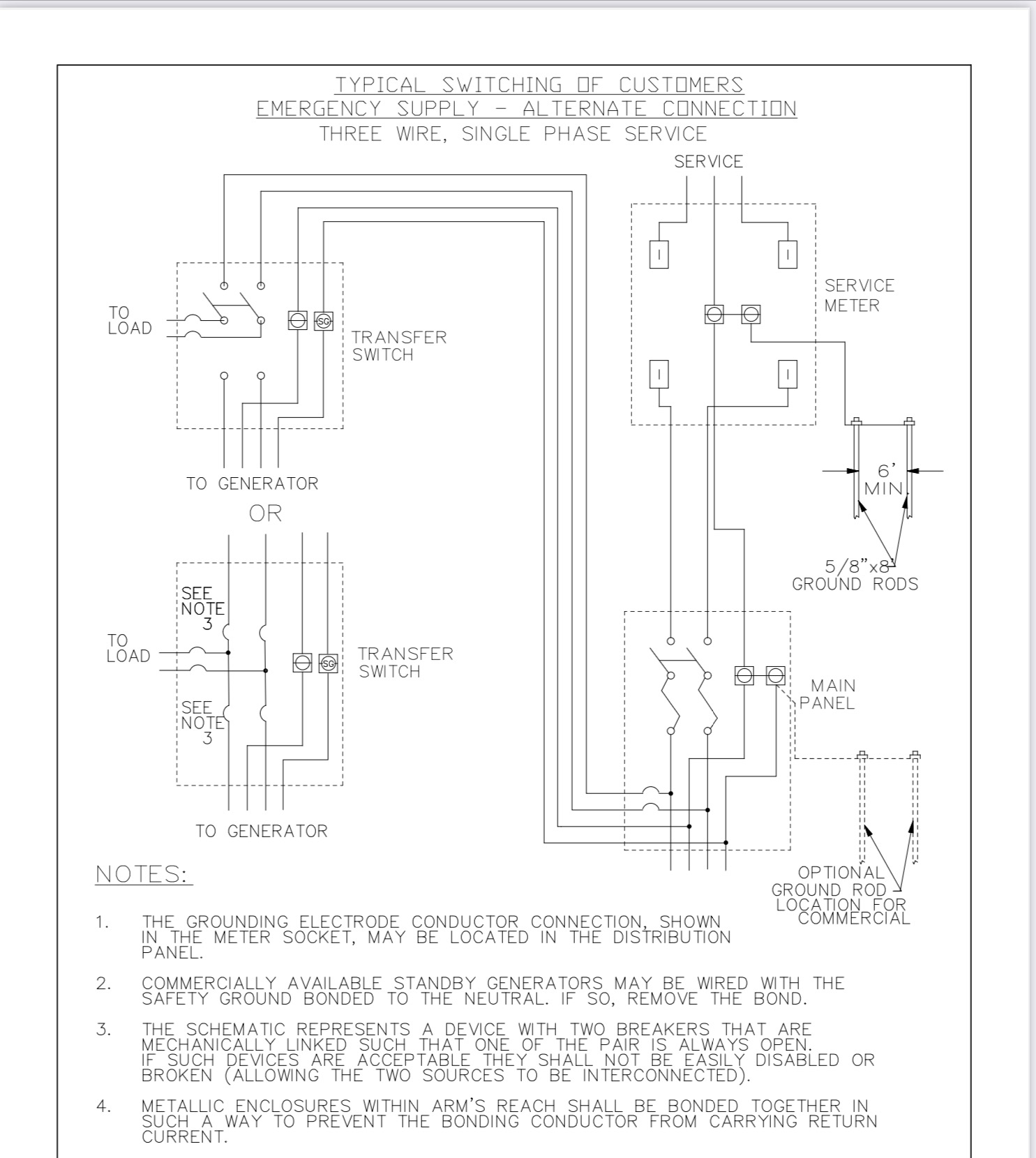

/ Bonded or Floating Neutral for generator? #47
Here is a drawing of how to connect a generator. Note the neutral is not bonded to the ground wire at the generator. The ground is bonded to the neutral at the meter socket(the preferred method) or a the main electrical panel.
I’ve never seen a transfer switch drawn like that.
That diagram is for when only 1 load (perhaps a sub-panel?) is transferred onto the generator system during an utility outage; and the loads on the main panel are not. That is, the main panel is not transferred to the generator system in this setup.
Other installations might switch the whole panel, like this diagram I found on the internet.

It would be the odd transfer switch that switches the neutral, typically not found in commercial or residential applications.
Coby, I dunno how common or uncommon, but I believe your sep. derived system illustrates it (if I'm reading it right). Alls it is is an isolated neutral bus bar in the transfer switch, flipping the switch connects it to either your main panel or the generator. But in any case, I found the whole thing including a transfer switch itself too convoluted, when it's so easy just to do an interlock on the main panel and convert the generator to floating neutral, so that's what I went with.
