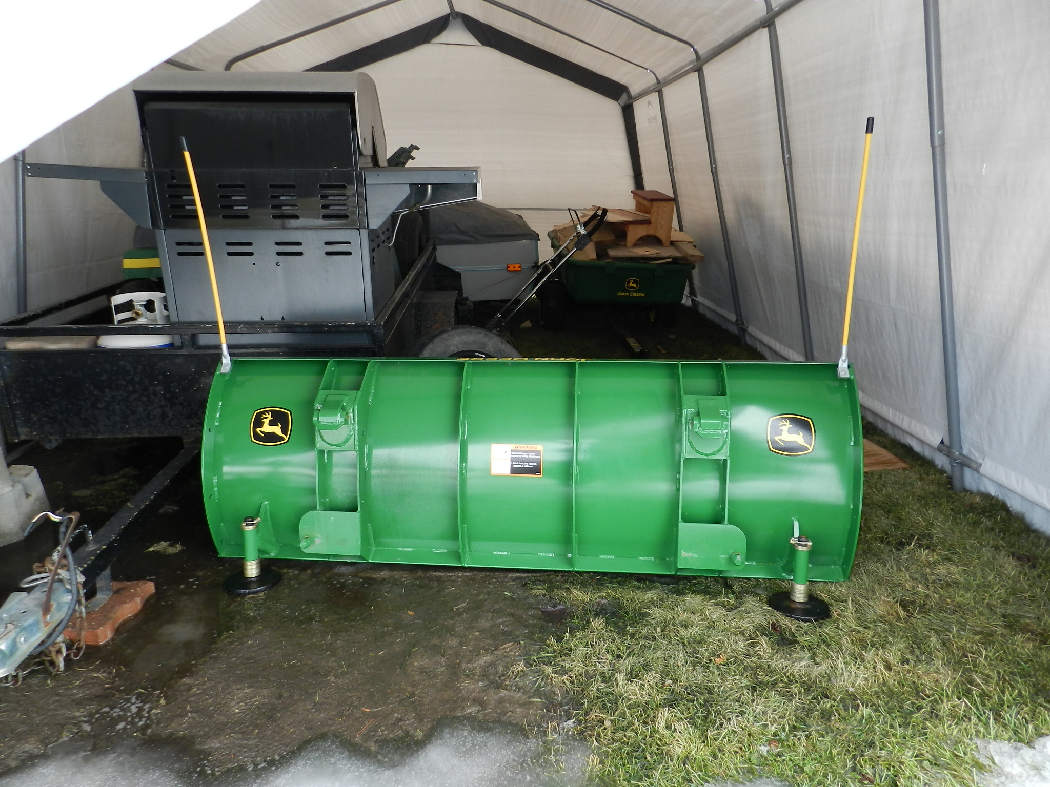

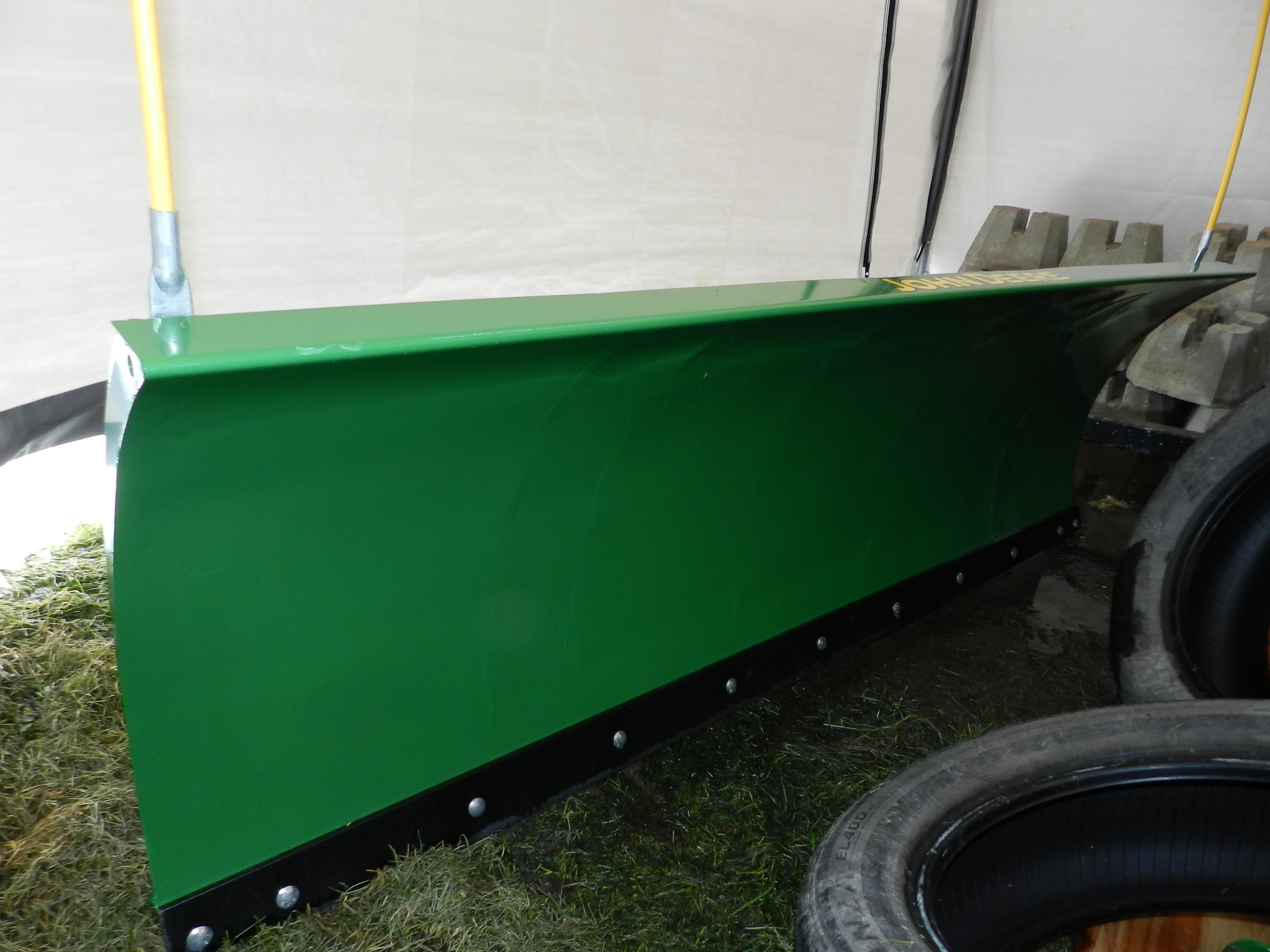

Hey everyone, I just got myself a Front Quick Hitch for my 2320. I am going to build a blade for it then later on maybe a blower since I also got the drive shafts. I am in the designing stage right now should be starting to build in a week or two. It going to be similar to the blade I build for my front end loader. The attached photos are of my loader plade.

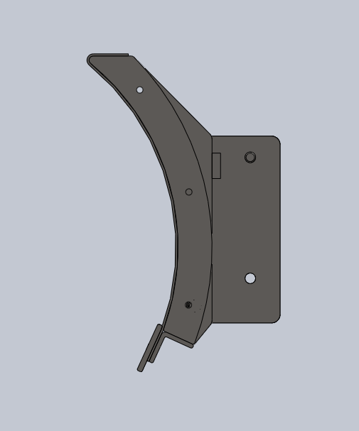

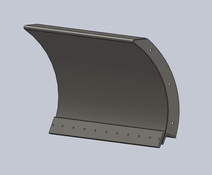

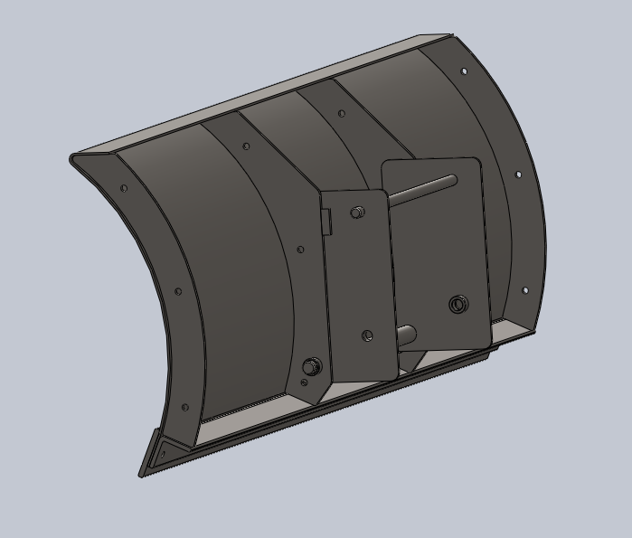

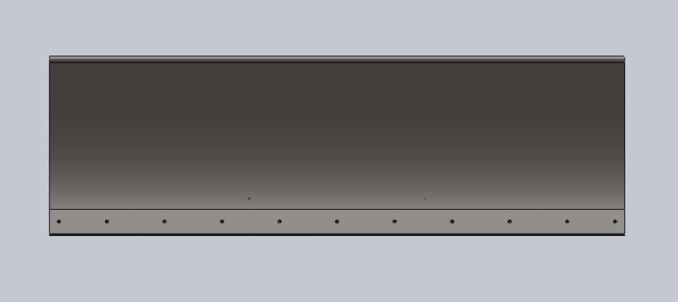

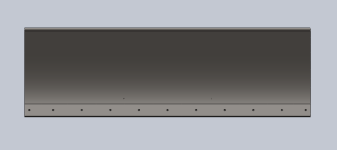

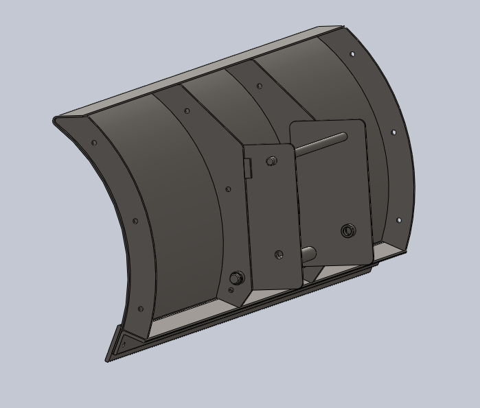

Here are a few pictures of my design. Probably going to start building this week.

The first one looks great. I like the original John Deere labels
/ Blade for Front Quick Hitch
The labels make everyone think that it is a john deere product. They don't believe me that I made it. My plan is to make this blade also look like a factory made item.

Are you going to add hydraulic angle to it? What program did you do the drawing in?

You got it right Kennyd, This blade is going to attach to the factory made front quick hitch from JD. So to answer your question 94Bullitt... Yes it will have hydraulic angle.

Sorry 94Bullitt I forgot to tell you what program I used. I used Solid Works. Very fancy program and confusing at times but I like playing around with it some times to see what I can get drawn up.

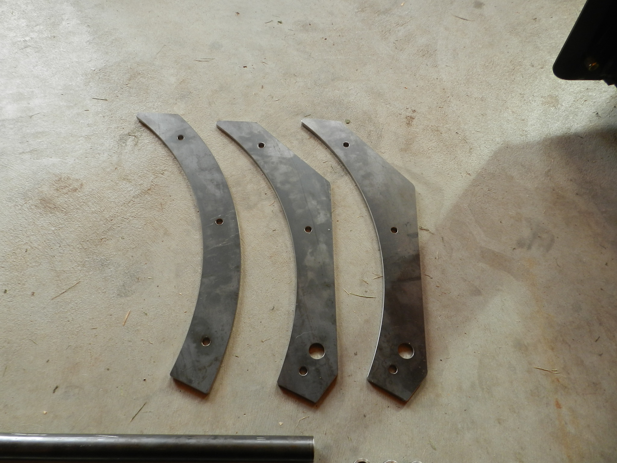

Here are a couple picks of the parts I made minus the ones the metal fab shop has.
