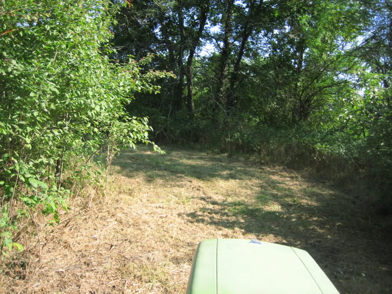

I will try to get out and snap some other photos of some of the area I am working on.
This is an older photo I actually took from the 650....it shows a small bit of the overgrown fence row...It is a little hard to tell, but the fence is an old barbed wire fence that is falling apart, They at one time kept cattle on this part. The trees have grown about 6-10 feet on each side of the original barbed wire fence....most are in the smallish range, some larger, and 99% are black locust with MONSTER thorns. There are other areas on the property that are over grown like this, an old 3 sided barn you can't really get to but is still in good shape.
The ground back there is also VERY bumpy from the cows. It also gets a great deal of runoff.
Probably already been mentioned, but with something like a grown up fence row of any length, we bring in a dozer or rent a tracked skid steer, sure saves time and money on tractor repairs.

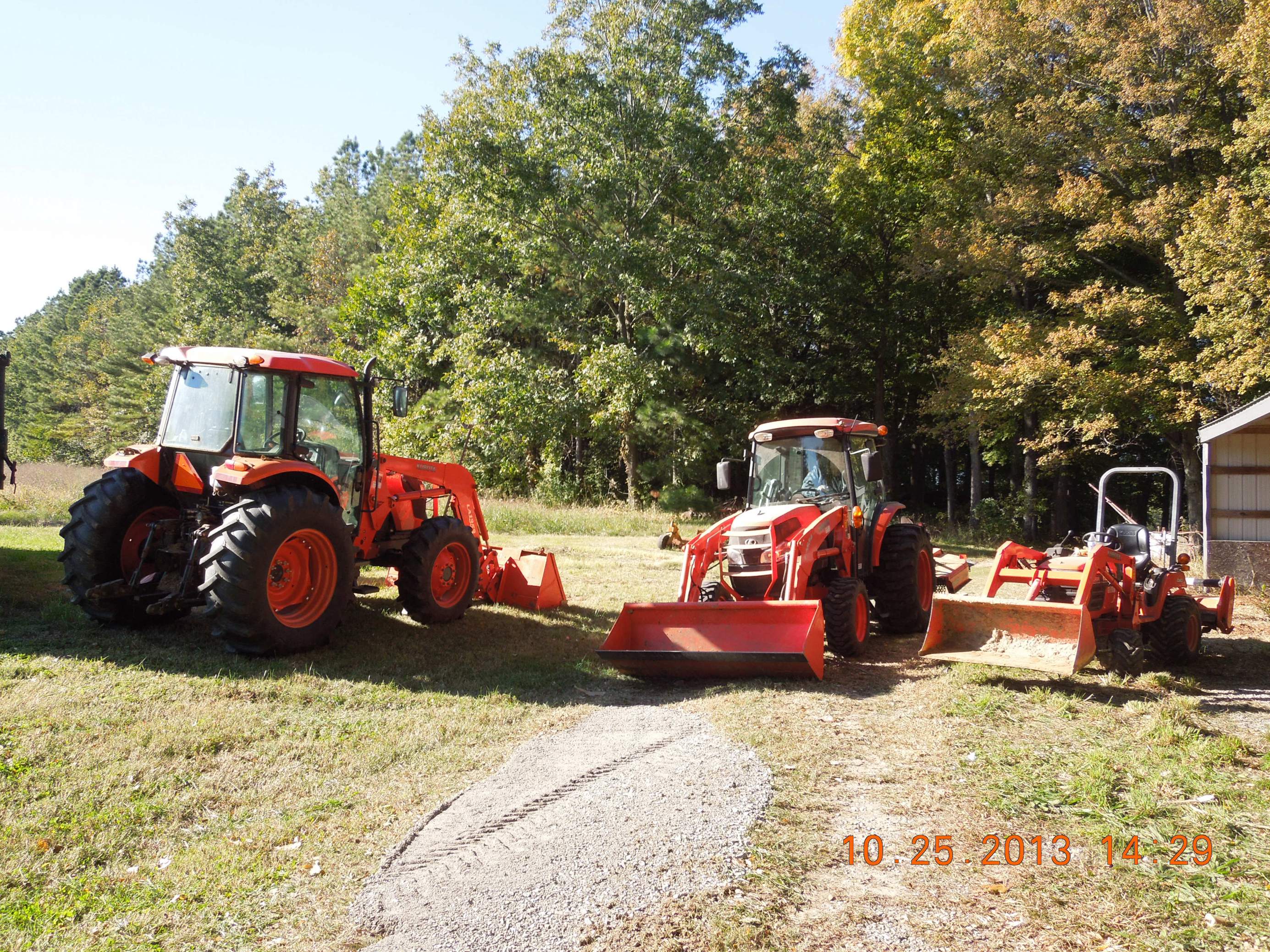

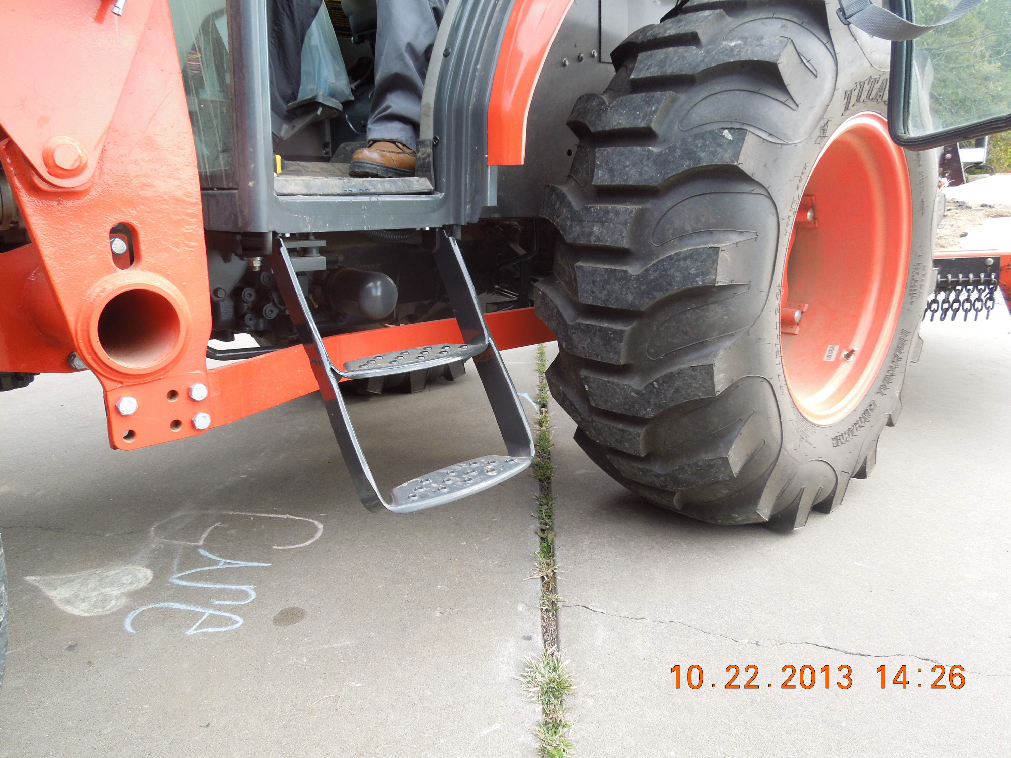

This caught my attention. For some time I have carried TV steps in all my vehicles and placed in my barn to help me on and off my tractors. A few months ago, I did a Waxman modification to mt L5740, it has been great and while it's on a Kubota can be used on other makes and models. Timber also added a different type to his father's tractor.
http://www.tractorbynet.com/forums/kubota-owning-operating/303036-my-grand-l-3240-cab.html
http://www.tractorbynet.com/forums/build-yourself/258009-step-my-dads-7610-kubota.html

I REALLY like those steps...like you said in one of those threads I am only getting older....and to tell the truth I think all that metal in me is making me rusty :)
