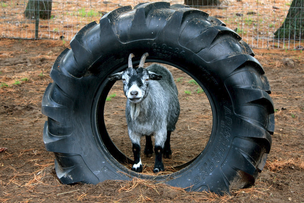

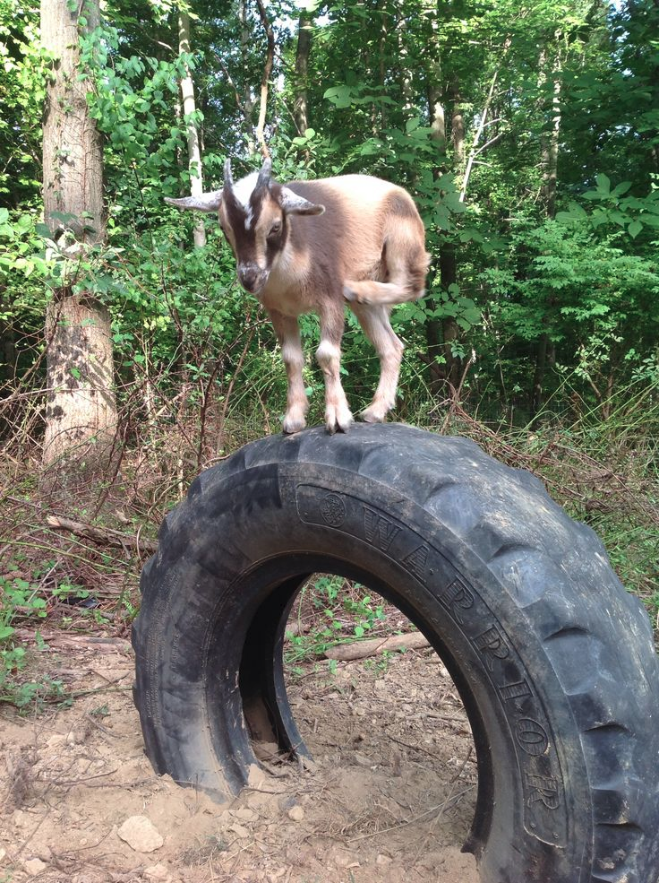

My plan was to cut a 6 foot tire in half, then bury each half 1 foot deep. Lot less digging and easier to move, and my goats are small so 2 feet tall is plenty.
   / Best way to cut large tire in half? #29
How big are those tires? Maybe I’ll get smaller ones and not cut them.
I have no idea, really. I lifted the pics off the 'net. The second one looks like 14.9 - 24. ??
