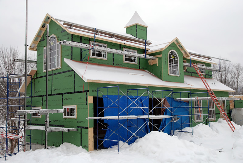

Our Monitor Barn addition is expected to be done this April. Part of the first floor will be three bays including one for my new JD 4720. The ceiling is about eleven feet high and the garage is 24' X 30'.
I want to have energy efficient lighting that is good enough to maintain my vehicles, read manuals....
I would love to have anyone's recommendations and experiences with garage lighting.

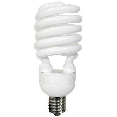

I have single 200 watt equivalent CFL over the bay where I do most of my mechanic work. I got the CFL as a promotional gift from a guy that supplies lights to my employer. That has made a world of difference on that side of the garage.
I have mentioned these giant CFL's before on TBN, and no one showed any interest.
A 300 watt equivalent uses only 65 watts. They are rated to start at -20F, (many tube fixtures can't come close to that). They never hum, they don't flicker, they can be had in several different color temperatures, they're made to be used base up, and their cheap. One bulb, and one porcelain socket are under $20 at HD.
They take a few minutes to reach full brightness, (like any florescent). But, they start at about the same amount of light as a 100 watt bulb. So, your not in the dark waiting.
There are now 400 watt equivalent units available at electrical supply stores.
I HATE ordinary CFL bulbs, and do not have any in my house. However, after seeing these giant CFL's tested at the airport in hangars for 2 years, I tried them.
I have 10 of the TCP brand, HD, 300 watt bulbs in my shop, and for only $200, it's so bright I don't ever run all of them at once.
The only draw back I can see is they are about 10" long. So, if you have a low ceiling, you may end up bumping into them.

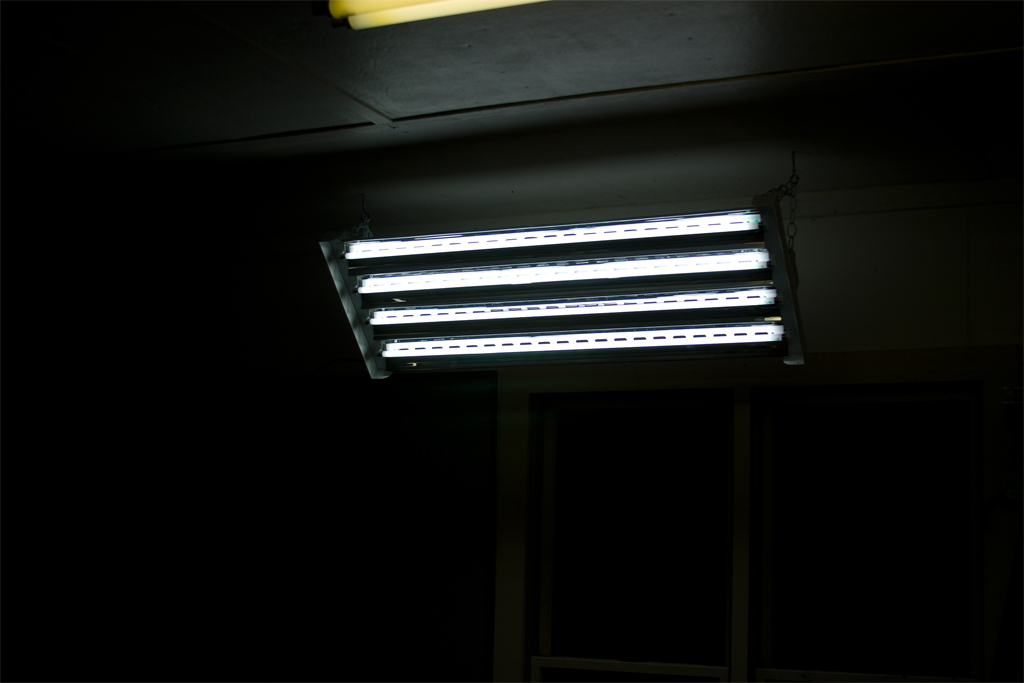

.... this is kind of a silly picture, but it shows the difference between this 'High Bay' fixture vs. an old fashioned 8', twin tube floro just above it.
I am seduced by light, so even tho' this fancy fixture was like $180 a couple of years ago, it is a helluva improvement when doing things like detailing where you want daylight-at-night in the garage. This is mounted in the upper corner so I can bounce the light off the side of the car.
DTCooper would know more than my technical judgement: "I jes' like'm."

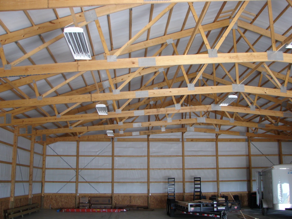

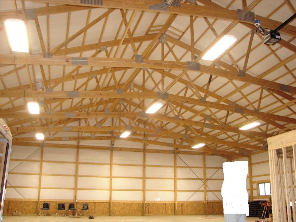

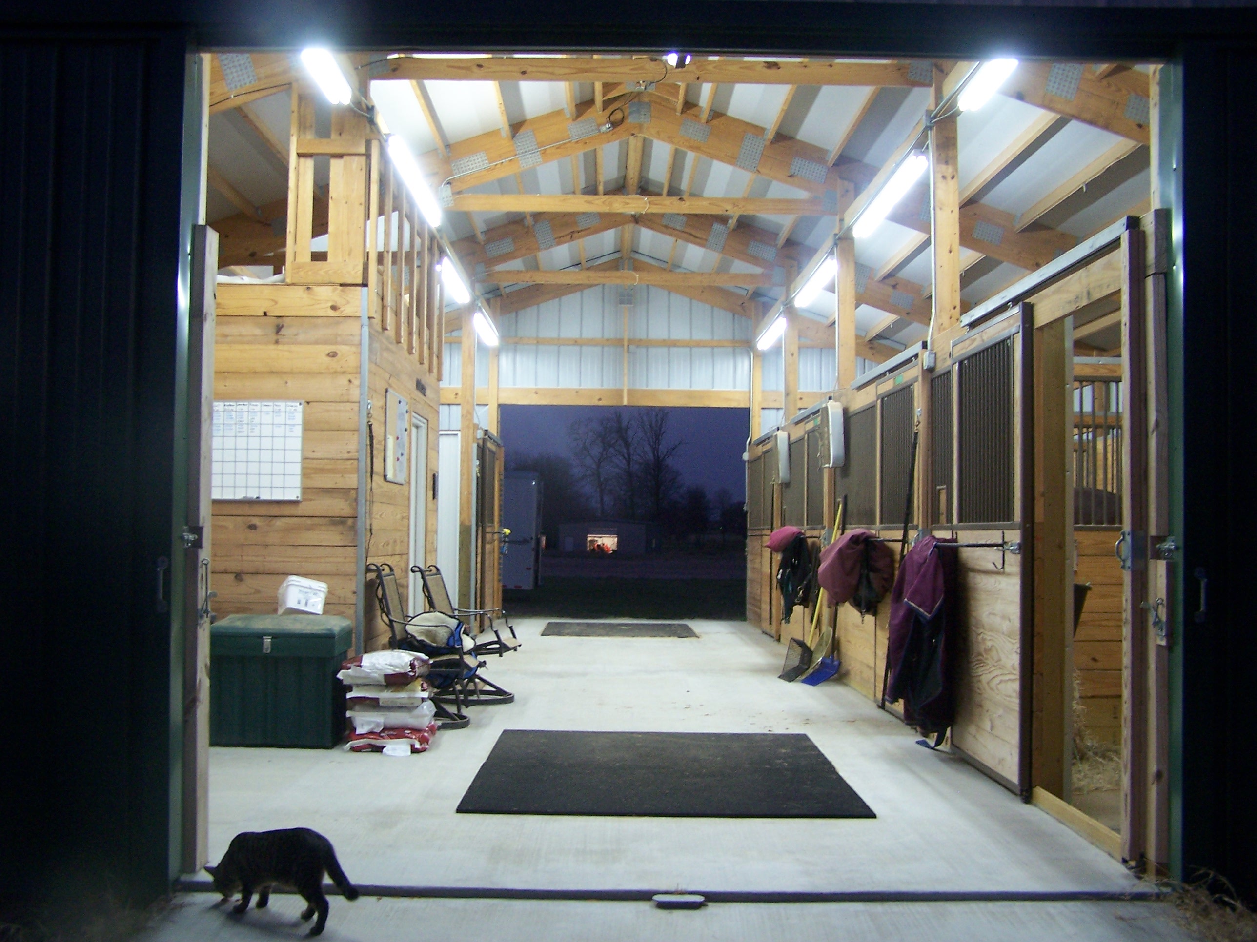

Our Morton is 60' x 72' with 12' sidewalls. The light fixtures of our choice are 4' with four T5 bulbs in each...........EXCELLENT LIGHT !!! Would buy the same thing again in a heartbeat.

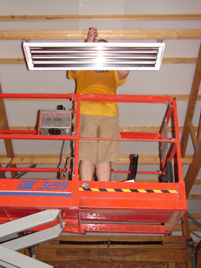

Don't know if you made a choice yet so here is my Morton barn. We used 8 8' fixtures, 4 T8 32W 6500K bulbs per fixture. Each side is on a separate switch, 3 way switches at each end of the barn. There is also a 13W flourescent nightlight on a photocell at one end. The 6500K bulbs are listed as daylight bulbs and are commercial grade. Residential bulbs are 2000K - 3000K and are a softer light.
