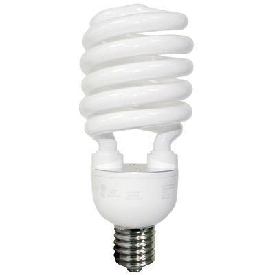

I use screw-in CFL bulbs (100 watt equivalents) in my 36 x 40 garage. I have 9 of them and they are plenty bright after 45 seconds of warm-up. I built the garage a year ago and went with screw-in for ease. I was tired of the tube flourescents after fighting them for years in my previous garages. I can dispose of these easy, keep spares, and no longer have to worry about ballasts. The screw-in CFL's are a win-win in my opinion...

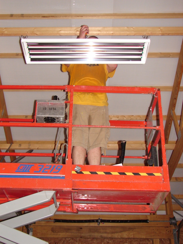

I used the T5 HO's in my shop. Its 36x42 and lined with white metal. I put 6 fixtures up that have 6 bulbs each and have chrome reflectors. They are called T5HO specular lights and I bought them for $125 each with a cord and plug end installed, and a twist lock recepticle included. I got them from econolite.com shipped free.
It is absolutly plenty of light, but I am sure the white walls help. I have a friend that used them in his shop which is bigger. He has OSB on the walls and ceiling, and it is well lit, I can't remember how many lights he used though. My lights come on full bright within 1 second of flipping the switch. I keep it at least 50 in there in the winter. You can see them in this pic.

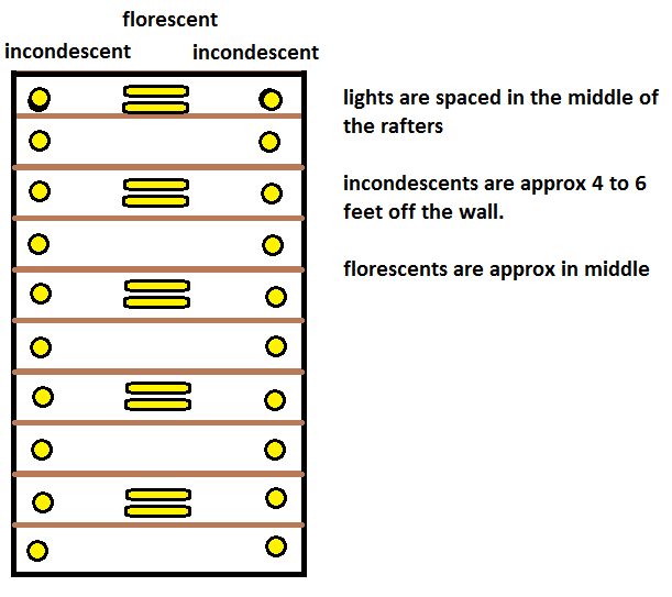

to be honest. i end up 50% of the time near walls of the shed. either to store stuff or to work on something. while florescent lights are good. i have opted for regular metal box light fixtures with incandescent bulb plats that go right over the top of the metal eletrical box.
i will end up having 3 switches. one switch to control one side of lights down the wall. another switch for the other side going down the wall. then another switch for some middle lights.
while the electrical metal boxes and incandescent, i could of used florescent lights. but i tend to go into the shed. and grab something off of a shelf. say load up some tools in a couple 5 gallon bucket. then i am done ready to turn off lights and lock things up again. and weighting for florescent lights to be bright enough to see clearly was not an option.
i also find myself in situations. working up near the walls. say storing some lumber, or cleaning up push mower, wead eater, perhaps greasing something, or perhaps measuring some old lumber lengths to see if it will fit the job i had in mind. and in that shadows are a big thing for me. and not having to drag out some sort of corded clip on light or light on a stand to see what i am doing.
which brings me to looking at the 4 bulb or even 2 bulb florescent light fixtures. there just to much light concentration in a single spot. i prefer to have my lights spread out so i can get better usage out of the lights and help to remove shadows. regardless in what direction i am facing or getting myself into.
a single tube florescent light for me does a better job placed end to end to the next one. vs having 2 bulbs directly behind me and casting a large shadow on what i am trying to work on. granted for the central lights (see diagram). i have double bulbs. but for me these lights are clear up in the peak of the building. and i can get just enough clearance for light to get past rafters for aerial lighting.

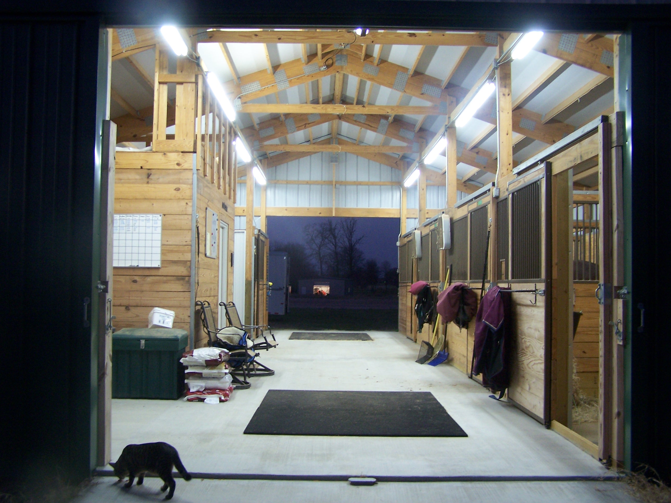

Hmm, this thread is interesting in that I just finished lighting my barn.
I made my decision on fixtures based on the fact that I got the fixtures free.
All the conduit too and a lot of the boxes. About the only thing I bought were wire nuts and wire and of course bulbs
Because of a wreckout and rebuild of an old grocery store, I came up with about 50 eight foot fictures that took two t8 bulbs and had electronic ballasts. They were throwing them in the trash along with the conduit and everything else out of the store. :(
My barn is 40x84 (four 21 ft bays) with twelve foot walls. I only lit the two middle bays because one end is a built up room and the other end just doesn't need light.
I mounted two fixtures to each of the roof perlins in both bays for a total of 32 bulbs in each bay, in other words, I have 32 bulbs lighting 840square foot. I split each bay up on two switches for a total of 4 switches to turn them all on.
I wanted to have to put my shades on when I have them all lit up and I came pretty close. With 64 5000k bulbs, it's bright. :thumbsup:
I'l post some pics this afternoon when I get home.
