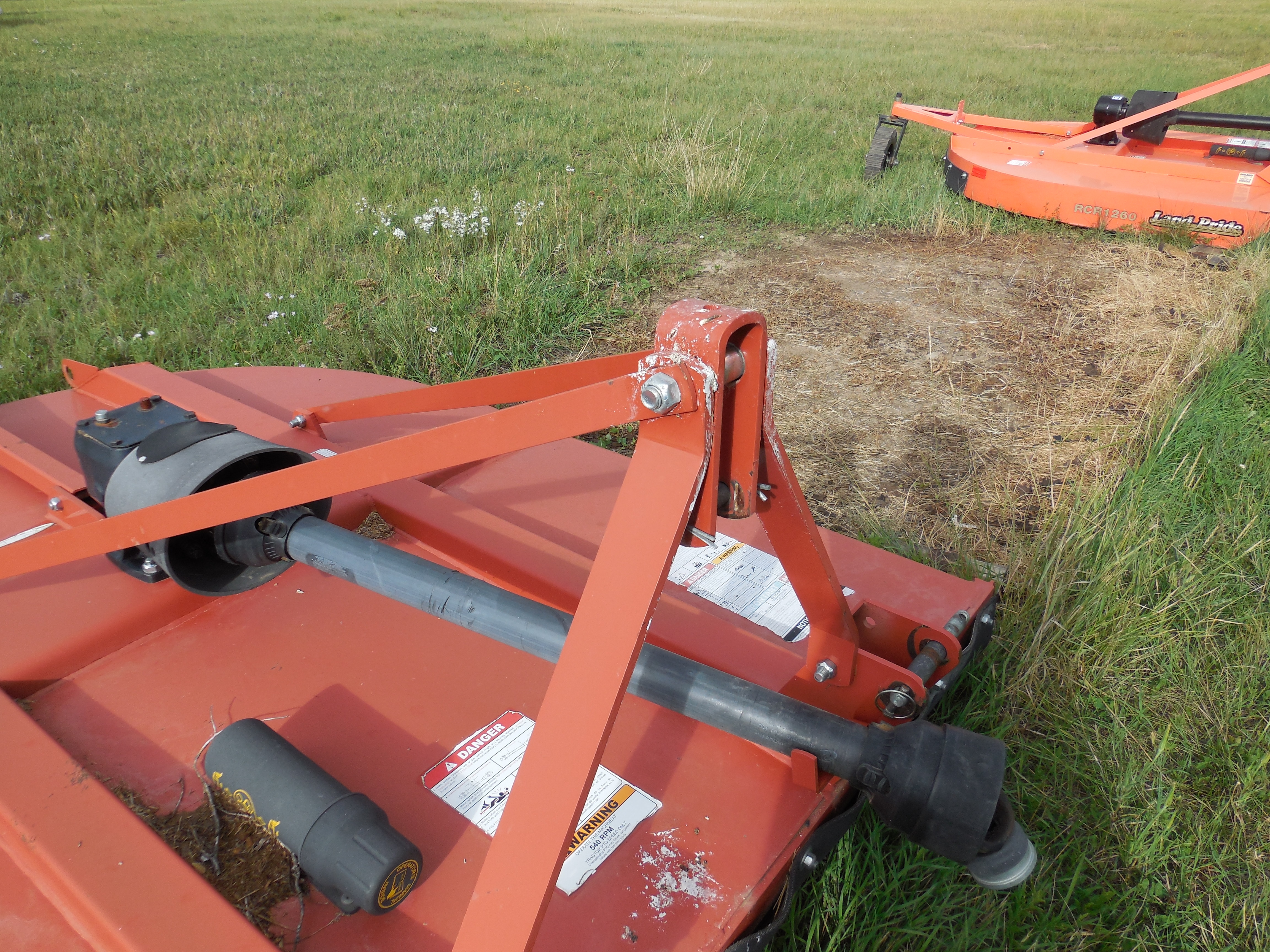

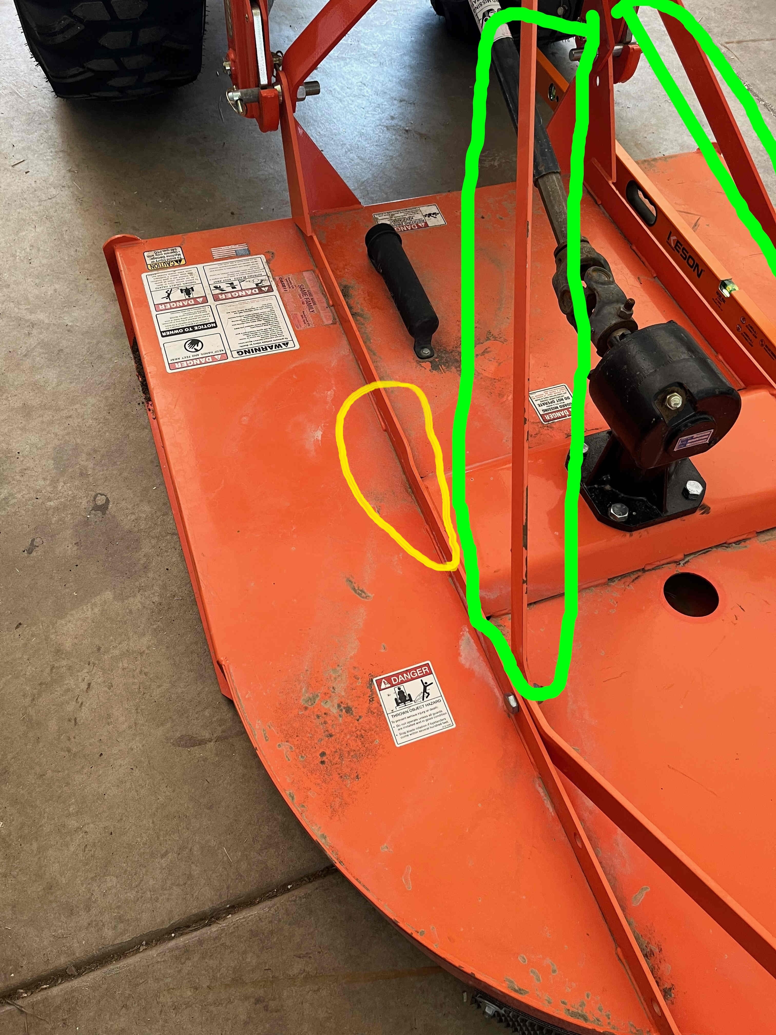

Is there some unpleasantness going on with the two circled welds, or is it just dirt?

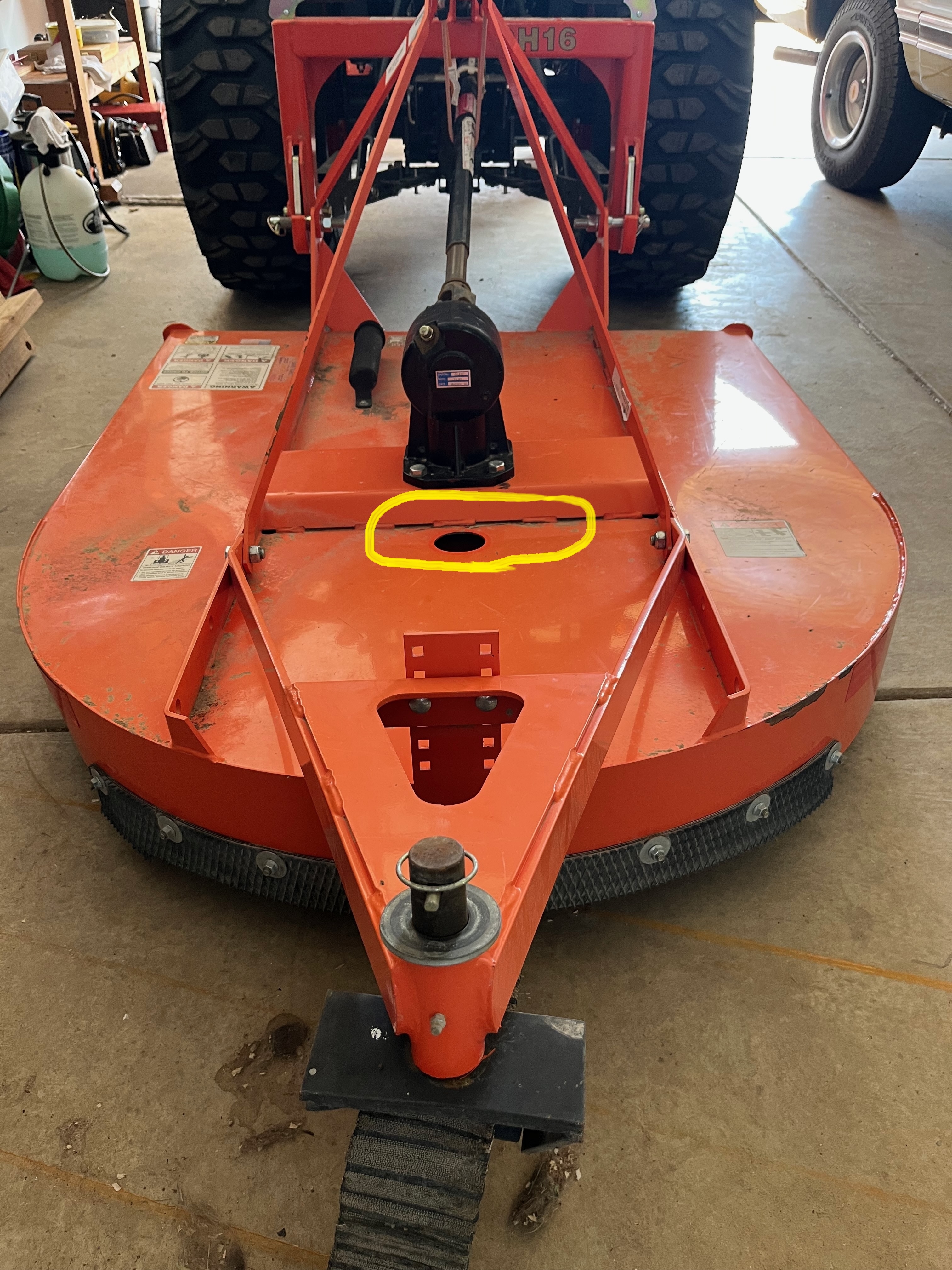

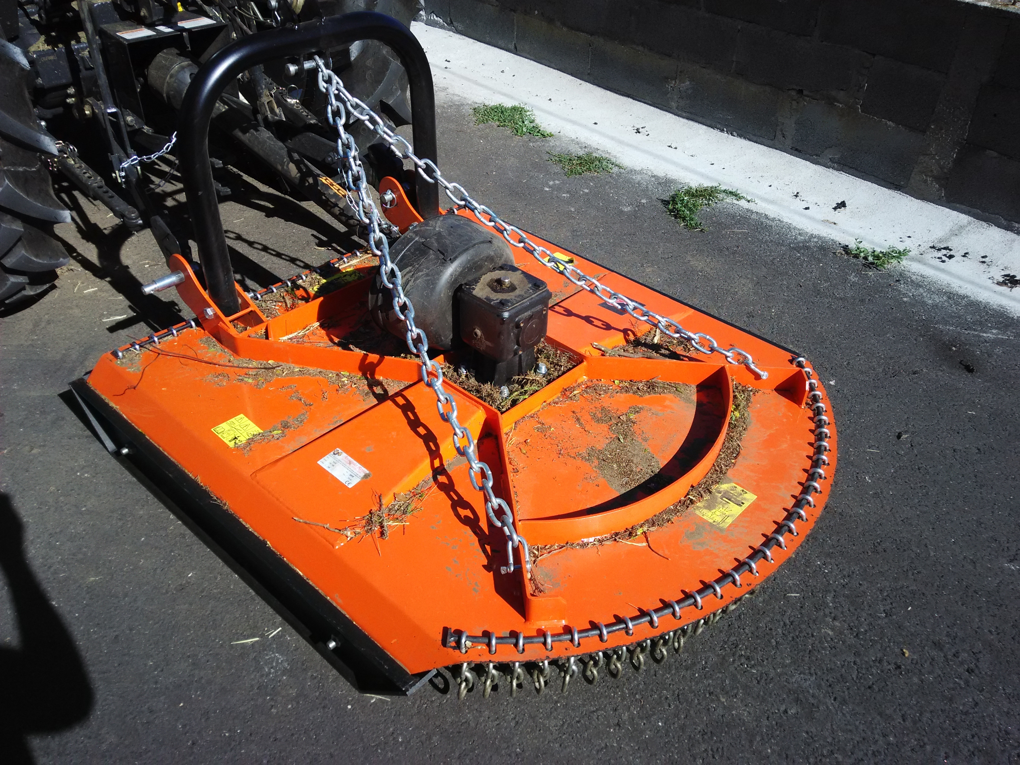

Greetings. I was not careful enough when I bought this used Land Pride RCR1248 (heck of a deal!) and did not notice that the deck is bent in a slight U shape on the left side. See the pics with the 6' level. I'm not sure how (or if) it will cut in this condition, but if it does fine I won't worry about it much.
Is there a simple way to bend it back into shape?
Also, it came with a horseshoe shaped top link that I 'think' will work with my quick hitch. Should I be trying to source a floating top link for it, or will it work fine as-is?
Thanks in advance for the help!
Jim
Probably a hot take from me…
But… seeing as there’s no “ring” of dents where rocks get flung up and beat the top up, the paints not all chipped and flaking like you’d see from impacts…
I’d betcha that hawg came that way from the factory.
Send it, and fugettaboutit! ;)🇺🇸

The nature of the beast is that rotary cutters get banged, bent and abused. I've straightened, unbent, re-bent, cut, welded...you name it on mine. It still does the job.
Yep,I have a 5"X2" exit hole in the side of my rotary cutter where a blade broke at the bolt. Took a lot of speed and force to make that hole through 1/8" sheet steel. I tried to pound the jagged edges back into the hole but I wore out first.
When it broke the whole tractor and cutter shook violently before I could push the clutch in all the way. During replacing the blades I checked every bolt tightness. All 4 bolts holding the gearbox to the deck were very loose.

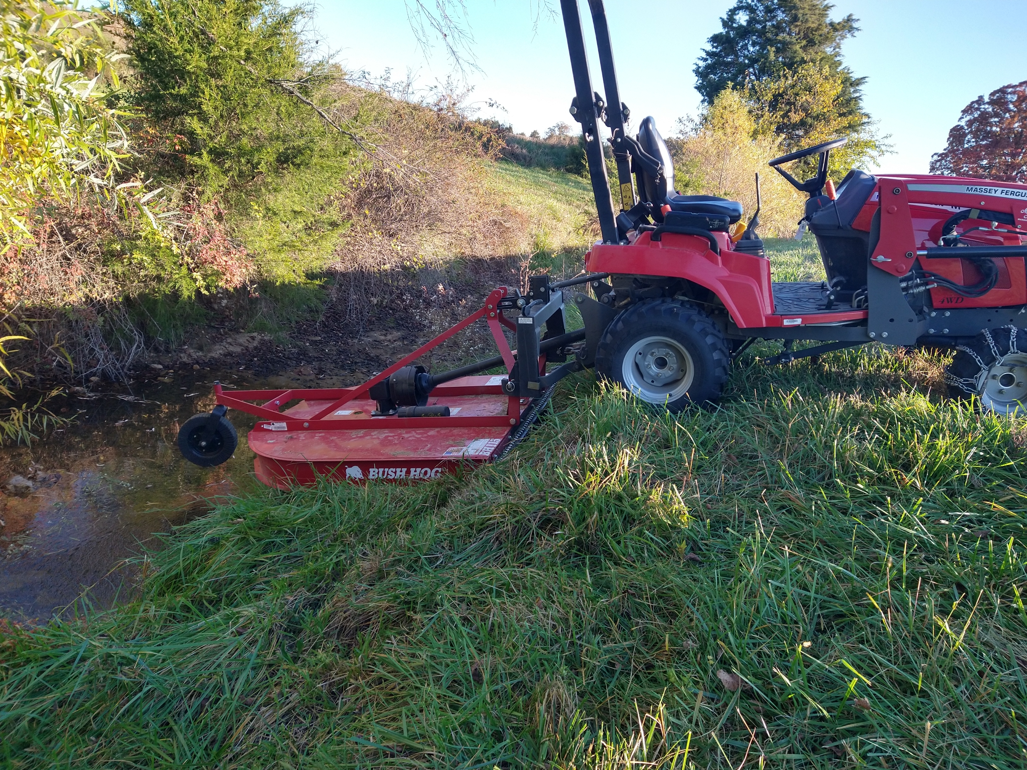

Well, the verdict is in...
After ordering a new tailwheel yoke, because, this:
New vs old:
It cut just fine. No noticeable left/right height difference in the cut.
Finally, here's the Messick's floating top link installed to give me the float I needed for my hilly pasture:
Thanks to all for the recommendations!
Jim

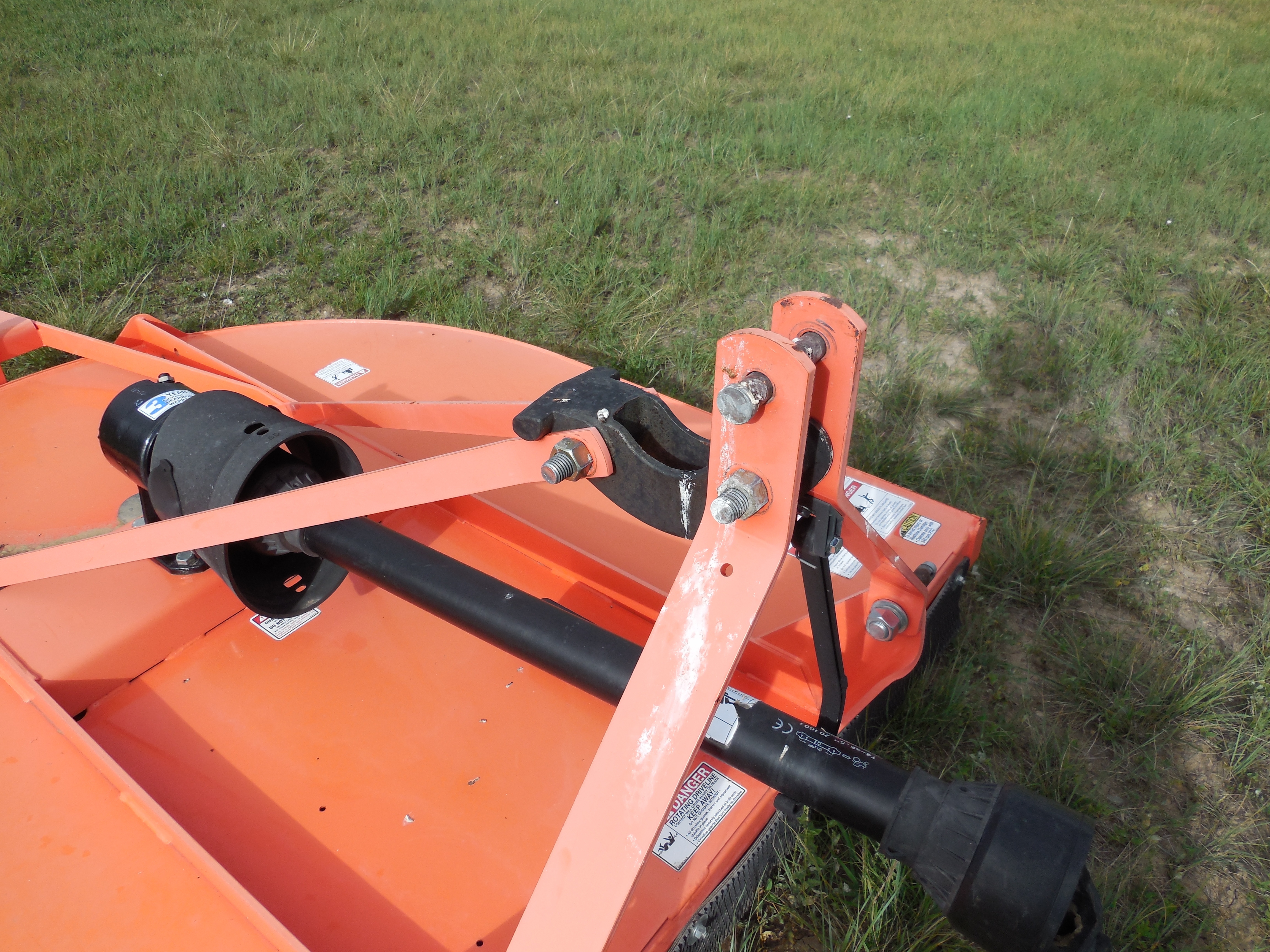

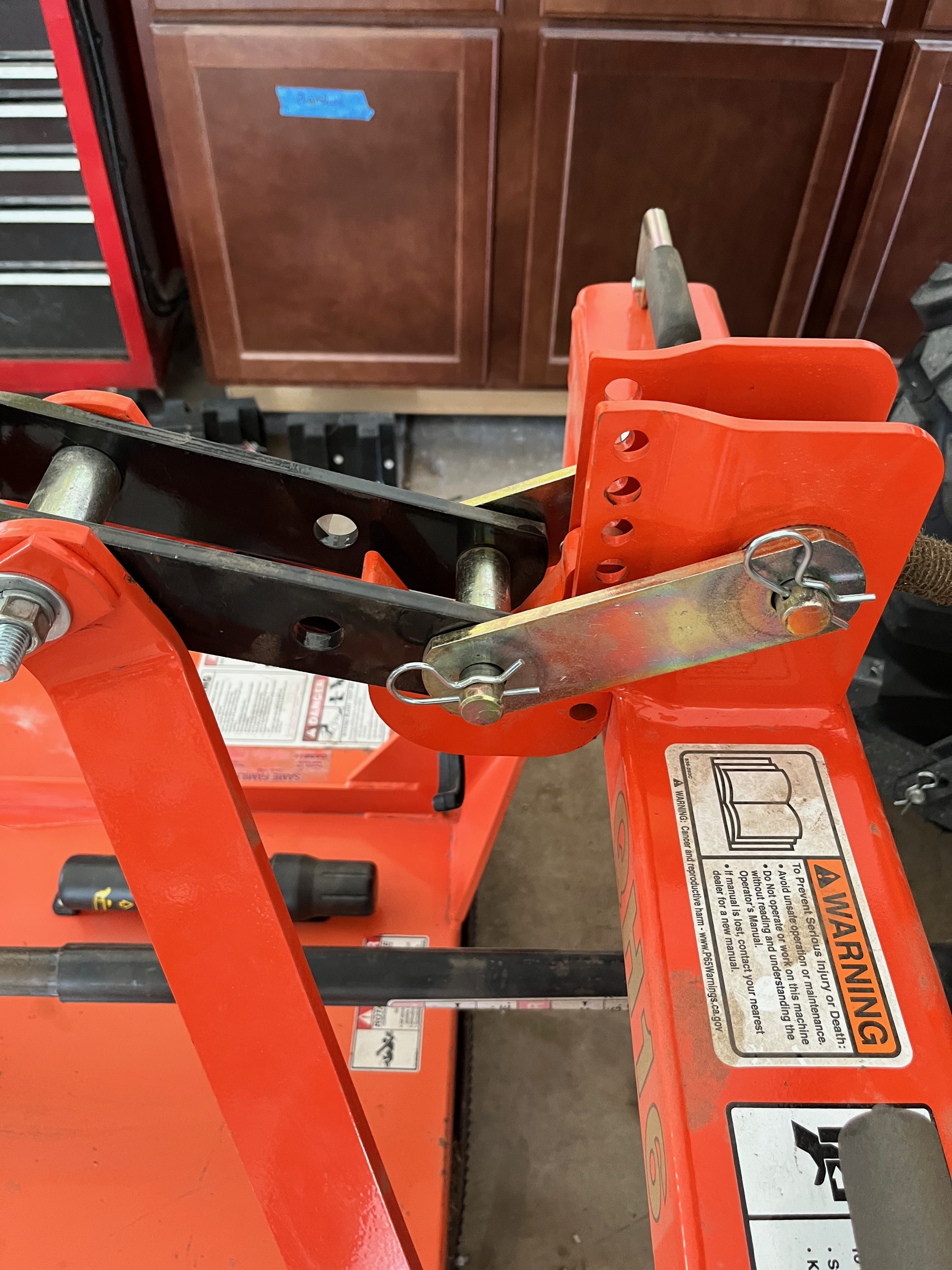

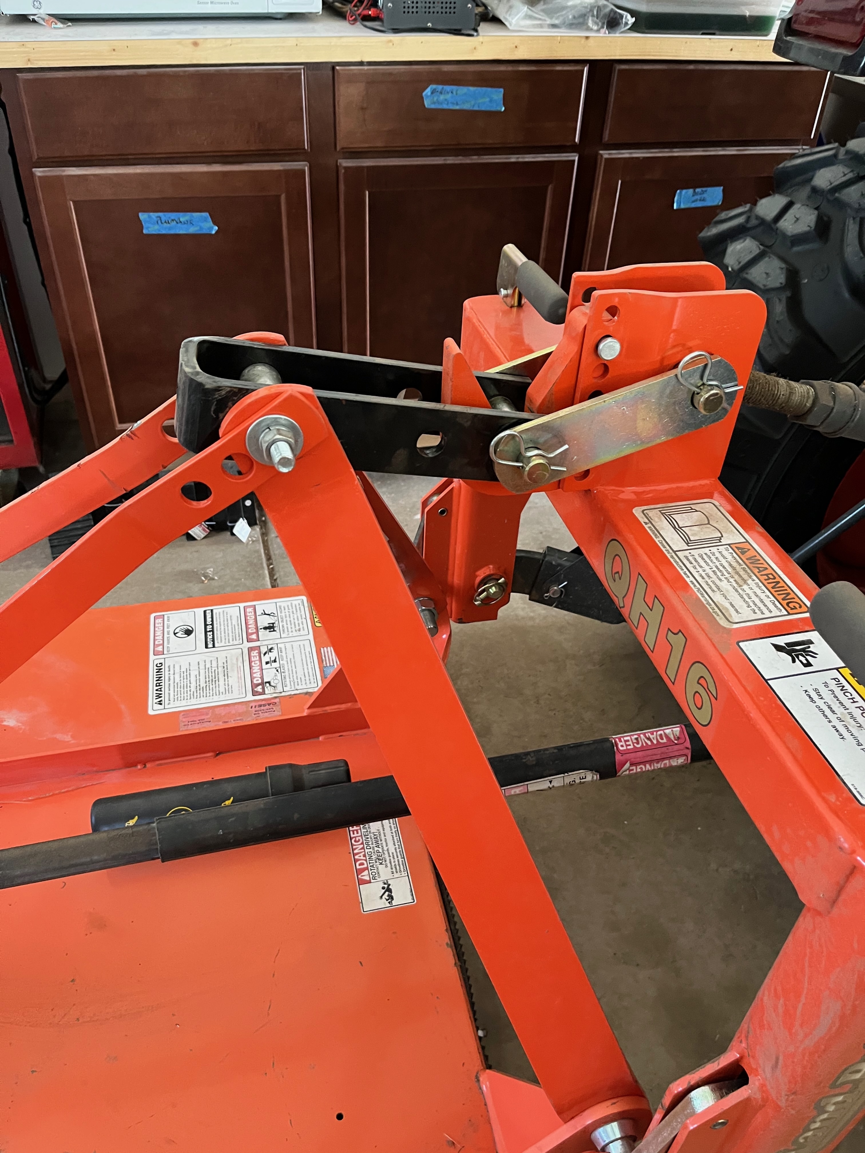

I'm not familiar with that floating toplink, but it looks like it would work better with the QH hook removed. As it is now, the rear of the deck can't go any higher. the pin is already bottomed out in the hook. The rear could drop very slightly (only enough to get the link pieces straight).
   / Bent Rotary Cutter Deck - Can it be Fixed?
#32

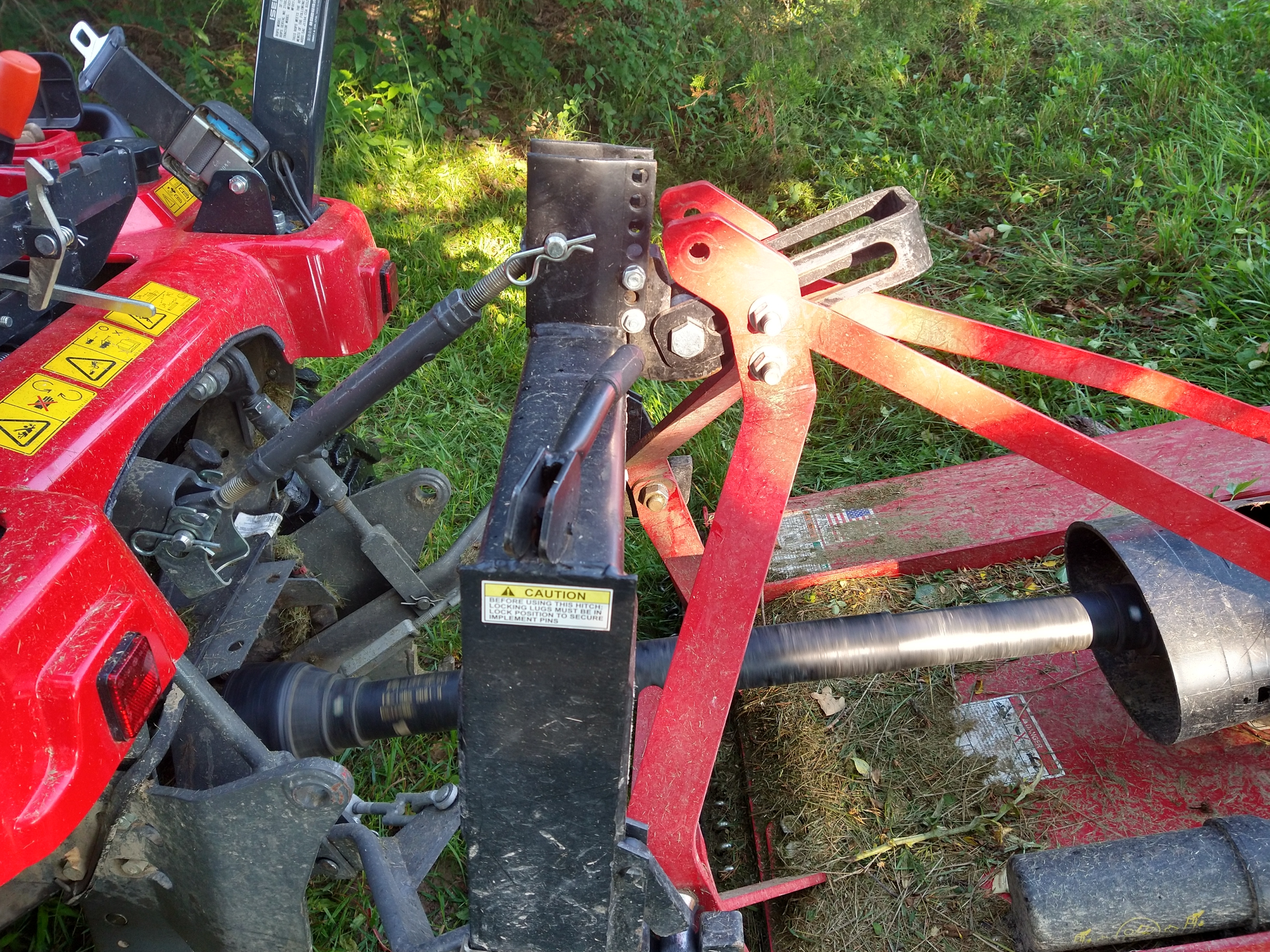

Good call. Although I went through the setup procedure, I didn't get it completely dialed in. Here's the setup instruction set (kinda weak):
And here are my results...Just as shown and much more flex at the top link:
And this is the off-ground condition:
   / Bent Rotary Cutter Deck - Can it be Fixed? #33
Your second picture with the hook lowered looks better.
