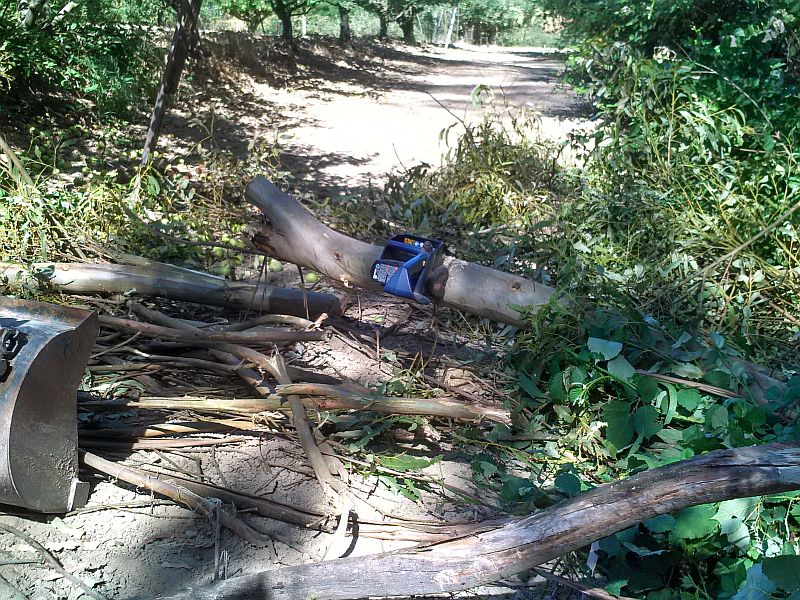

While looking at camp properties yesterday, at found one that the owner was at, and his son invited us on a few miles of "adventure ride" to a bridge his son wanted to see. He said he'd rode it last fall but the logging road was now grown over and dead falls across we couldn't drive around. It really was an adventure ride! We came to one that was to large and gnarly to remove so we got our little battery saw out and had it off in minutes. Ended up cutting 4 off but most we could drive over or around. Sure was nice to have this saw and some extra batteries along.

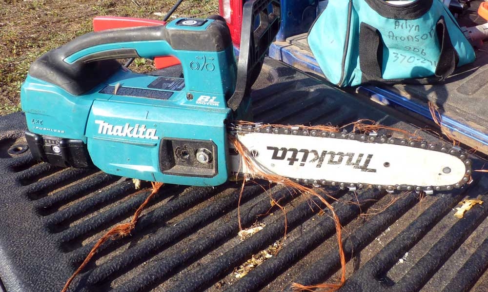

I NEED one of these as a second for the Makita 10 inch .
I just bought one of those little top handle "Clown Saws". for $100.
I used the electric saw while "up the tree" on spikes ,seat and flip line. The battery ran down before I did, (and I'm OLD!)
The $100 gas saw did 5 times the cuts on the ground during clean up on one fuel fill.
Both need bar oil.
Both have a place
