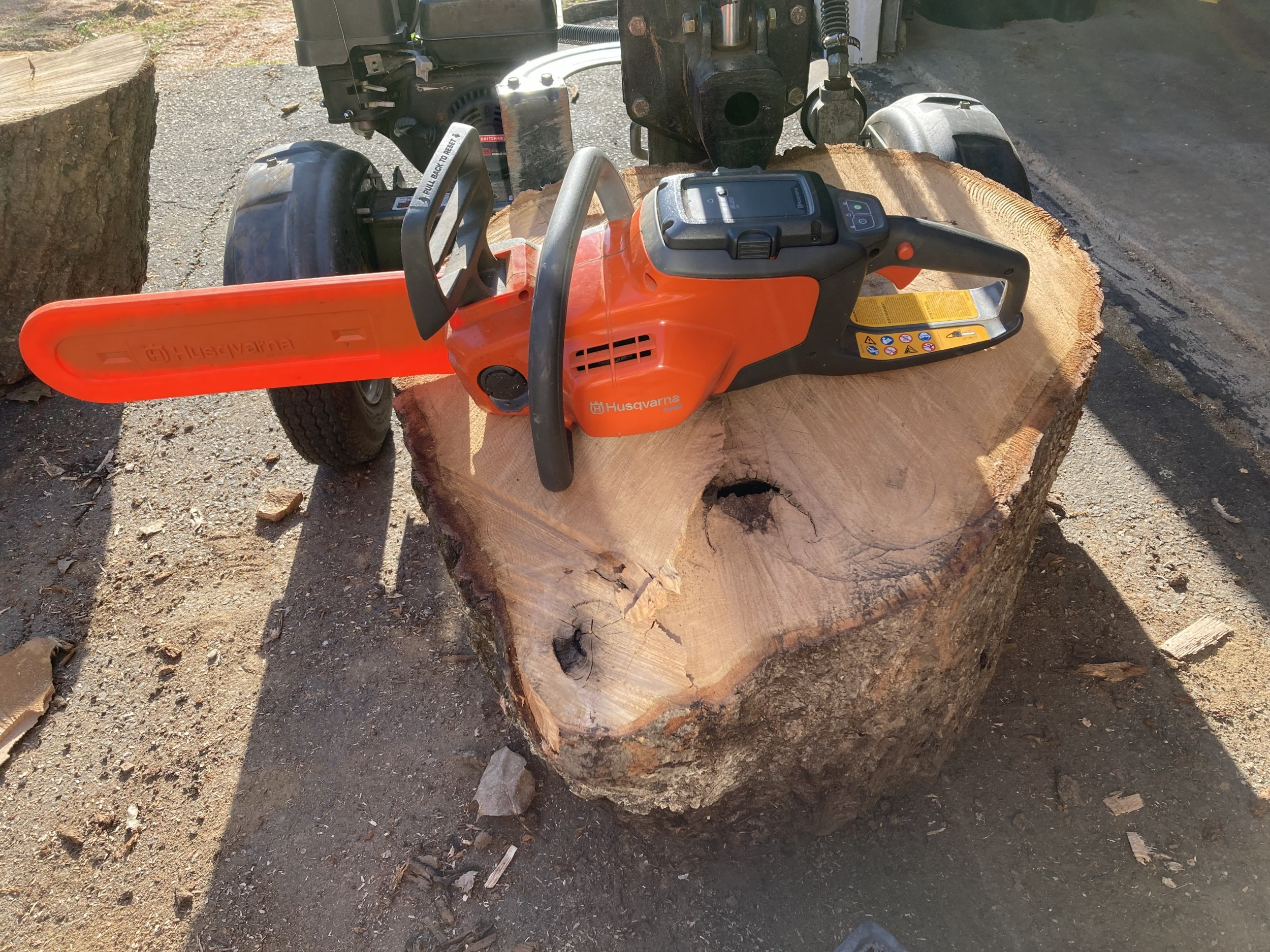

I have been considering one of those. Mainly for convenience. Convenience includes not needing too much redundancy at increased expense.
After two saws, 6 batteries and a charger maybe another brand like Stihl might work out just as efficiently, as long as you don’t NEED to have two people using the saws at the exact same time.
No sure what you are getting at. The batterys didn't work out? The saws didn't work well?

Arly... I am curious as to what electrical provider you have and how much your rates have increased this last year?
/ Battery powered chainsaw #383
Just gauging the cost of two saws, 6 batteries and a charger you need in order to keep going with the Mikita mini-saws due to the over heating batteries.
Now, if you NEED two saws because you must have two people running saws at the same time I can understand that redundancy. But if ONE saw, two batteries and a charger would do the job you could do it more efficiently with a Stihl even though the initial cost would be higher. Right?
The little makits we use will over heat when cutting larger branches or used at continues times. Nonetheless, I used them for limbing and smaller trees and they haven't overheated on me in some time. I already used Makita cordless tools so extra batteries are a no-brainer.
But you are still carrying a “spare” saw in case one over heats, aren’t you?
I do when using the 6x6 but not when we pack in. When we can, we always bring two saws into the field for safety sake. While packing in, two is not practical.

Just bought my FIL a 60v Greenworks Pro 16" saw. Would have preferred the 80v, but he already has the 60v trimmer, battery and charger. I'll get to try it out next week.
I'm eyeing the 80v myself since I have the 80v tools. Most of my work doesn't require my 40cc Echo

So far zero overheat or stall issues with my Stihl AP battery saw...
I can't say it is the best but I can say it works well and like others once the pain of batteries and charger expense is past it's not that hard to pick up more tools... blower, pole saw, hedge trimmer, etc...

I was just using a Makita XCU10 18V
It kept kicking off in the cut. Annoyingly so, but I was testing it's ability to cut .
After about 10 minutes, the battery (3AH) was spent, and very warm to the touch.
I might have to get one in spite. ;-)
That is the battery saws we use. Project farm guy did test them and I agree with his Makita assessment.
