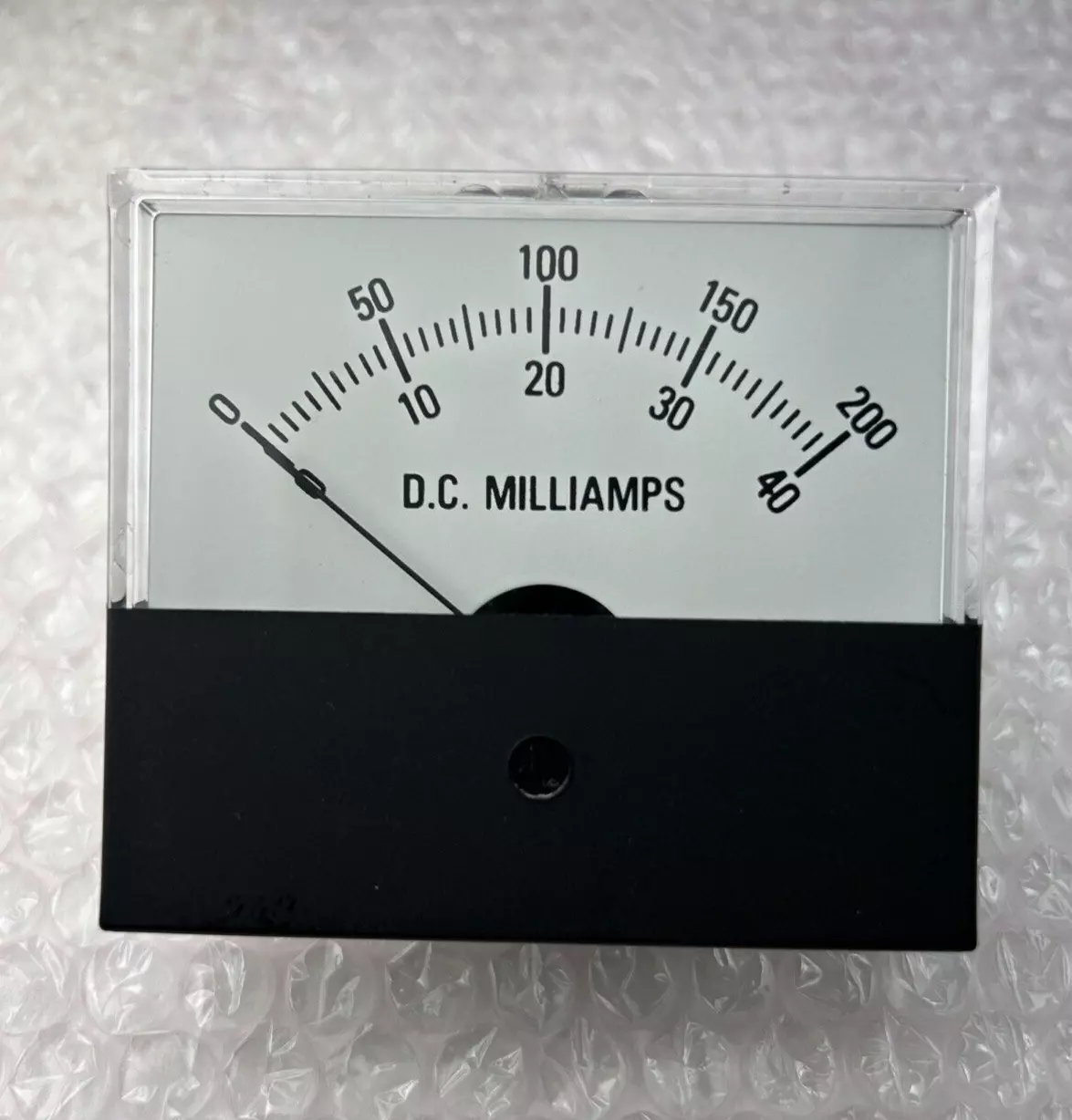

Eddie, I used a borrowed gauge like this to find a parasitic draw on a car battery. It was drawing down 0.26 amps per hour. I then installed a trickle charger, and the problem disappeared. Seems the on-board computers were drawing current. The car could not sit for 5 days without an almost new battery going below its ability to start the car. I put the gauge between the battery terminal and the positive cable. Immediately saw the problem. Does the Massey have any on board computers?
Wow. 260 milliamps seems like a really high parasitic draw. Older cars were typically less than 50 mA. Modern vehicles generally run between 50-85 mA. I'd be checking for a light that's not shutting off or a stuck relay somewhere.

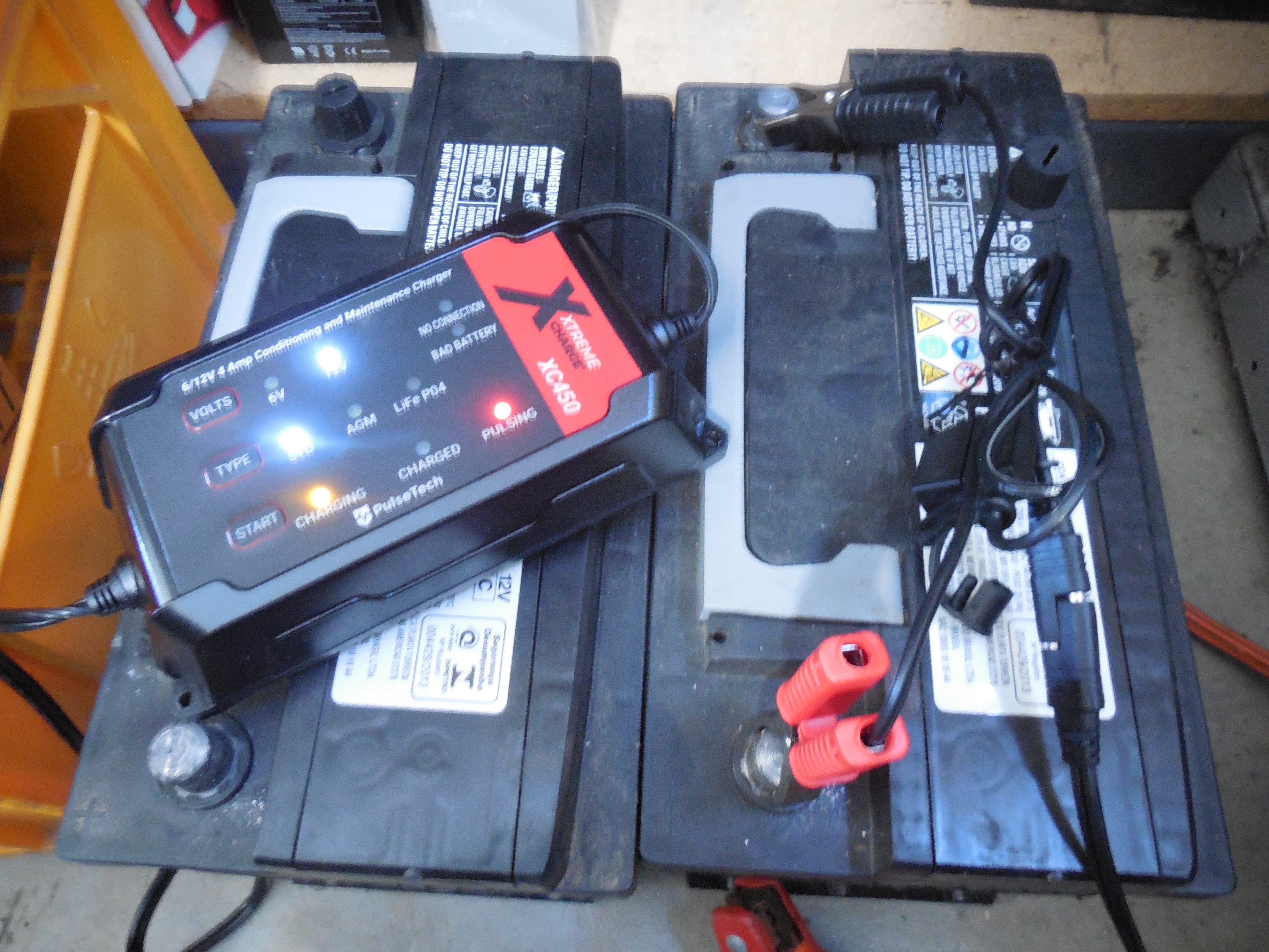

Checked the formerly good battery - a measly 10.9 volts.
Hooked up the latest PulseTech purchase and immediately noticed a faint high pitched noise. Checked the voltage and it was slowly climbing in the 13.2 range. No wild voltage swings, just indications of high frequency at work.
Can this one fix what the NOCO damaged? I sure hope so, but still won't use these two as a pair anytime in the future.
Can this one fix what the NOCO damaged? I sure hope so, but still won't use these two as a pair anytime in the future.View attachment 2105542
so i will say it last time, do what you want. what exactly do you think this high frequency pulse consists of?
high pitch whine actually indicates crappy inductor coil potting, but I'm done, Noco is the number one selling charger on the market, I never even heard of pulsertech before this.
if it works for you great. I'm out.
Fyi voltage almost means nothing. if you had a 10.9v battery (its shot already) and a 4 amp charger already brought it up to 13.2 and it not taking 10 hours, the battery is sulfated and has no capacity. I would love to see the SG and, go take the ah capacity and do the math, its not going to lie.
the noco would have to literally catch on fire to drop its capacity that much. sounds more like a shorted cell.
this now the 3rd battery you posted about having issues. Sorry but it seems your battery situation is in rougher shape than you think. I actually hate lead acid batteries. its why I switch everything I can to lithium
i got less then 10 cycles on a boat trolling motor battery that sat on a float charger its entire life.
