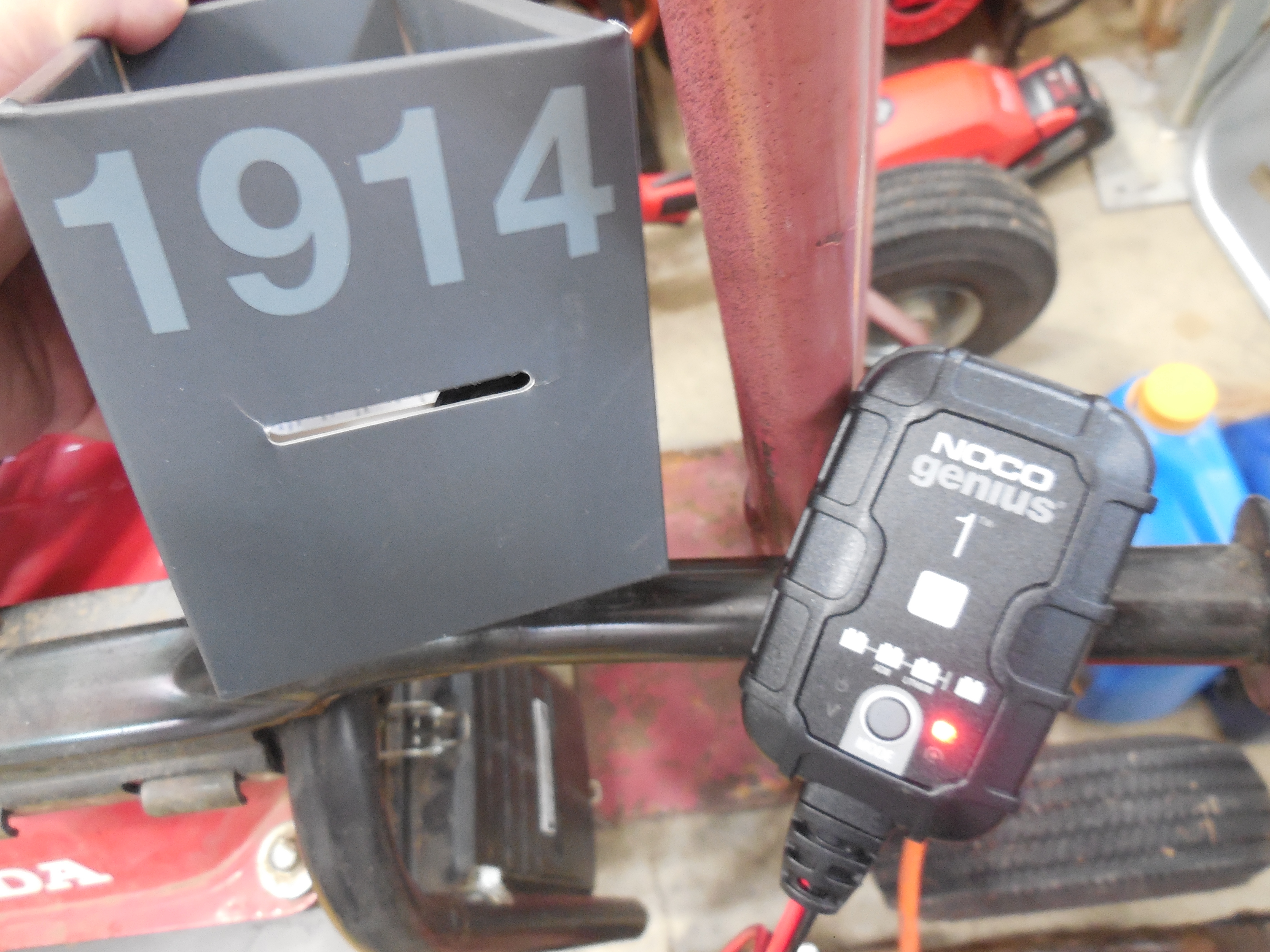

yea that seems pretty off to me. I have never seen that, especially the ability to see it bounce like that. normal meters can't see pulse's. is this the one amp model?
It wasn't a high frequency fluctuation by a long shot, rather about 1.5 to 2 second "waves". Being used to high frequency desulfation but not the high voltage version it was a complete surprise to me.
Noticed it when checking if the little NOCO 1914 was doing anything, and will check again in a little bit. Pretty sure that's a 1-Amp version. It didn't come with any instructions.

I don't know what a 1914 is. the 1 amp is called genius 1, instructions are underneath the cables.
you definitely have something weird going on. 18+v is wrong. If I get my truck fixed today, I may hook up the genius 1 to an oscilloscope and see the range, it really shouldn't be over 15v.

Yes, it's a Genius 1, says 1914 on the box, and there were no instructions. Found them by typing "noco 1914" into Google.

oh, I see it now, yea thats the year the company was founded. has nothing to do with the model of charger
