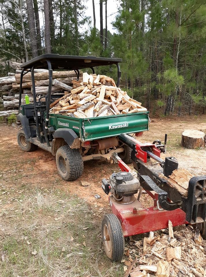

The mule uses a car battery, buy the statement of amp charger is correct
I was assuming Eddie was referring to a Kawasaki Mule, a UTV which uses a 17 Amp-Hour ATV type battery.
In thinking further about this, I know there are Mule gate openers, which I assume use a deep-cycle battery. There are also antique military Mules (M274) - a funky UTV-type vehicle - which were introduced in 1956 and used up in to the 80s.

I have a 2012 kawasaki mule and it has a 550 cca battery on it. Its as large as my truck battery. Did they change these to lawn mower batteries on newer units?

I just mentioned the Mule because it's a vehicle with a battery. Oddly enough, it's a 2010 and I'm still on my second battery. It's never had a trickle charger on it, but it's started up and used just about every day. It sits under a roof, in a shed with three walls.
My mule sits in the garage, and is also used daily. Probably the most used vehicle i own. It was running sluggish so last month I adjusted valves and new plugs and oil. Running good again.
