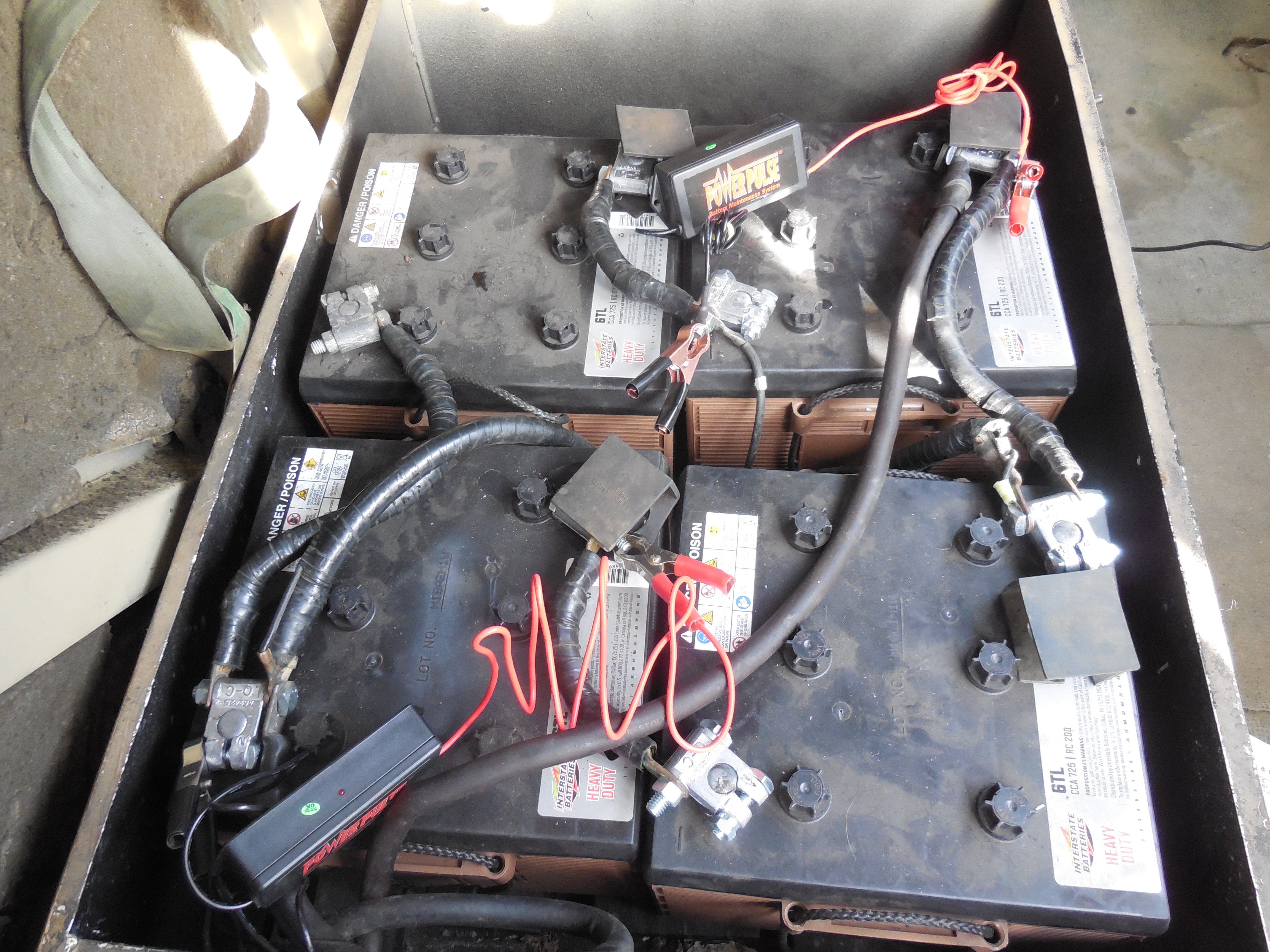

Speaking of battery issues, yesterday I found one that puzzles me.
These batteries have been flawless for about two years, always maintaining a good charge for months. Don't know if it's related, but recently decided to be nice to them and add some water. They didn't need much, some cells none.
Also in the process of rebuilding the power control box for this vehicle, basically a solenoid that provides power when the battery switch is turned on, and one that sends power to the starter's solenoid when activated.
With all systems seemingly good to go, the starter acted like the batteries were low. The voltage was still up there, but when load testing them the upper left and lower right one failed completely. Never had anything like that happen before.
The upper right one is positive in this 24 V system, and the lower left is negative. What I don't understand is why those two, first and last in the chain, are dead while the other two tests perfectly. Yes, stuff happens, but in this case, how?
Put them on a solar charger and with desulfation on the two bad ones. It'll be interesting to see if the specific gravity is still as bad as it was yesterday.
