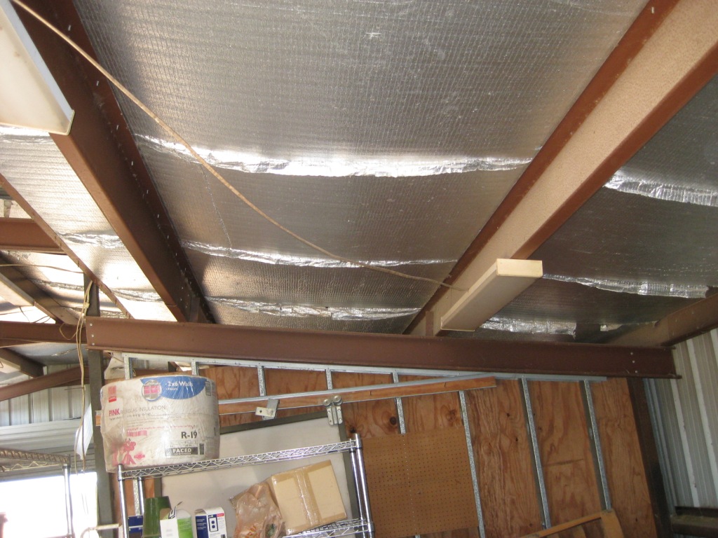

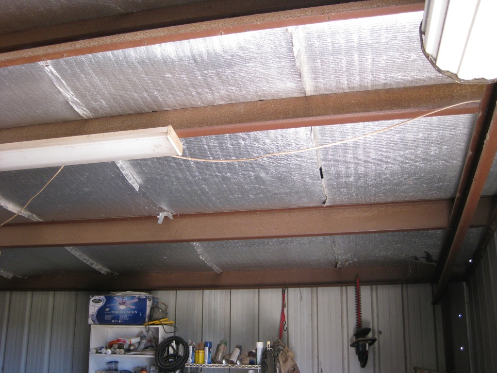

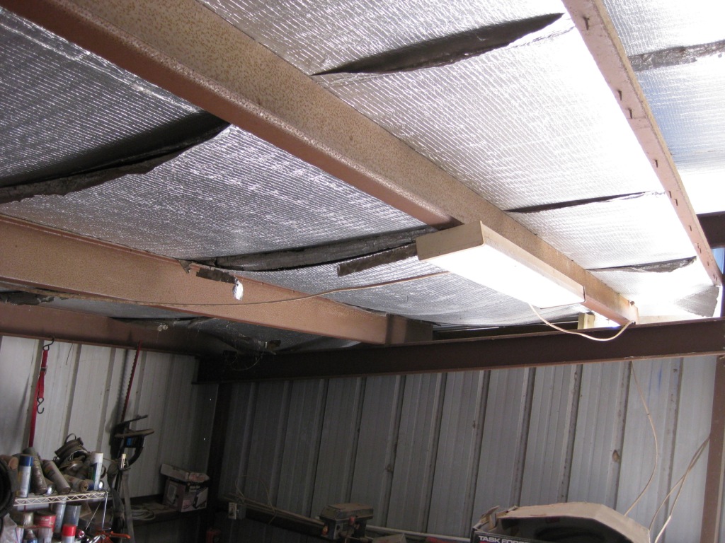

Looking for some feedback/advice.
So, the next project on the list is building my wife a new tack room in the barn.
The current space is approx 19 ft (l) x 12 ft (w) and is used for junk storage. My wife wants it enclosed, sheetrocked on all four walls and ceiling as some work done to delay/prevent the varmints from moving in.
Building the stud walls and hanging the sheetrock is no problem, but I am having trouble deciding on how to handle the ceiling. Because the ceiling is not structural (the shell of the barn will carry the roof load), the ceiling rafters only needs to carry the load of the radiant barrier OSB I am putting up (for insulation value and varmint delay) and the sheetrock.
The standard route would be to run regular rafters on the 12 ft width 16" OC, but even though it is only carrying the ceiling weight, I am thinking I would still need to do 2x6 or 2x8 to prevent deflection. Which I could do, but seems overkill. Also, the back wall is barely 8ft high and I would like to maintain as much headroom as possible.
Alternatively, I could run rafters the length of the room (inset between the z-channels), but at 19 ft we are definitely in the 2 x10 range and since the z-channels are only 8" deep, I would have to notch them. Also, my back does not look forward to manhandling 7 or 10 2 x 10 x 20 rafters into position.:(
I had been considering putting 2 x 4 furring strips running the 12 ft width and attaching them at the bottom of the z-channels (the z-channels are every 5 ft). For this option, I am thinking I would need to use bolts (as opposed to lag screws) and recess the heads in the wood (to create a smooth surface for the osb and sheetrock).
Anyone have any other thoughts or recommendations for which options would work best? I am not proud.

I would be tempted to use self tapping screws and just bury the heads in the flat 2x4's. Then fill that void with more insulation, run conduit for your lights along side the 2x4

What about hanging a suspended ceiling 2' x 4' metal grid right off the barn roof and fill the grid with 2' x 4' ceiling tiles?

Put sheetmetal siding on the ceiling. Mouse proof: install straight sheets, then cut edges to fit the overlaps and the edge details.

I go with 2x4 flat ,an perpendicularity to the steal, fason them with carriage bolts( 5/16)24"oc. screw on the top side of 2x4 a second 2x4 making a upside down "T" this will give it plenty of strength. sheet rock, or because its a tack room a wood ceiling made of say "T"111 , the kind that looks like 3" board an baton. (this should be painted before installing to make finishing it off quicker) use 24" insulation.

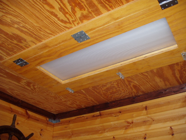

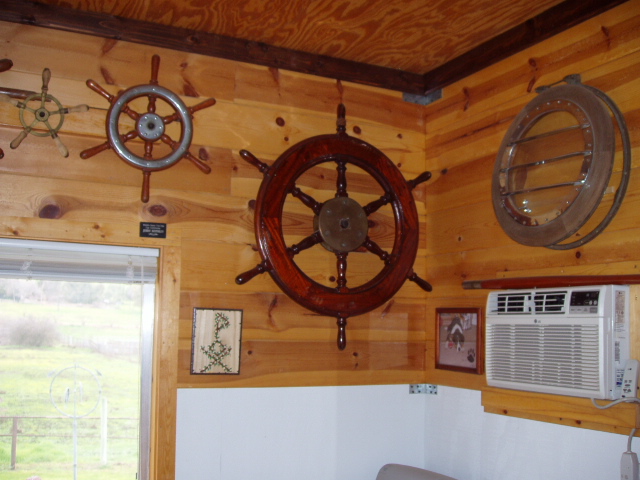

This is my 10'x12'office out in the shop. The rafters are 2x6 16" oc running the 10' direction crown up with 3/8" resawn plywood screwed in place. Walls are 1x8 pine v-rustic and 3/8" resawn plywood painted white. Not the angle brackets in the wall corner as this office is built to be removed (certainly not be me but perhaps the next owner when the time comes) if so desired to make the shop bay a full 32' deep. The existing before the office project overhead light created a challenge as to how to change out the bulbs. The small A/C unit intake draws from the rest of the 1280 sf shop and not from the outside of the building.

I am thinking that you could just attach siding directly to your steel rafters with self tapping screws. Maybe look for the lightest guage steel to minimize weight since it is non structural and out of the weather.
Any tin trim for outside of a barn can readily be used inside. It is very common for pole barns built for commercial applications to go this route.

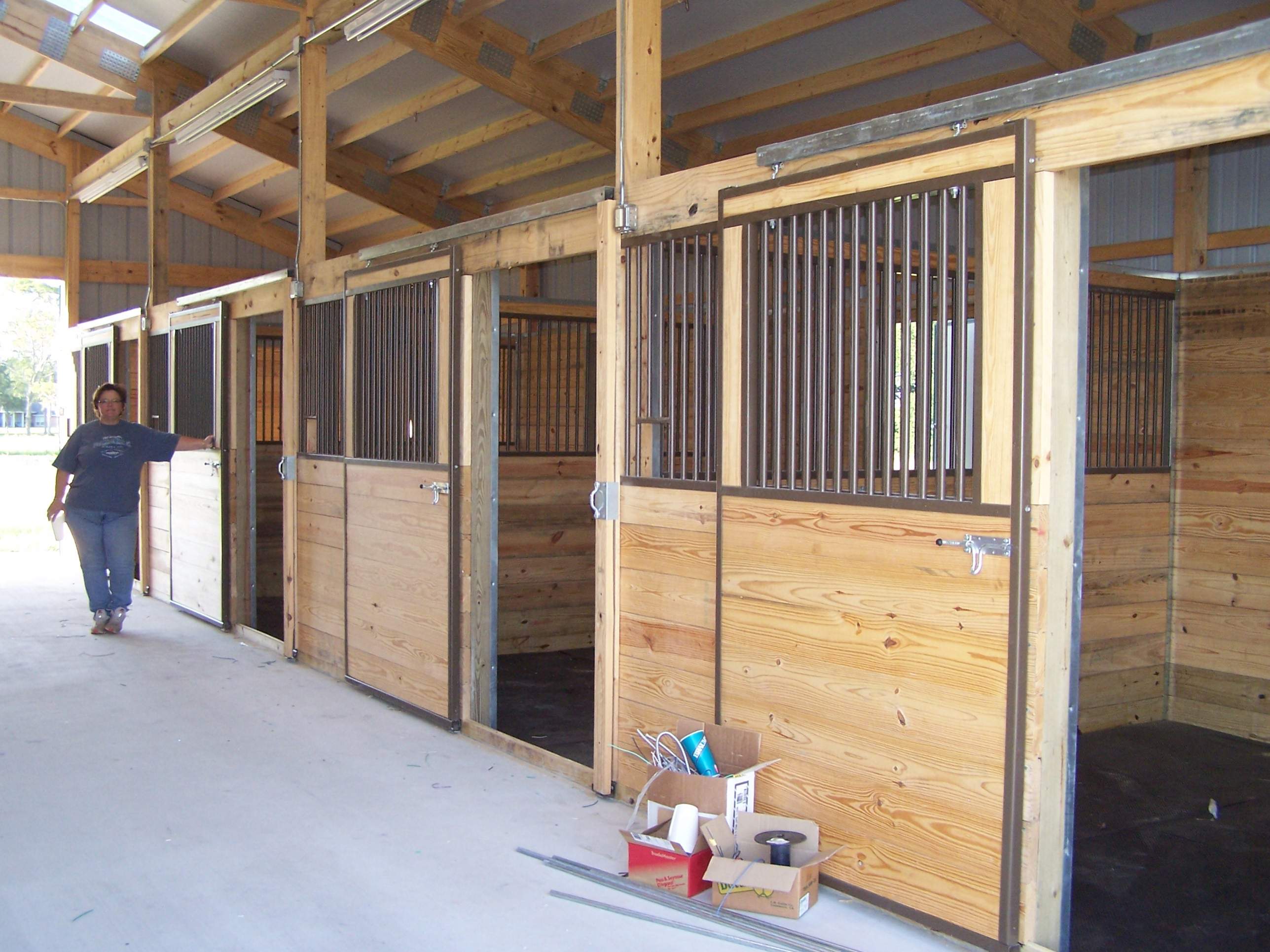

/ Barn Tack Room Ceiling Advice #11
Nice barn Randy. Are you going to seal the wood? Lot of work but it will make cleaning and/or disinfecting super easy in the future over bare wood.
/ Barn Tack Room Ceiling Advice #12
It's hard to tell from the pictures but the bottom 2 boards are treated lumber for ground contact. We discussed sealing the wood and looked at several barns, some sealed and some not. Our mare has allergy issues and we decided not to seal the wood, as the sealant would risk a problem with her and then we would be stuck.
