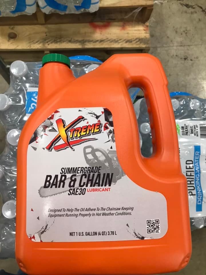

I am sure it was 30w. the stuff would turn into crystal sparkley molasses below about 40 degrees, but nobody has winter blend 10w like now. the poulan pro was thinner at 0 than this stuff was at 40.
I mean which brand. They sell like 5 different brands too. Besides the weight differences.
/ bar oil test #23
I really don't remember. It has been too many years. But the stuff looked like the Stihl oil in the Project Farm test at the 10:45 mark when cooled to 10 degrees when it was poured from the jug It poured slowly and had a crystallized shimmer to the oil when poured, I probably replaced 50 oil pumps in poulan and Poulan Pro saws because of that stuff.

Something I’ve been doing, not really to improve bar oil, but blending in maybe 20% 30 weight oil. I’m just trying to use up an old quart bottle and didn’t want to throw it out.

My criteria is it flows and sticks. If it doesn't I finish using and won't buy it again.
I'll buy whatever is cheap and stock up on it. Right now I'm sitting on about 10 gallons of TSC's Countyline, some Mystik which I wish there was a Runnings near me, and Walmart's Black Max(found in the garden section and cheaper than Supertech in the auto lube section). If I find a deal on the boutique flavors, I'll pick that up as well. There was a sale a few months ago on Husky quarts that brought the price per galling down to cheap oil prices.
It all works fine no matter 70s or below zero. Seat of the pants feel is the Mystik flows better and sticks to the chain better than whatever else I've used, but not enough for the four hour round trip to a store that sells it.
My bar oil bottles also become home to orphan lubricants. My last gallon of Countyline swallows up a half quart of ATF, some 20 weight oil, some drops of gear oil, and a bit of 30weight left over from a snowblower oil change.
I'll keep the oiler turned up in my saws. Flipping the bar over every time I finish up a chain or do a deep cleaning helps even out wear as well.
If I get super bored one of these years, I'll price out gallons of straight 30W and then some sort of tackifier like engine assembly lube or STP Oil Treatment. Maybe like a quarter bottle of STP would be enough? I probably won't get that bored.
*all pre coffee nonsensical ramblings. BL I treat my bar oil supply like ammo. Buy it cheap and stack it deep.
