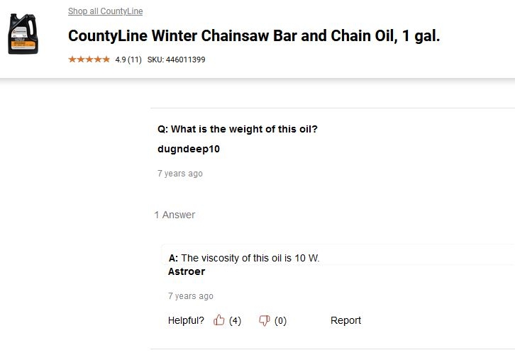

Around here they often sell 3 different grades of bar oil
winter blend
summer blend
year round blend
i usually buy year round blend
was cutting one cold winter day with a guy using summer blend and it poured out of the bottle VERY slowly.
