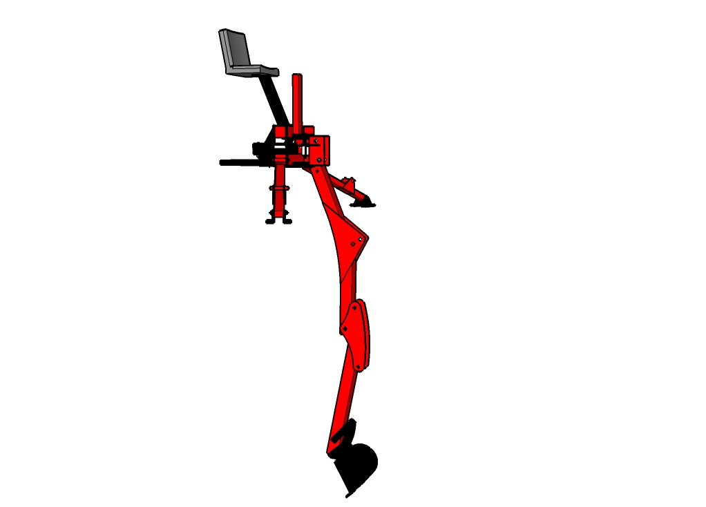

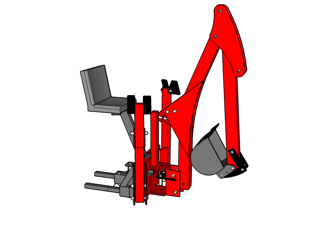

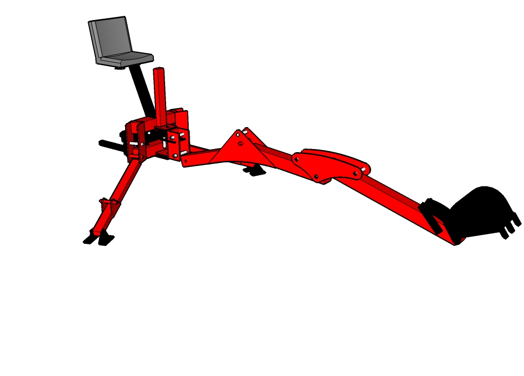

Now I'm on to metal questions. I thought I'd asked this earlier, but I don't find it in reviewing the thread: What wall thickness is needed on the 4" X 4" main boom and dipper? My steel supplier has up to 1/4" wall. Do I really need it that thick?
Also, who are some good online or mail order sources for DOM tubing and short cuts? I know it's been discussed before, but please humor my laziness and post a few links or some contact info. My steel supplier says that he can get the DOM tubing, but he has to special order it and it takes a while. In short he didn't seem to excited to supply it.

Thanks for the reply. I know I'm going to have to go mail order for the DOM tubing and for the brass shims. I may just go that route for the whole deal. I'll run some numbers and see what will work best.
There don't seem to be too many opinions about the wall thickness of the 4X4 tubing. I will probably just go with 1/4" to be sure.
