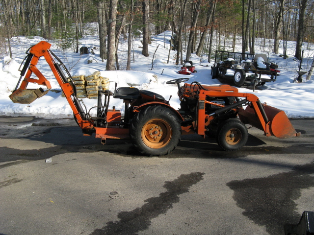

The b670 on my b7100 runs off a pto pump... pretty sure it is in the 4-5 gpm range and I run it about mid-rpm's any more than that (or if you try using as different pto speed) and it tends to make the hoe slam around a bit.
My front end loader runs off a similar sized pump on the front pto.
It definitely is a little slow when trying to scrape a flat bottom but most of the time you are using bucket curl with a little crowd to remove max dirt and speed is fine. I would like stronger swing cylinders and in fact I just repacked them so we will see how much of a difference that makes. All the cylinders are in the 2.0 to 2.5 range.
The shorter the reach the more often you have to re-position when trenching. A 5' trench with my 6' hoe would be pretty slow going with lots of repositioning.
I believe I have posted various pics of my hoe so if you search through my posts you should be able to find them.
If your ever in the Boise area and want to dig some holes to get a feel for this size hoe let me know ;)

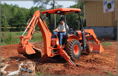

The curved boom is now the standard. Its advantages include digging deeper and closer to the machine, more compact, stronger, and better aesthetics. :)
Yes, curved is now the standard. The Kioti KB2475 is a much improved
hoe, in every way EXCEPT for the forces it delivers (and the price I am sure).
The new hoe is now beefier and offers seat-accessible transport locks for the
boom AND the outriggers. TYM has the same hoe, but it does not deliver
greater dipper digging forces over the old KB2375.
I like the look of the curved boom. If it's becoming the new standard, I guess that the benefits are generally outweighing and drawbacks.
