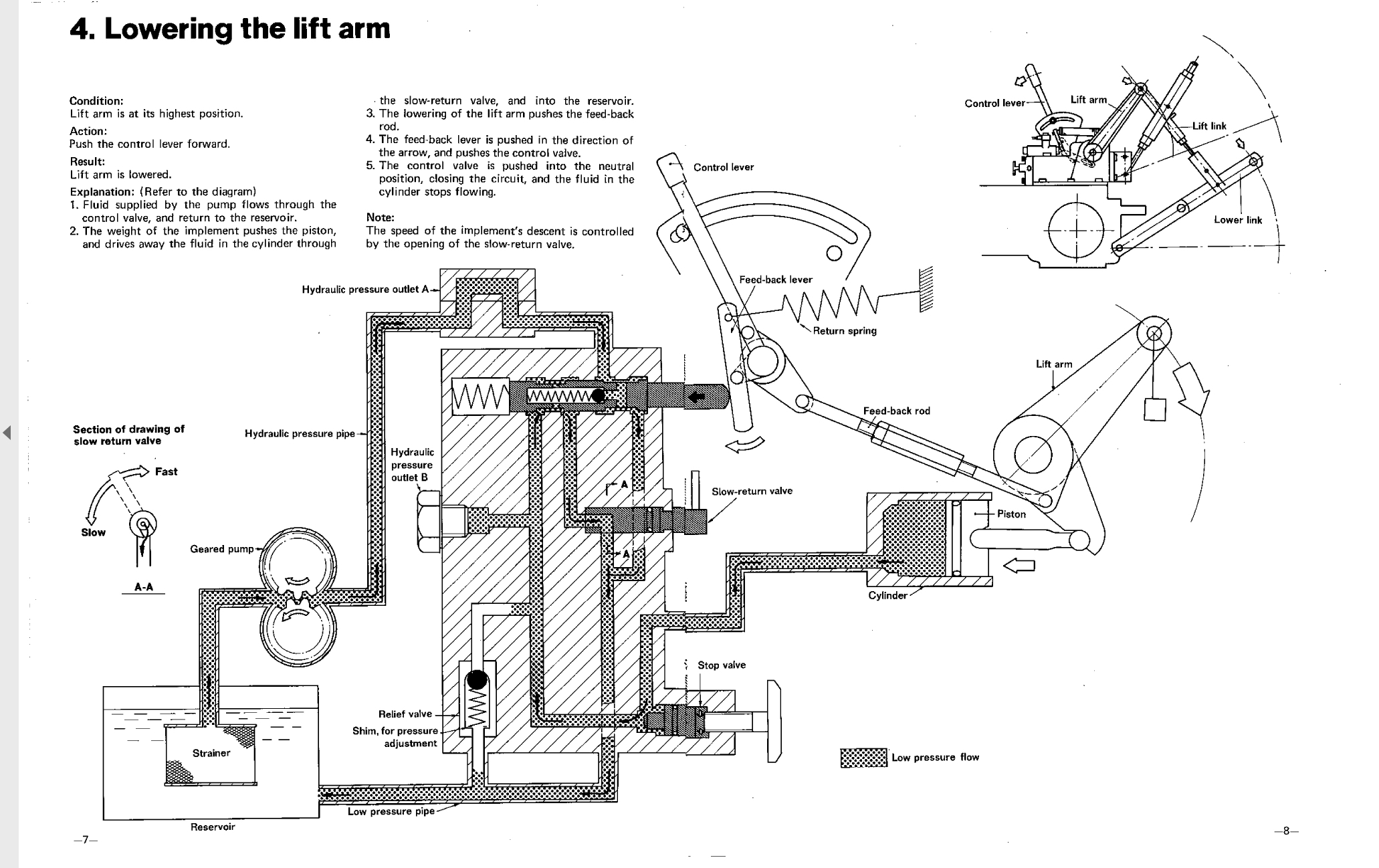

This valve under the seat I believe locks the 3 pt so it won't move ? Should I use that

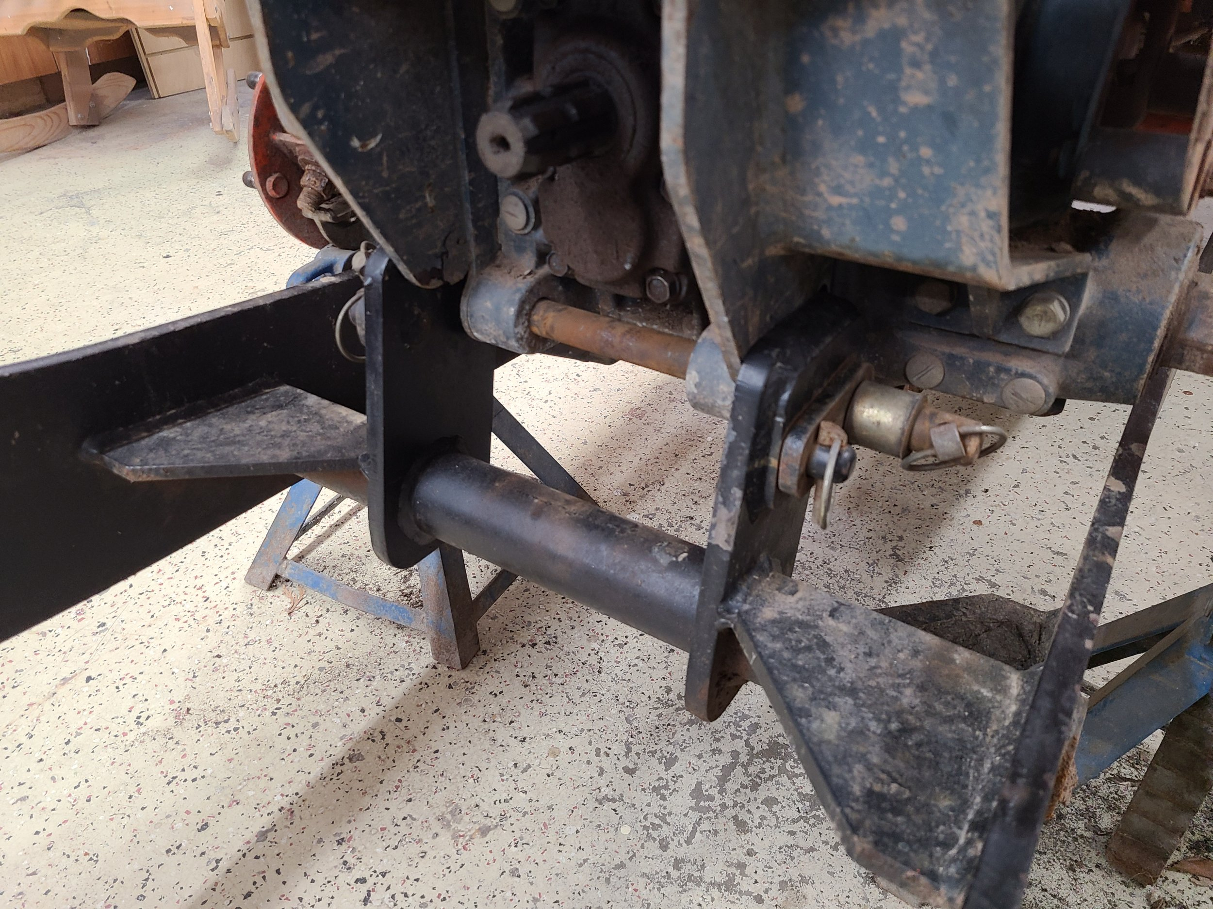

I ran out of welding gas so I can't complete the front bracket just yet but the rear hooked up rather easy. I had to take the hitch off though. My only concern is I had to remove a bolt on each side to get the frame to slide on. Deciding if I want to remove the frame and grind that section away to get the bolts in ?
No. Leave that valve as it is. It is the "stop/lock valve", a needle valve to "fluid lock" movement of the 3pt piston.
Which way do you move the 3pt control lever to lower an implement? Move the lever all the way in that direction and leave it there.
And please get yourself some hydraulic flow diagrams and study up. Most service manuals have several chapters on the hydraulic system.
3pt systems haven't changed much since they were invented. To get you started, here are some views of the 3pt on an old Yanmar. It's about as basic as they come. Most Service manuals have better views than this. But if you can follow this, you can follow them. .
I'd remove just enough metal to get the bolts to slide in for now. It won't clamp all that well with half a washer worth of compressive force missing, but you want what you can get. Looks like it will probably need longer bolts, too. Metrics will fit tighter in the hole.
Then when you get acet. gas you can weld on an extention to that ear that will cover the hole and drill new holes in the extention.

I don't think the missing bolt is intended to be part of securing the subframe so i would just notch out that part of the bracket that is interfering with the bolt. My .02.
