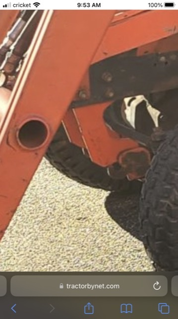

Put a pipe thru the front loader round cross member and add weights on the left and right ends. You can find barbell sets on CL locally for cheap or maybe free!
But this would limit the loader lift capacity, so the only other option is to add weights to the L-R loader frame on the sides and front - drill or weld bolts on the loader frame.
Be careful though, the front axle and seals etc. may not like all that weight.

How much do you like your ground clearance? Id bet money the width of the front ‘frame horns’ is the same as my old b7100 which fits 3x 55lb suitcase weights on the front of the frame. Your loader wont clear that hanging off the front of the frame but you might be able to fit some weight right below the front of the frame where the front of your loader subframe is.

How would you guys add weight to the front of the B1550 without utilizing the loader....need that free
I would not use the backhoe without the front end loader (FEL). When using the backhoe it is recommended to slightly raise the front wheels off the ground with the FEL to keep the loads off the front wheels, axle, pivots and associated linkages. Most backhoes connect to the frame to the FEL mount so that these loads are transferred through the frame.
Just something to consider.

I'm thinking maybe a cement block hanging off the bar where the suit case weights would go, this I can use the FEL
/ Backhoe attachment #76
I wouldnt mess with less than 100lbs but would aim for the 200-400lb region. If you dont have power steering i would stay closer to 200. My .02
