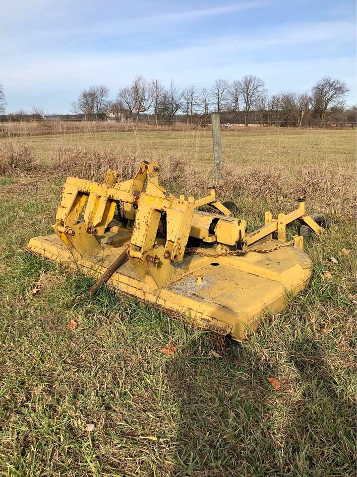

here are some ideas I have saved for rotary cutter offsets.
They look easy enough to fab, and they do not permanently alter the implement.
/ Offsetting a 3point attachment?
Actually the adapter for the bushog looks pretty effective. I'd say that might be along the lines of what I need. Wonder if that' a do it yourself or factory?

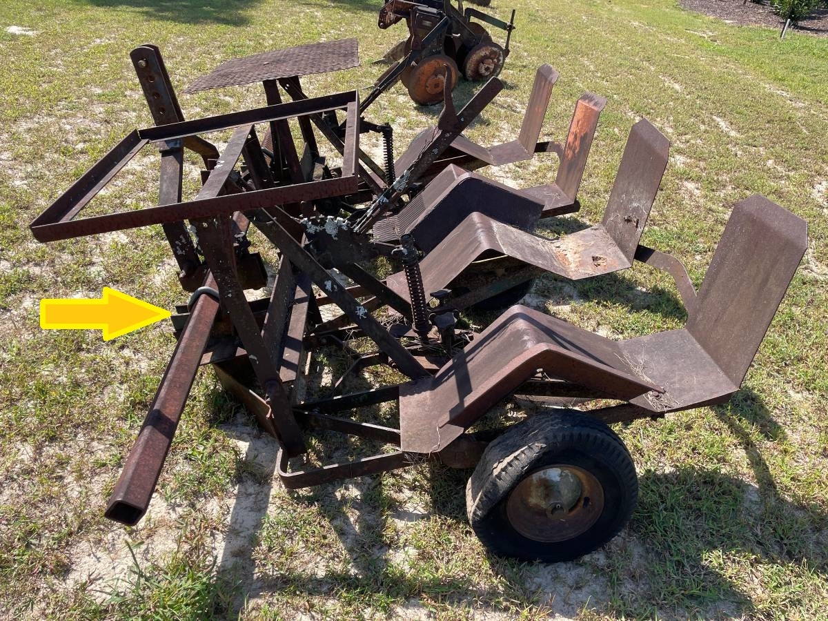

DJ54 this is the planter we have:
This is the digger we have. The digger is offset by design to the side,so it can be used o 36" rows.
The planter is pretty much same overall function as yours. Chain cups and all. Even has a platform on the back for riding, even though it has a plate that says no riding while moving! LOL.
Both of those units are Polish built and dad paid pretty good money for them. I just wish he had consulted me on the planter first.
