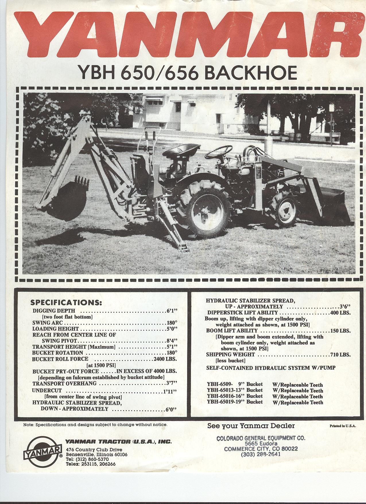

Sure there are. The old 3pt backhoes are not as well known these days....and they are not as good, safe, or powerful as the frame-mounted ones - but in the 1980s they used to be real common and are still available used.
I don't know if new ones are sold now, but the older 3pt hoes still exist and can do a lot of work. The 3pt hoes were stronger than the tractors they were mounted on, so you have to be careful not to break the 3pt attachment points, lift arms, or the frame of the tractor ....or yourself.... because even the little 3pt hoes can throw a small tractor around.
PLEASE DO NOT USE A 3PT HOE IF YOUR TRACTOR HAS AUTOMATIC DRAFT CONTROL ON THE 3PT TOP LINK. THE COMBINATION IS JUST WAY TOO DANGEROUS.
But most small tractors do not have that ADC feature. Automatic Draft Control is usually found in Ag tractors 30/40 hp and up. It's handy for plowing.
We had one of those little 3pt hoes on a little Yanmar tractor smaller than your Mahindra - and did all our barnyard digging for 20 years with it. The whole rig would fit into small areas where nothing else would. Not real fast, and limited to about a six foot depth and reach. But the small bucket gave it impressive power even in rocky, root-filled dirt. I don't recall power ever being a problem.
I figure it worked at about the same rate as a couple of strong guys with shovels, pics, and prybars who worked hard & never get tired....
I recommend that you get one that has the PTO-powered self contained pump and reservoir instead of using the tractor hydraulics. Several reasons for that , which we can go into if you are interested.
I've got some old info on several models - here's a typical example of what you are looking for. Has self-contained pump. Price for a decent used small 3pt backhoe seems to be in the 900/1100 dollar range here.
